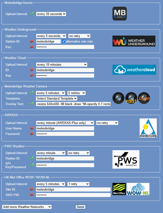

I have another issue with the new "VM" version. When third-party weather networks are added, they revert to default credentials the following day. This past Saturday, I programmed 4 - 5 additional third-party sites, all verified as functioning. On Monday morning, I received email notices from several of the networks that they stopped receiving data; on viewing the "Weather Network" tab, I found that almost all network credentials had changed to "Meteobridge" along with some unknown password. I corrected all the errors and had everything back online and verified by Monday afternoon.
Tuesday morning: All of the 3rd-party websites have again reverted to default credentials (See below). Help!

Ive just re-added all my weather sites for the 5th time today.
After I close the browser and logout, the website's site IDs, keys, etc revert back to defaults.
Need an answer soon, I'm already getting nastygrams from several of the sites

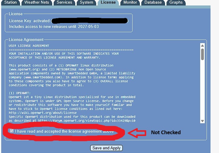

I found the bug; it was between my ears.
I checked all the Chrono and ProxMox related settings, flushed the cache, swapped browsers, etc...
Then I found the problem. I reloaded Meteobridge last Friday, everything reinstalled smoothly, and the license file was auto-loaded.
This afternoon, while re-checking all the Metebridge settings, I found that I never "checked" the checkbox accepting the license conditions. Apparently, without the checkmark, Meteobridge blocks adding any weather websites. Websites that are already configured are reset to a default username and password. Since checking the 'checkbox', I haven't had any problems. My apologies for wasting your time.
Brian, AA5H
