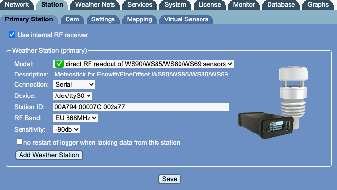

Let me show operation with an example.
There are 3 sensors defined
  • #0 00a794 (WS90)
  • #1 00007c (WS69)
  • #2 002a77 (WS85)

The log file shows that all three are detected and delivering data:
logger (18.06.2025 20:30:53): station 0 (Meteostick WS90/WS85/WS80/WS69), channel 0 bound to sensor ID: 00a794
logger (18.06.2025 20:30:53): station 0 (Meteostick WS90/WS85/WS80/WS69), channel 1 bound to sensor ID: 00007c
logger (18.06.2025 20:30:53): station 0 (Meteostick WS90/WS85/WS80/WS69), channel 2 bound to sensor ID: 002a77
logger (18.06.2025 20:30:53): station 0 (Meteostick WS90/WS85/WS80/WS69), debug off
logger (18.06.2025 20:30:53): station 0 (Meteostick WS90/WS85/WS80/WS69), verbose off
logger (18.06.2025 20:30:53): station 0 (Meteostick WS90/WS85/WS80/WS69), output raw
logger (18.06.2025 20:30:53): station 0 (Meteostick WS90/WS85/WS80/WS69), rx threshold set to -90db
logger (18.06.2025 20:30:53): station 0 (Meteostick WS90/WS85/WS80/WS69), frequency band 868MHz (EU) WS90/WS85/WS80/WS69
logger (18.06.2025 20:30:59): station 0 (Meteostick WS90/WS85/WS80/WS69), channel 2 WS85 firmware version: 107
logger (18.06.2025 20:31:00): station 0 (Meteostick WS90/WS85/WS80/WS69), channel 0 WS90 firmware version: 156

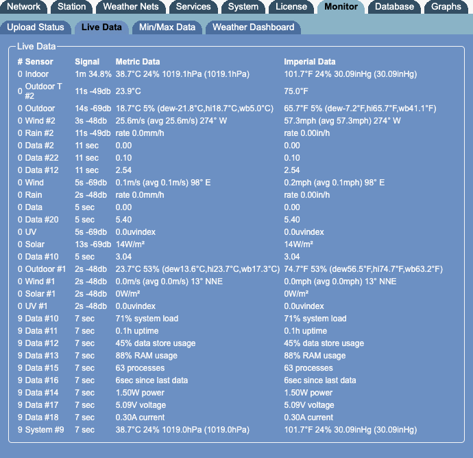

On "Live Data" tab we see data coming in as follows:
Bildschirmfoto 2025-06-18 um 20.34.36.png (150.92 KiB) Viewed 7603 times
  • Sensor #0 WS90: Outdoor (temp/hum), Wind, Rain, UV, Solar, Data (rainflag), Data#10 (battery voltage), Data#20 (supercap voltage)
  • Sensor #1 WS69: Outdoor#1 (temp/hum), Wind#1, Rain#1, UV#1, Solar#1, Data#1 (rainflag)
  • Sensor #2 WS85: Outdoor T#2 (temp only), Wind#2, Rain#2, Data#2 (rainflag), Data#12 (battery voltage), Data#22 (supercap voltage)
When you want to address a single sensor measurement template variables work as follows:
  • Outdoor temp of Sensor #1 (WS29): "th0!1temp"
  • Rainflag of Sensor #2 (WS85): "data0!2num"
  • Wind speed of Sensor #1: "wind0!1wind"
Preceding "0" before the "!" indicates that this is data from the primary station, as Meteobridge can be connected to more stations via USB etc which will then be enumerated before the "!". As you see, Meteobridge can really handle tons of sensors from many weather stations from different vendors in parallel.
Station #9 is collecting system data from the Meteobridge. This station is automatically started and does not need manual configuration.
