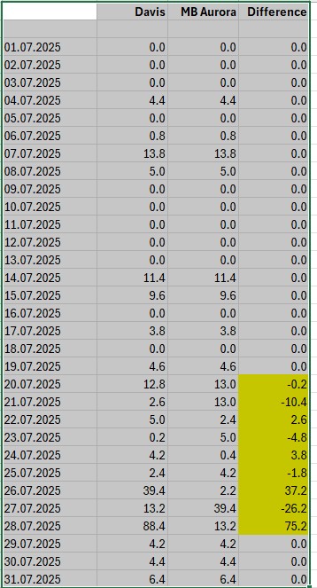

I renovated my Weatherstation in May. New ISS for the Vantage Pro and Weatherlink Live instead of the old IP-interface .
The displays from Davis (especially the one's to share on the web) are not that fancy, so I also got a small Metreo Bridge: Aurora is great!
Upload to other wether serverices is also much better.
July was very wet here. MB Aurora showed the data acuartely and also summed up the month correctly, but the graphics were partially wrong.
I downloaded the MB Aurora Archive data form July. After changing the csv to xls I had to find out which culumn shows what data (adding labels would help!). Then I compared the data with the same from Davis:
Whats wrong here in Aurora?

Hi, it has been shifted by one day due to a bug. Current data should be fine again.

It seems July, 21st was recorded twice, up till July, 27th all is shifted by one day and July, 28th is missing entierly.
That's a pitty, as we had a record rainfall of 88.4mm that day, more than 70mm of it within 3 hours.
Thats unusual for my region in Switzerland
My neighbour had a landslide that day.
Starting July, 29th all is ok again.
Only last month summary is at 0 - maybe also result of the bug
