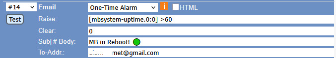

I was asked by one of the users to add a function that allows triggering a service each time the Meteobridge reboots. After thinking a bit about this reasonable request I realized, that this can already be done. Example below sends an email 60 seconds after reboot of the Meteobridge.
Meteobridge variable "mbsystem-uptime" reports uptime in seconds. Once this is above 60 the alarm trigger is raised and the action started. As the alarm trigger gets never cleared (clear condition always evaluates to zero) no second invocation of the alarm is done.

Hi, I'm trying this template but it doesn't return anything when I perform the test after a reboot.
Any help would be appreciated. If [mbsystem-uptime.0:0] >60 isn't right, please let me know.
Thanks!

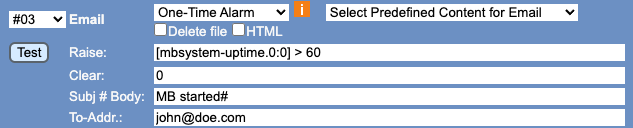

Hi, I'm testing it with an MR3020 v3 and an RPi 3B+ configured this way.
Raise: [mbsystem-uptime] > 120
Clear: 0
But it doesn't work.

Now it works! with:
Raise: ([mbsystem-uptime.0:0] > 60)
Clear: 0
I don't understand what I was doing wrong

Operation of user-defined events is blocked for a while until main sensor date (wind, rain, outdoor temp is there. You can read in System - Logging if Meteobridge is still waiting for sensor data. This might delay doing the event trigger a bit. However, the round brackets should not have any impact here.

Hi, without the brackets, it works correctly. If you set the value to 60 seconds, it sends two alerts; if you set the value to 120 seconds: it sends only one alert.
I left it like this.
[mbsystem-uptime.0:0] >120
