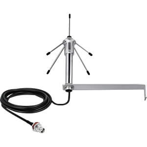

Instead of exposing the MB Pro2 to the outdoors, the better option I see would be using an external antenna. The 2 antennas on the back (one for WLAN and one for the reception of the RF- signal from your Davis ISS-station.
I had similar problems, and solved it by using a 433 mhz ground plane antenna If you use Google you'll easily find one. I purchased at an online electronics-shop. The connection was 'plug and play', just unscrew the MBpro 2's RF- antenna and screw in the external antenna. The cable is thin and flexible. As the connector is small, a hole of 8 mm in the wall is all it takes. The antenna cost me around €40,00
This way you can have your MBpro 2 safe and warm indoors

fotogw wrote: Wed Aug 27, 2025 5:02 pm Hi Alex,
This way you can have your MBpro 2 safe and warm indoors![]()
Can I put the antenna on the floor instead to the wall?
Re: Place of meteobridge pro 2
How well did that work considering the MBPro2 Davis RF is 900 mHZ?.... I had similar problems, and solved it by using a 433 mhz ground plane antenna...

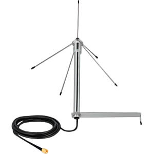

It works fine in my situation. I'm no antenna expert, but it did the trick!Mattk wrote: Wed Aug 27, 2025 9:56 pmHow well did that work considering the MBPro2 Davis RF is 900 mHZ?.... I had similar problems, and solved it by using a 433 mhz ground plane antenna...
I was told the 433 mhz antenna was 1/4th wavelength, and the same for 900 mhz was 1/2 wavelength, so they would work for both frequencies. But maybe i was not informed correct
By the way, I found the same antenna specifically for 868 mhz on Reichelt's website. Maybe this will be even better. This is however with a different connector, so you would need an adapter for this.
- image.jpeg (5.26 KiB) Viewed 6623 times

Your antenna will work, just not efficiently. Yes, the 900mhz freq is a multiple of the resonant 440mhz freq and will work, but it will be very inefficient. Think of a guitar string, you normally pluck the string at tuned mid point to produce an audible freq, but if you pluck it higher or lower the sound is distorted as the string is not vibrating at its intended resonant point. By the musician tuning the string he is effectively changing the resonant frequency to the desired audible frequency he wants.
Another problem, with antennas and not guitars, is the ground plane. The ground plane, which are the angled elements shown on the discone, act somewhat as a second antenna. Half wave vertical antennas do not require an artificial ground plane, the entire wave can be captured on the different polarities, sort of like a two 120v power sources can be tapped to make a 240v outlet. Quarter wave antennas have to have a ground plane, or a second element to capture the whole wave, your antenna should have two wires inside the metal tube that act as a dipole two element vertical dipole, the second element adds a ground plane that’s tuned for a quarter wave signal at the lower freq; it will capture the higher freq, but the signal phase will be off which significantly lowers the antenna gain.
The reason your antenna works is because the distance between your transmit sensor and your antenna is likely to be relatively short, even a poorly tuned antenna would still be effective at that distance. Your probably losing 70% of the signal, but if you have a direct line of site it will work.

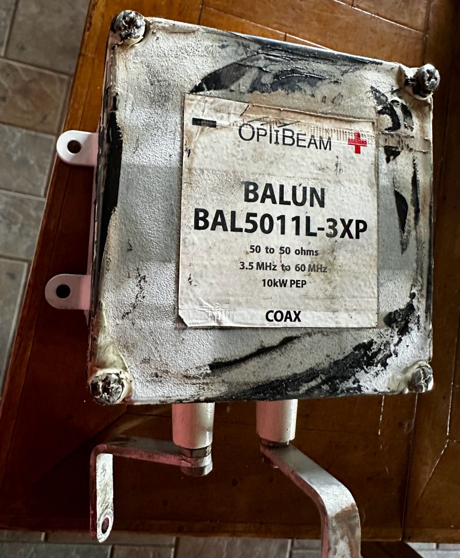

I didn't mention it before, and while it seems like overkill you need a lightning arrestor for any roof mounted antennas no matter how small.
Here is an arrestor that comes complete with grounding cable and uses SMA connections that are common with weatherstation feedlines.
https://www.waveform.com/products/sma-l ... qOEALw_wcB
You don't have to take a direct lightning hit for damage to occur, the below photo is a BALUN transformer on my ham radio antenna feedline; this was surge from a ground strike 30M away. The flash surge melted the plastic case, the tops of the screws were welded shut
https://www.walmart.com/ip/868Mhz-Rfid- ... =101176259

Good point! MB PRO needs to secured from static voltages on the antenna. If not doing so you risk frying the MB PRO. It does not need a thunder strike, pure static voltages on certain weather situations can do that if the antenna is positioned outdoor with some meters of cable going upward.
