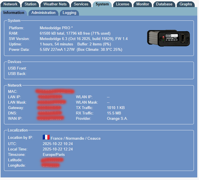

After update firmware from 6.1 to 6.2 my normal functioning MeteoBridge Pro Red changed to a MeteoBridge Pro (black) with the result of no direct connectivity with the sensors of my Davis Vantage Pro station. Tried different setup with station etc., no joy. Revert back to 6.1 no change , stays as Meteobridge Pro. Anybody else noticed this and how to solve the issue?

It has nothing to do with the SW update. I fear the internal USB hub chip might be gone. Can you please share a screen dump of "System - Info" tab to inspect this?

infotab attached!
Database is empty too!!!!!

Not recognizing the internal USB storage which normally displays between RAM & SW Version.
On the Database tab, Maintenance box there is a Database Media option to select either [Internal USB Storage], [USB Stick on front panel] or [USB Stick on back panel]. Plugging a USB stick to front or back panel and changing the respective Database Media: option might show if it's just the internal USB or USB in general issue?
