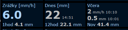

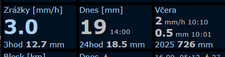

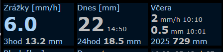

It seems to be addressing a discrepancy on the RPi platform (1.3 / 1.4).
Until an hour ago (between 12:00 - 13:00), it was giving me the exact information, without the last hour (24h minus 1h). Now it's fine ...
PS: I just now noticed that 24h is less than 12h ... :-D
<div class="col">
#if#{*[m]%2=0*}#then#1hod <h4cpu>[rain0total-sum1h.1:--]</h4cpu> mm#else#3hod <h4cpu>[rain0total-sum3h.1:--]</h4cpu> mm#fi#
</div>
<div class="col">
#if#{*[m]%2=0*}#then#12hod <h4cpu>[rain0total-sum12h.1:--]</h4cpu> mm#else#24hod <h4cpu>[rain0total-sum24h.1:--]</h4cpu> mm#fi#
</div>
New reports. Time 14:00 and around 14:51. Note, 24h is still 18.5mm !!!
Time 13:59
Time 13:59
Time 14:00
Time 14:00
Time 14:50
Time 14:50
Time 14:51
Time 14:51
