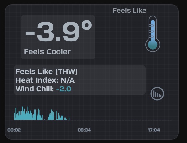

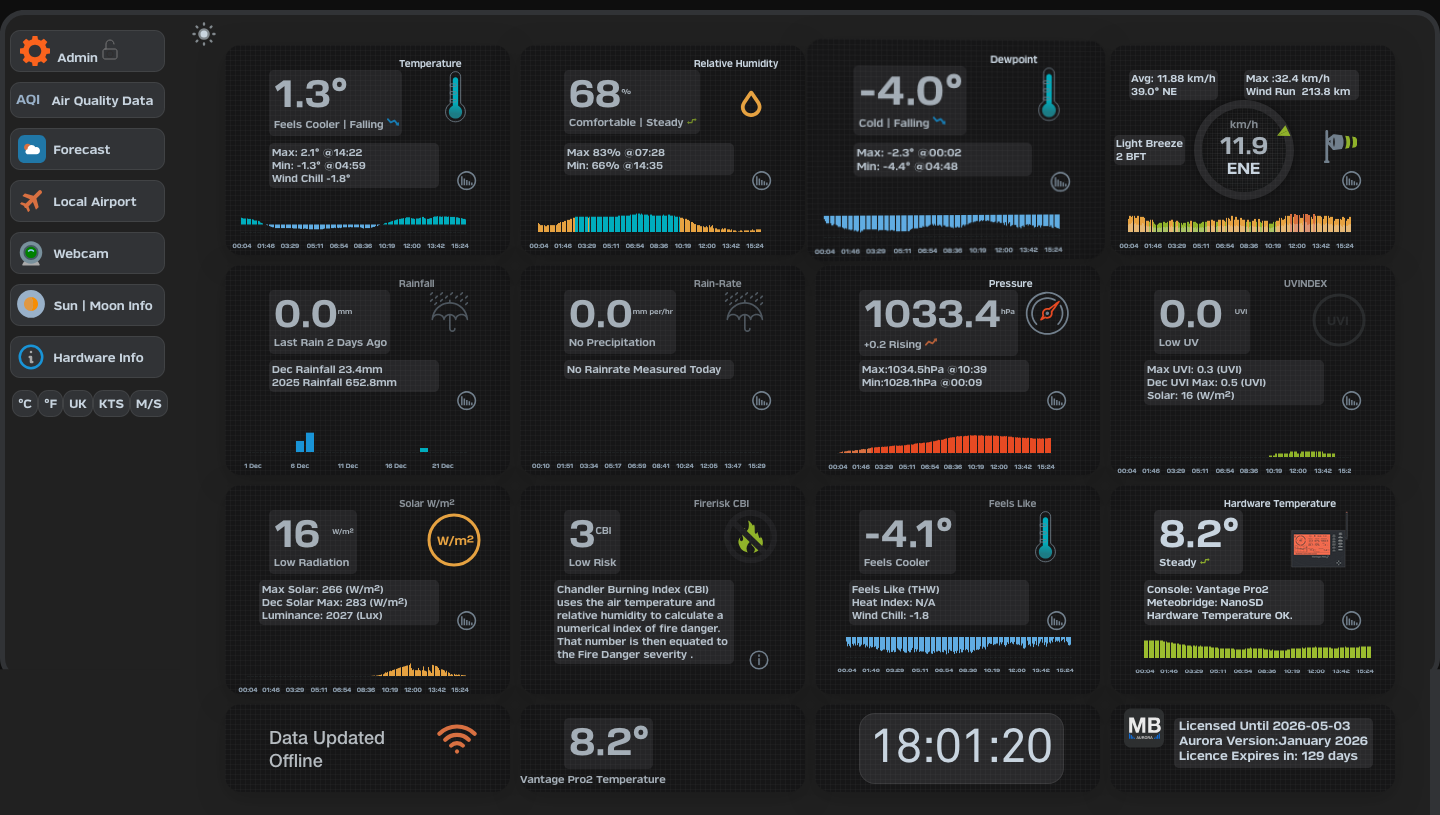

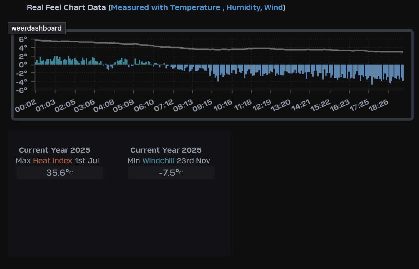

I just noticed a small error in the 'Feels like' module. The graph does not show negative values. The however are shown in the pop out graph. something to put on the list;-)

hello ..

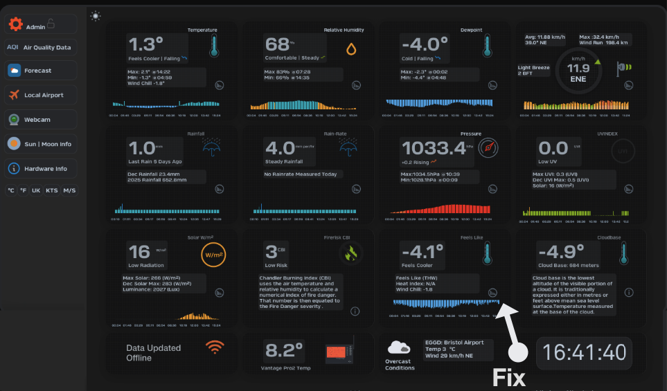

fixed many thanks will add to next update but not sure when that will be ? could possibly just send boris the one file to fix it ? . brian
screenshot of fix
yes, please send me updated file.
admin wrote: Sat Dec 27, 2025 11:25 am yes, please send me updated file.
will do .. brian
sent .. file goes into the weather34charts folder 1 file fix ..
todayrealfeelmodulechart3.php
Update was just installed in the cloud. I hope everything works fine.

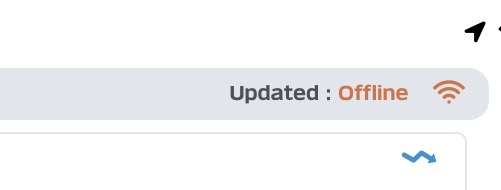

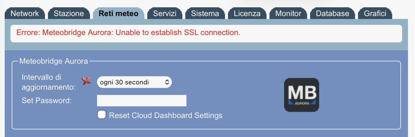

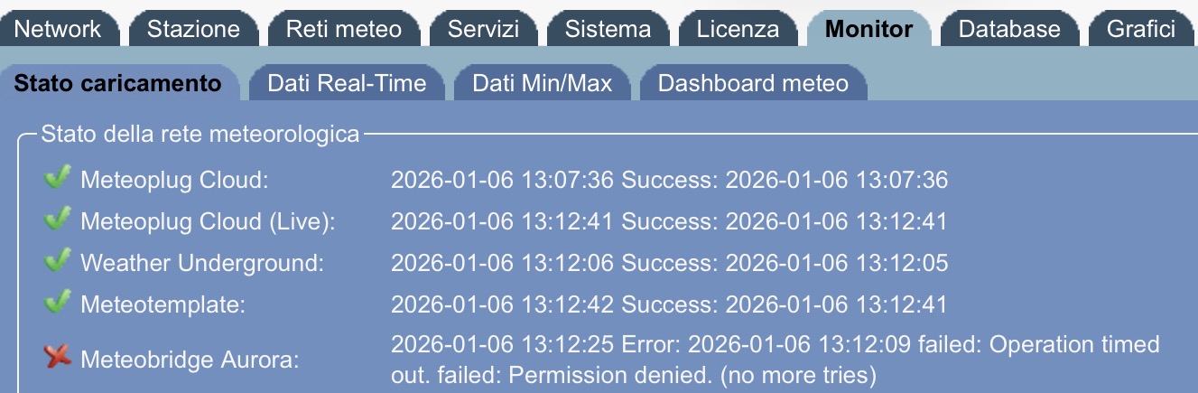

Hello! I have these error messages and weather34 is offline. How can it be solved?
MeteoBorgo: www.meteoborgo.it
lorenz1982 wrote: Tue Jan 06, 2026 2:26 pm Hello! I have these error messages and weather34 is offline. How can it be solved?
Hi
1. check if host has updated PHP ? use phpini if available
2.check file/folder permissions commonly after upgrade folder/files get there permissions changed.
3.try entering the url in the browser the same as the one you setup in the meteobridge API url .see what response you get
brian..

It's Aurora in the cloud.
Actually, it works now without doing anything. It wasn't just my problem; this one also didn't work https://weeropdeveluwe.nl when mine didn't.

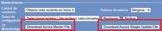

Hello, good morning.
I have a question; my website is this: https://climachivilcoy.com.ar

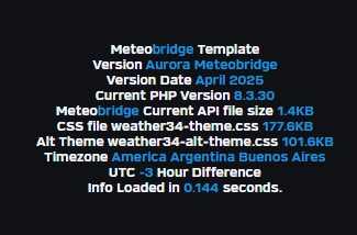

I currently have this version of Aurora (I've attached an image)
How do I update to the latest version ??? :?
Do I have to download the version from Meteobridge...? (image attached)
And another question: I see there are two files, which one do I need to install?
- Aurora Master File
- Aurora Simple Update File
Thank you, I look forward to your reply, regards
