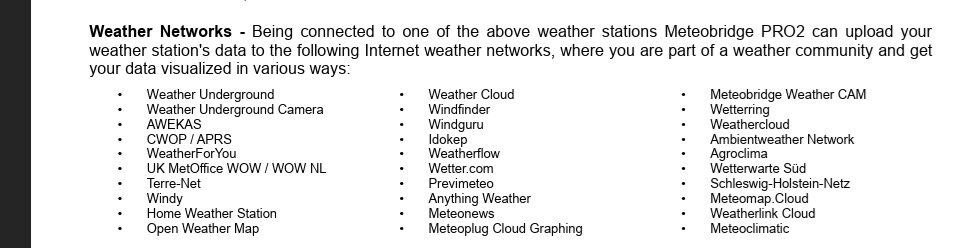

Why is Weatherlink Cloud not listed in the pro 2 I am new to Meteobridge and in the data sheet I does say its available
Can someone tell me if I can or can not connect to weatherlink cloud and yes I have a davis pro 2 but no console I use the meteobridge pro 2

No, the MBPro2 is not able to upload to Weatherlink Cloud.

WeatherLink cloud needs to be fed by special and rather complicated data packets which a Davis console or Envoy do provide. When using a Davis logger these data structures from the console/envoy are passed to the weatherlink cloud. When not using a data lagger connected to a console/envoy but receiving data directly via RF from the sensors, these data structures are not there and, therefore, upload into the weatherlink cloud is not provided.
