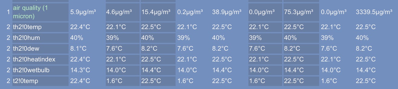

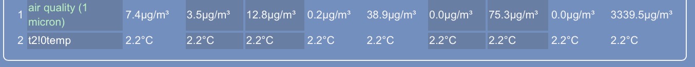

For the temperature, Meteobridge displays 2.2 degrees instead of 22.2, even though I am passing 22.2 as a variable, why?

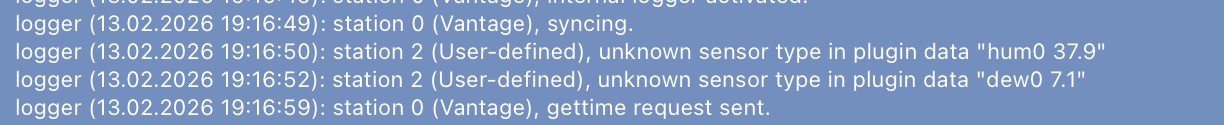

I have integrated the plugin and am getting an error message for the dew point and humidity values.
I'm probably using the wrong variables for dew point and humidity, since the MB Log is showing errors?
Strangely also, even if I delete my userstation I have recorded, the sensor continues to be read. Only restarting the MB helps here!
Who can help me here?

Here is the working plugin version

Re: Plugin for own Sensor Data with user-defined station
Data passed to meteobridge is of type integer. For temperature, rain, wind, pressure the value is send as x10 to provide one decimal of precision even when transported as integer. Therefore, "th0 22 50" will result into 2.2°C and 50% humidity (humidity is not x10 as no decimals are expected).
Thanks for sharing your plug-in code which might help others to implement their own virtual weather station. Please keep in mind that Meteobridge is based on the minimal OPENWRT linux variant and only has ASH as shell, which is a stripped down version of BASH. So shell scripting is a bit more limited as on regular Linux variants using csh or zsh. When more complex operations (like math) are needed, doing this by invoking awk as a good idea - as you did
