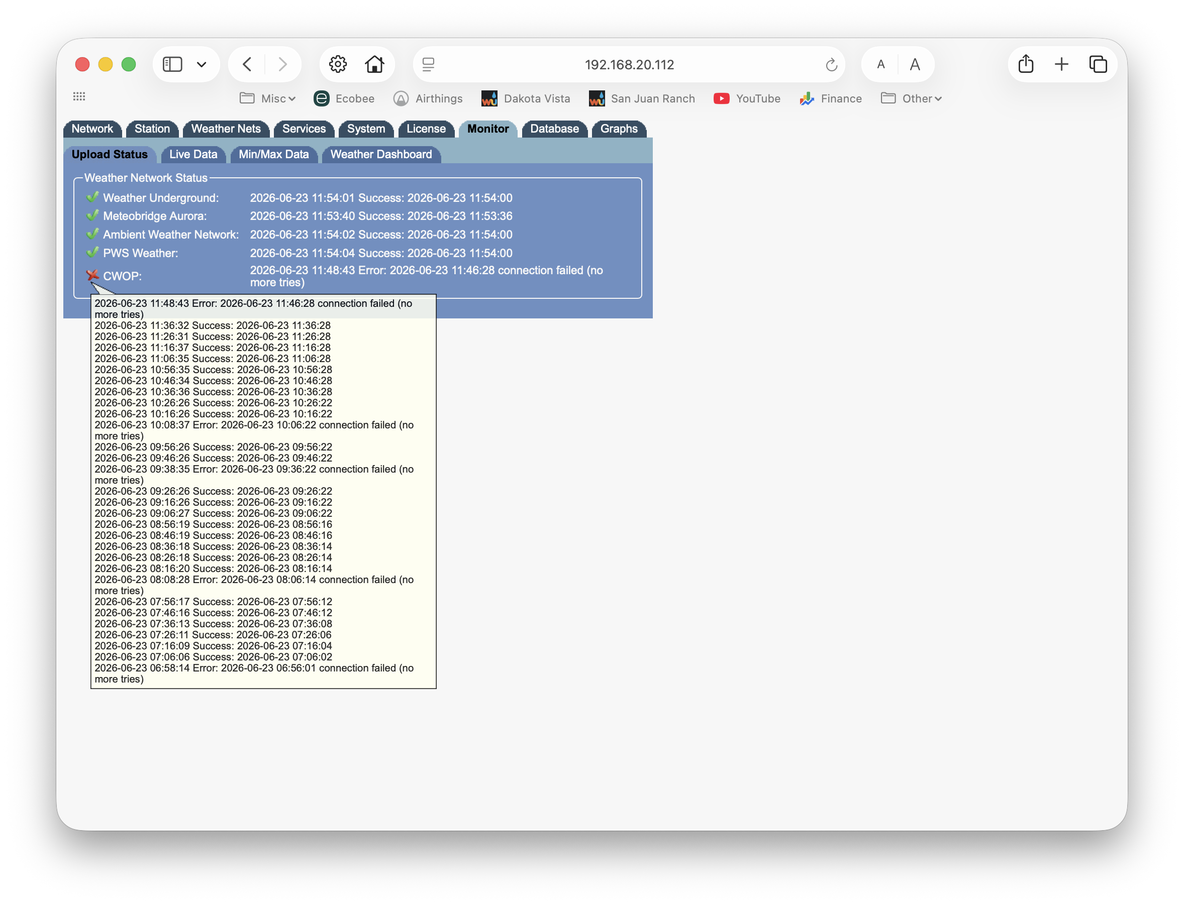

I'm not sure when this started (it was more than a year ago - prior to that I had never seen the errors) but I will let the upload log speak for itself:
Screenshot 2026-06-23 at 11.54.34 AM.png (885.3 KiB) Viewed 258 times
The part I hate the most about this is that it stops all other uploads for more than 2 minutes while it tries to upload to CWOP.
I am seeing this on both my Meteobridge NANO SD and PRO2.
Any ideas?

CWOP has been flakey forever. There's always at least one dead server in the rotation, for whatever reason. I allow retries on it and it usually succeeds on the second try.
It shouldn't be blocking any other uploads, though. Are you sure that's whats happening?

Yes, for about 2:20 it just sits there trying to send to CWOP. Nothing else gets sent to any of my other uploads during that 2:20.
Now, it seems to me (observation) when times up and it finally gives up trying, it does send to Weather Underground all the data that it held for the 2:20 (so no data is actually missing?). But I upload to WxU every 10 seconds so I can see in near real time. I have been very tempted to quit sending to CWOP over this issue but I really don't want to quit on them.
