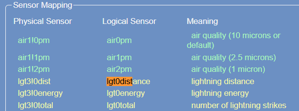

I have two weather stations with the secondary weather station having a lightning sensor. I have mapped the lighting sensor to send data but the lightning distance will not show up on the Ambient Weather Network. Is this because the logical sensor is formatted as " lgt0distance" instead of just "lgt0dist"?
I have tried switching the stations around and when the station with the lightning sensor is set to the Primary Station it work just fine.
Is this a bug?
Screenshot 2026-07-06 104205.png (18.36 KiB) Viewed 284 times
Re: Lightning distance error?
"lgt0dist" and "lgt0distance" was used inconsistently. I tried to change all instances to "dist" now. Please try just released version.

Had some lightning tonight and got to test it out. It worked!
