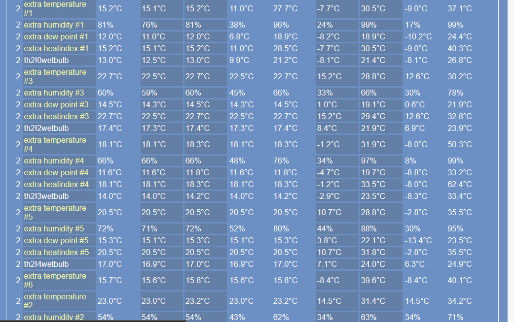

I use ecowitt as a secondary station with a GW2000 (chosen GW1000 in stations) and this works well
All data is showing in live data tab and in the min/max data on my meteobridge Nano SD in the database
I changed the station to GW3000, because I have one now, and now the extra temperatures, dewpoint, heatindex, are NOT shown in min/max data
Humidity readings of the extra sensors is shown
Changed it back to the GW2000 (also in use) and all data is shown

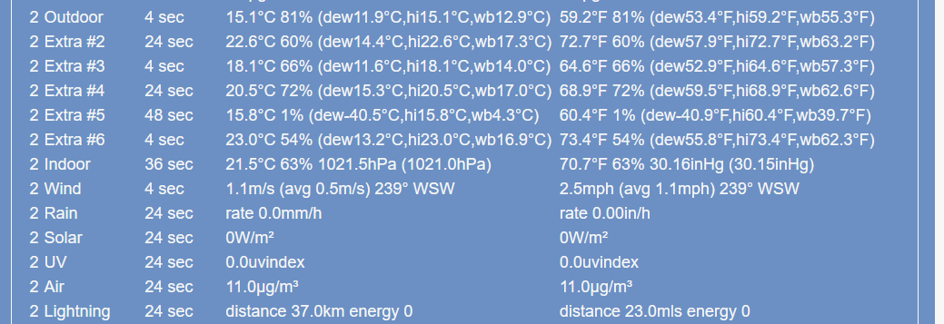

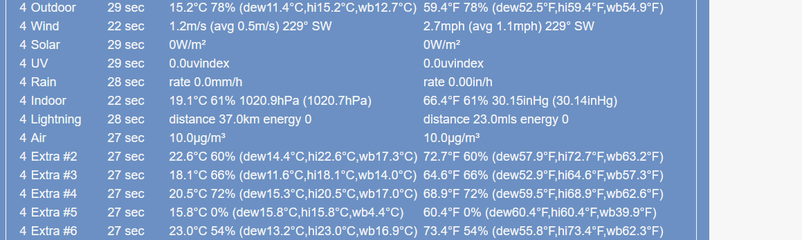

Made an extra station (GW3000) beside my GW2000 and the data of the extra temperatures etc. as mentioned above is not shown on the data of the GW3000 (station 4) in the min/max data
All data is showing on the live data of both GW2000 and GW3000 stations
So it is not the change of station 2 from GW2000 (GW1000 selected) to GW3000 that is causing the issue
Adding another station (no 4) is showing the same problem
I think a bug

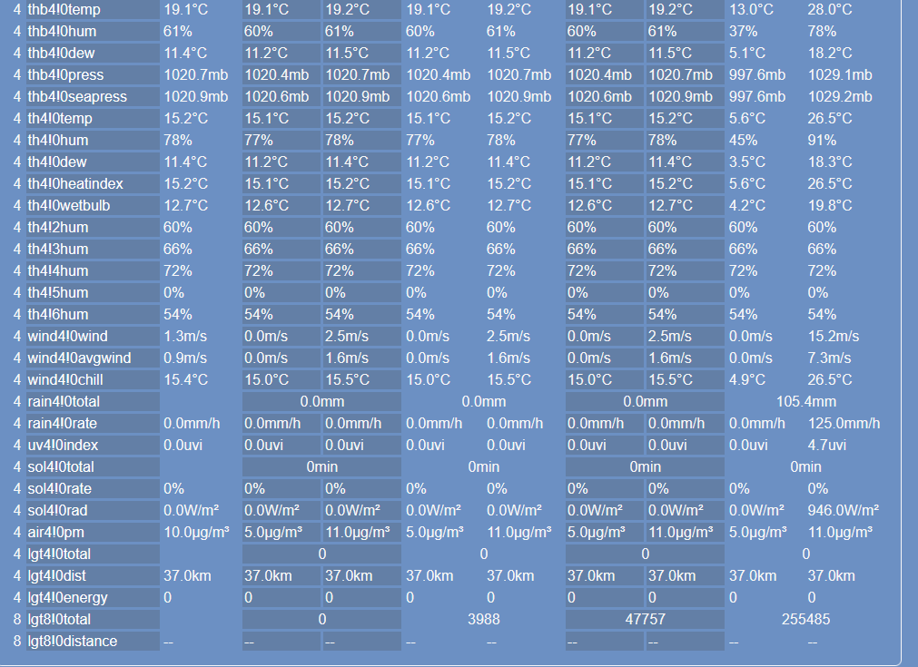

The data is shown until I switched to the GW3000
When I switched back to the GW2000 data is back in database
That is station no 2
I am missing temperature data of the extra sensors on the GW3000 station no4
Humidity is shown in database only the temperatures are missing
th4!2temp, th4!3temp, th4!4temp, th4!5temp, th4!6temp are missing
th4!2hum etc are present in the database
Somehow the GW2000 and 3000 differ?
