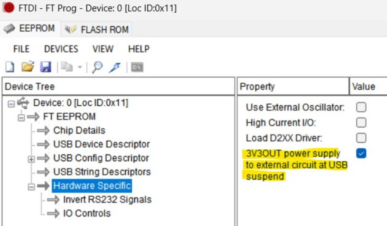

Newest batch of Meteobridge PRO2 is equiped an updated variant of FT232RL chip which handles serial console to VoCore2 chip and provides 3.3v power for the RF subsystem. Unfortunately, the new chip variant toogles under certain conditions to a low power mode that disables the 3.3v supply and by that makes the RF subsystem unresponsive until doing a power-cycle. This symptom does only show up when the power supply that feeds the Meteobridge PRO2 does not internally connect unused data lines D+ und D-. As some power supplies simply let D+ and D- open, the new FT232RNL chip flips into low power mode after a while and disables the RF subsystem.
I got in contact with FTDI, the manufacturer of the FT232 chips, and they provided me a Windows program, that can be used to disable low-power mode and by that rersolves the issue completely. You just have to install the program on your Windows PC and have to use a USB A to micro USB cable to connect the PRO2 with the USB port of your PC. The micro USB cable connects to the PRO2 exactly as you do with the PRO2 power supply. When you start the PC program just select the switch marked in yellow and program to the device.

1) When you have a PRO2 with license number between "mbpro2-01241" and "mbpro2-01265" I highly recommend to do the explained patch with the FTDI tool. All other PRO2 units are not impacted.
2) When you are impacted, please reach out to "info(at)meteobridge.com" so that I can provide you a download link to the FTDI tool. Please understand, that I cannot make it public available following FTDIs requirements.

Quote;" This symptom does only show up when the power supply that feeds the Meteobridge PRO2 does not internally connect unused data lines D+ und D-."
Can this also be true for a power supply that came with the MB Pro2 originally?
Re: unexpected shutdown of internal RF receiver on Meteobridge PRO2 (mbpro2-01241 to mbpro2-01265)
Yes, one sort of power supplies shipped with PRO2s was impacted. That was the way Daniele identified the issue first.
Meanwhile I think we updated all shipped Meteobridge PRO2 impacted by this issue, so far. Therefore, you should not be impacted. Issue is only apparent on mentioned license numbers.
