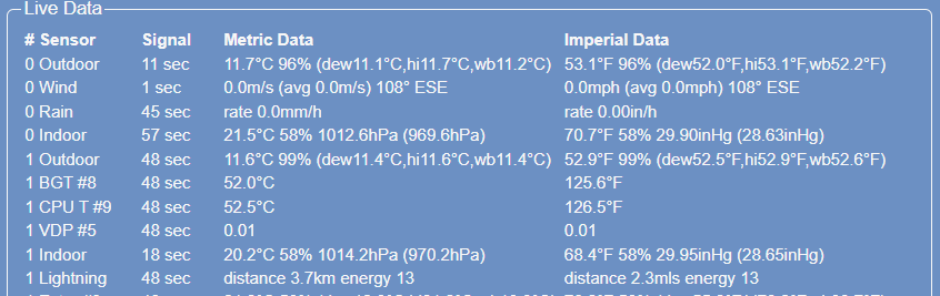

Just updated to the latest build. In doing so and looking at the live data I see that my BGT reports the imperial data as metric and then converts it to an incorrect imperial data value. WBGT is not present and instead I have CPU T #9. See attached screenshot.
Is there a bug or error? Using a GW3000.

when you give me remote login credentials, I can have a look what goes wrong with unit conversions.

admin wrote: Mon Aug 24, 2026 2:34 pm when you give me remote login credentials, I can have a look what goes wrong with unit conversions.
Sent just now.
Guy
Re: WBGT and BGT data appear incorrect
Thanks for login credentials. I found the bug. Just released version has it fixed.

Thanks! Looks like WBGT is still not labelled as such (CPU T #9).
Guy
should be fixed with just released update,
