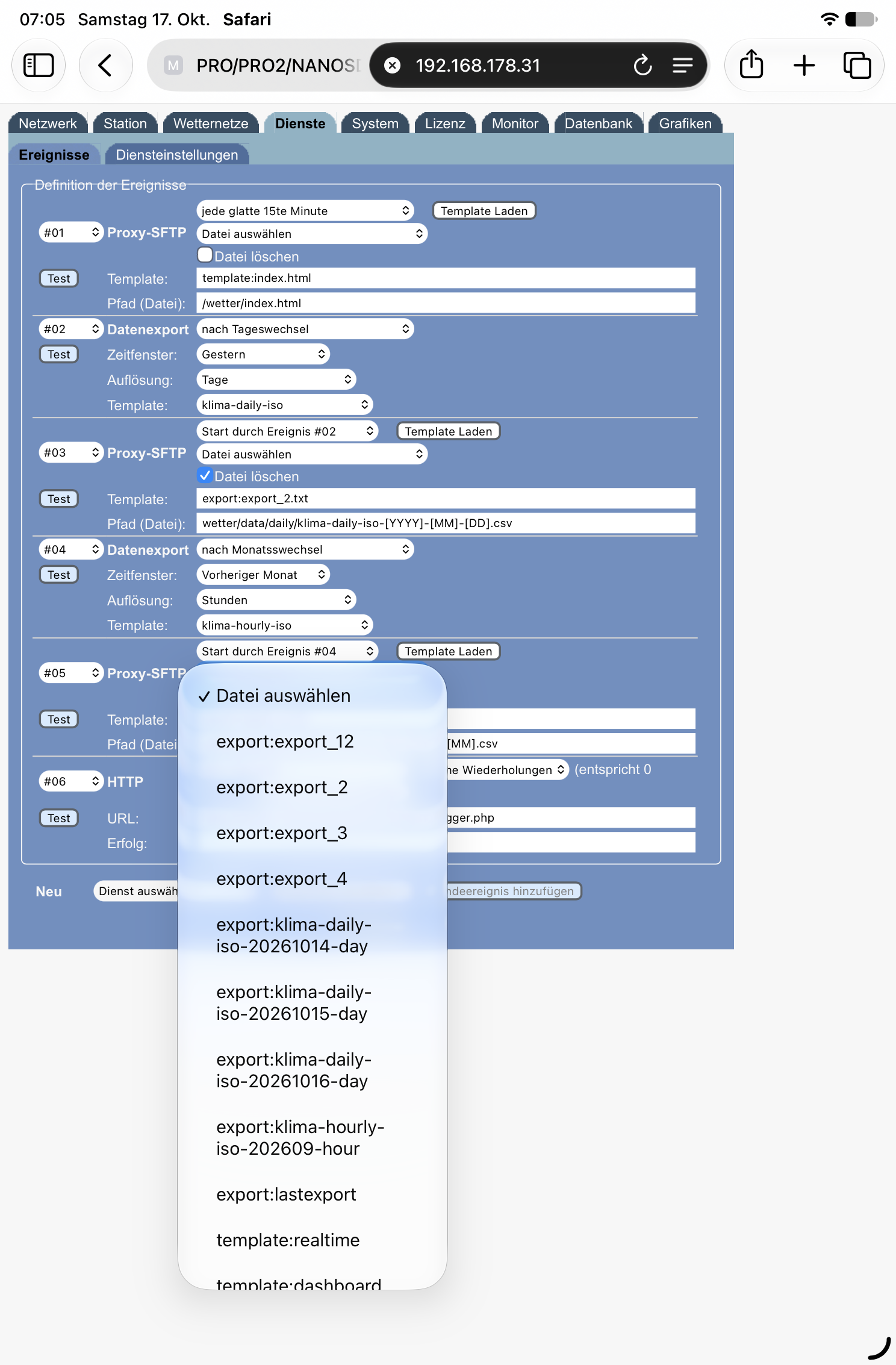

My proxy-sftp task is uploading lastexport.txt with following failures:
  • the file is not deleted and the export folder started accumulating files (option delete is set)
  • the placeholders in the filename are not replaced => day-[YYYY]_[MM]_[DD].csv the format of the export file was ok
The issue is independent from firmware, I tried 6.1, 6.3 and 6,4, followed by a factory reset after up/downdrading.
I am wondering, if a system file could be corrupted? Any advice

One thing worth checking: the date placeholders in the upload filename and the delete-after-upload option are features of the export/graph upload job itself, not of a generic SFTP service event. The official Meteobridge wiki documents both only in the export upload section (Meteobridge NANO SD page), while plain FTP/SFTP/Proxy-SFTP service events upload a referenced file as-is. So if the upload is currently defined as a Proxy-SFTP service event watching the export folder, you would get exactly your symptoms: the file goes up with the literal name and nothing gets deleted. That is a hypothesis from the docs, not something I have tested myself - but moving the upload into the export definition's own upload settings would be my first try.
