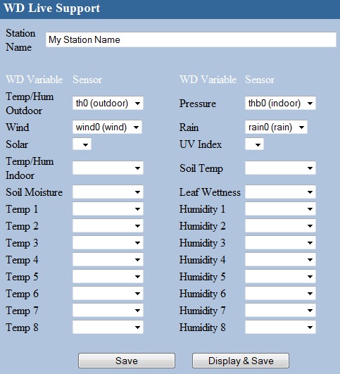

When I click on WD-Live "Display &Save" I see the pop-up window, but it does not show the WD Live Screen. It shows:
Loading (0% to 99%)
Loading Configuration
Loading Data
Error Loading Data (and it says "Waiting for 192.168.1.4" the address of my meteohub).
Meteohub 4.7c (Build 343)
Adobe Flash Player 10.2.152.26
Firefox 3.6.13 (also occurs on IE 8.0.7600.16385)
Any ideas?
Ed
meteohub WD Live.jpg (70.98 KiB) Viewed 21151 times

you need to have the four wdlive files scheduled for computation on graph upload page.
steps are explained here http://wiki.meteohub.de/Setup_Guide

i found it on page 13....
I've followed the instructions on page 13. Same error.

What happens when you access WDL directly from \\YourMeteoHub\public\myweb\uploads or http://YourStaticIpOrDomainName/live/wdlive.html? The reason I ask is I'm getting the following error: "Serial Number Error: You may need to refresh your browser. In Internet Explorer press Ctrl + F5", but can still access the app through these other two methods. I'm running 4.7d on a SheevaPlug, and have licensed WDL.
EdBeavWX
Posts: 14
Joined: Fri Feb 18, 2011 10:05 pm
Re: WD Live fails with "Error Loading Data"
Post by EdBeavWX »
LorieJCall wrote:What happens when you access WDL directly from \\YourMeteoHub\public\myweb\uploads or http://YourStaticIpOrDomainName/live/wdlive.html?
I tried http://192.168.1.9/live/wdlive.html
Same problem.
