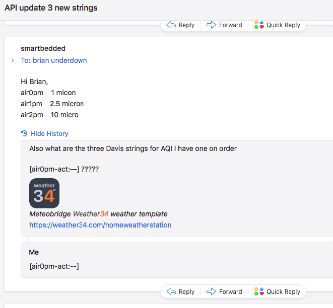

as per information provided by Boris to use with Davis Air Quality
[air0pm-act:--] PM1
[air1pm-act:--]PM 2.5
[air2pm-act:--]PM 10
thats what I worked with think your trying to add something onto the template that doesn't conform to the API . as per previous Ive not seen those strings or seen any reference to those like. I think you are using a plugin ? self compiled .
here is what I was sent in the week I simply worked of those simple standard strings your working with something totally different I have no reference too or see the requirement.

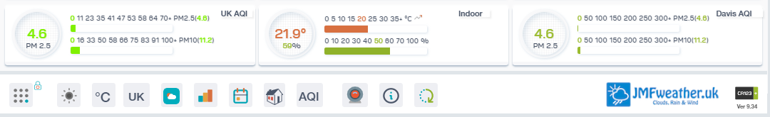

SUCCESS!
Changing the [air1pm-act:--] and [air2pm-act:--] to [air1!1pm-act:--] and [air1!2pm-act:--] in the NanoSD configuration file did the job.
I now have my AQI data using the Davis AQI fields in the weather34 template and now airqualitydavismod.php works fine.
I just have to remember to undo the config changes, or update NanoSD firmware, when I get my real Davis Airlink.
You can now see the comparison between my UK AQI version (on the left) and the default Davis AQI version (on the right)
FYI: There are different AQI scales in various global regions. https://en.wikipedia.org/wiki/Air_quality_index and the UK has a more graded but narrower scale to that of Europe or the USA even though the underlying pm2.5 and pm10 raw values are very similar. Obviously the Davis Airlink will default to the USA scale. Could a future update to the template allow regional AQI scales to be selected according to the station location in the console-settings?

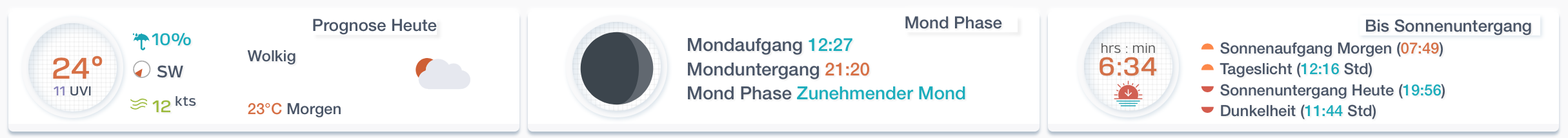

I testing the new MeteoBridge native W34-Dashboard.. It runs good, but I have found two issues:
1. the WU forecast = I use exactly the same WU-API-Key as I do for my webspace-based W34-Dashboard, the forecast on the MB-Based Dashboard is still different..
2. The sunrise/sunset-times on the MB-Dashboard differs from the times on the webspace-based Dashboard. MB is configured to use the internal coordinates saved in MB, this coordinates are definitively correct. It seems so, that MB-Dashboard uses much more southerly coordinates but they can't set in the setup-screen here, so I think the MB-coordinates are used?

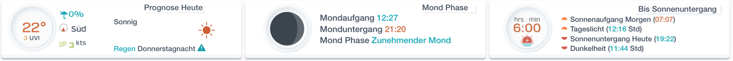

Here are the correct display from web-based-Dashboard:
Bildschirmfoto 2020-09-21 um 13.22.55.png (189.1 KiB) Viewed 5218 times
and here the wrong values from MB-based Dashboard:
Bildschirmfoto 2020-09-21 um 13.22.37.png (187.94 KiB) Viewed 5218 times
The moon-phases and times are correct on both displays, so it seems so, only the latitude-set is wrong on the MB-Based Dashboard-Setup.

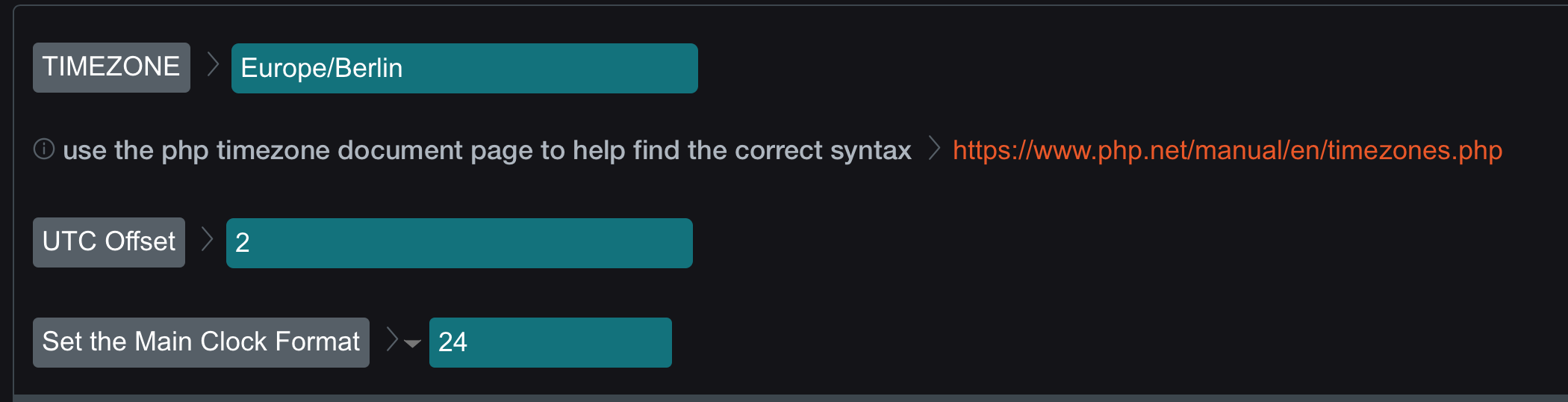

In the internal Version no Latitude-Longitude-Settings are possible:

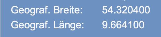

In the web-Version:
Bildschirmfoto 2020-09-21 um 14.20.26.png (105.1 KiB) Viewed 5208 times
I know that you can't support the internal version but maybe Boris will read this. :-)
I'll let the internal version run until tomorrow for testing, maybe something will change at the change of day?
