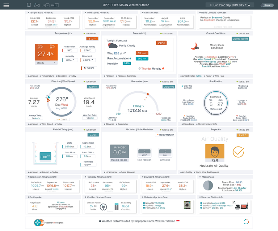

After nearly 6 months of building a version to exploit as many capabilities of the Meteobridge NANOSD weather34 is happy to release this version.
Whats the difference between this and other variants ?
1. It is built on the CSS structure of CSS GRID ..offers a greater flexibility in designing dashboard layouts and scaleability between smart devices and browsers.Requires latest or early 2019 versions of browsers to support CSS GRID .some info on css grid from my favourite css learning site
https://css-tricks.com/snippets/css/com ... uide-grid/ ..
2. Exploits and takes advantage of the Meteobridge software built into the NANO(SD) .
3. Designed with NANOSD users in mind and the combination of Davis Vantage Weather Station Hardware.90% chance of working with meteobridge pro.
4. Easier to maintain and collaborate as users are basically all using similar configurations i.e Davis Vantage with NANO(SD).90% chance of replicating errors reported .
5. Charts requirement is simple without any knowledge of MYSQL required .Whilst MYSQL is flexible many users struggle in this area as no fault of their own and dont have the previous experience or knowledge to get over the setup procedure.
Using the benefit of Meteobridge Software to trigger data file creation via the services tab removes that overhead and frustration .All chart data is stored on your server in CSV format for safekeeping and use in other applications like spreadsheets etc. This is all done in the background at preset intervals there is no manual input or external cron jobs etc .Only risk is if your NANO(SD) stops sending for whatever reasons or your hosted server is unavailable (offline).
6. Design as always is at the forefront to try and make things as friendly as possible in the cleanest manner .It is difficult to try and maintain a clean design when so much data is made available or is at your disposal.
7. Offsite data like forecast,air quality,earthquakes are again all done in the background via the services tab .As always things like this are prone to downtime beyond our control .Template is designed to read data from stored files on your server not realtime scraping from other servers .
8. Straight forward setup guides are available via https://weather34.com/homeweatherstation via the menu top right.
9. Does not support TP-LINK type or alike hubs with meteobridge software .Many features are based on the NANO(SD) capability which is not present in TP-LINK type hubs .
10. MB-SMART displays 21 different modules in desktop and Tablet landscape mode reduces to 10 main modules in portrait tablet mode and single column layout for phone size screens.
11. MB-SMART uses a setup screen called mb-smart-setup and by default has no password indicated by the open padlock in the menu .Set your password as a priority and the padlock will show locked in the menu.
12. Supports 6 common used languages French,Spanish,German,Italian,Dutch,English(GB,US,CAN).
languages can be added but must be translated via a NATIVE speaker of that language and checked if design is broken due to word differences in lengths it wont be added by default.It is incredibly difficult to design around many languages and often hampers ideas and use-ability so every effort has been made to align across the default languages offered.unfortunately languages causing broken design or unchecked will no be added by default.
13.Unlucky number :-)
14. Download Available via https://weather34.com/homeweatherstatio ... smart.html clicking the download link.
15. FAQ and setup guides available via https://weather34.com/homeweatherstation/
16. Template Supports 196 different values generated by NANOSD realtime .list below as of 21st September 2019 (4 new ones were 21-09-2019 related to heatindex and windchill *requires NANOSD reboot these are seen in the heat-chill-year-month.php small module option)
mb.php?d=[DD]/[MM]/[YYYY] [hh]:[mm]:[ss] [th0temp-act:--] [th0hum-act:--] [th0dew-act:--] [wind0avgwind-act:--] [wind0wind-act:--] [wind0dir-act:--] [rain0rate-act:--] [rain0total-daysum:--] [thb0seapress-act:--] [wind0dir-avg5:--] [wind0wind-act=bft.0:--] m/s C hPa mm [wind0wind-avg5:--] [thb0seapress-val60:--] [rain0total-monthsum:--] [rain0total-yearsum:--] [rain0total-ydaysum:--] [thb0temp-act:--] [thb0hum-act:--] [wind0chill-act:--] [th0temp-val60:--] [th0temp-dmax:--] [th0temp-dmaxtime:--] [th0temp-dmin:--] [th0temp-dmintime:--] [wind0avgwind-dmax:--] [wind0avgwind-dmaxtime:--] [wind0wind-dmax:--] [wind0wind-dmaxtime:--] [thb0seapress-dmax:--] [thb0seapress-dmaxtime:--] [thb0seapress-dmin:--] [thb0seapress-dmintime:--] [mbsystem-swversion:--] [mbsystem-buildnum:--] [wind0wind-max10:--] [mbsystem-platform:--] -- [uv0index-act:--] [rain0total-sum24h] [sol0rad-act:--] [wind0dir-avg10:--] [rain0total-sum60:--] [th0dew-mmax:--] [th0dew-mmaxtime:--] [th0dew-mmin:--] [th0dew-mmintime:--] [th0dew-ydmax:--] [th0dew-ydmaxtime:--] [th0dew-ymax:--] [th0dew-ymaxtime:--] [th0dew-ymin:--] [th0dew-ymintime:--] [uv0index-dmax:--] [th0hum-dmax:--] [th0hum-dmaxtime:--] [th0hum-dmin:--] [th0hum-dmintime:--] [th0dew-dmax:--] [th0dew-dmaxtime:--] [th0dew-dmin:--] [th0dew-dmintime:--] [th0temp-val15:--] [th0hum-val15:--] [th0dew-val15:--] [thb0temp-val15:--] [thb0hum-val15.0:--] [wind0wind-avg15:--] [wind0wind-avg30:--] [lgt0energy-act:--] [lgt0dist-act:--] [lgt0dist-age:--] [lgt0total-daysum.0:--] [lgt0total-monthsum.0:--] [lgt0total-yearsum.0:--] [sol0rad-dmax:--] [mbsystem-uptime:---] [th0temp-ydmax:--] [th0temp-ydmaxtime:--] [th0temp-ydmin:--] [th0temp-ydmintime:--] [th0temp-mmax:--] [th0temp-mmaxtime:--] [th0temp-mmin:--] [th0temp-mmintime:--] [th0temp-ymax:--] [th0temp-ymaxtime:--] [th0temp-ymin:--] [th0temp-ymintime:--] [wind0wind-ydmax:--] [wind0wind-ydmaxtime:--] [wind0wind-mmax:--] [wind0wind-mmaxtime:--] [wind0wind-ymax:--] [wind0wind-ymaxtime:--] [rain0total-ydmax:--] [rain0total-mmax:--] [rain0total-mmintime:--] [rain0total-ymax:--] [rain0total-ymaxtime:--] [sol0rad-dmax:--] [sol0rad-dmaxtime:--] [sol0rad-ydmax:--] [sol0rad-ydmaxtime:--] [sol0rad-mmax:--] [sol0rad-mmaxtime:--] [sol0rad-ymax:--] [sol0rad-ymaxtime:--] [uv0index-dmaxtime:--] [uv0index-ydmax:--] [uv0index-ydmaxtime:--] [uv0index-mmax:--] [uv0index-mmaxtime:--] [uv0index-ymax:--] [uv0index-ymaxtime:--] [th0dew-ydmin:--] [th0dew-ydmintime:--] [mbsystem-lastgooddata:--] [th0temp-avg60:--] [rain0total-nonzerotime:--] [th0temp-amax:--] [th0temp-amaxtime:--] [th0temp-amin:--] [th0temp-amintime:--] [th0dew-amax:--] [th0dew-amaxtime:--] [th0dew-amin:--] [th0dew-amintime:--] [wind0wind-amax:--] [wind0wind-amaxtime:--] [thb0seapress-ydmax:--] [thb0seapress-ydmaxtime:--] [thb0seapress-ydmin:--] [thb0seapress-ydmintime:--] [thb0seapress-mmax:--] [thb0seapress-mmaxtime:--] [thb0seapress-mmin:--] [thb0seapress-mmintime:--] [thb0seapress-ymax:--] [thb0seapress-ymaxtime:--] [thb0seapress-ymin:--] [thb0seapress-ymintime:--] [thb0seapress-amax:--] [thb0seapress-amaxtime:--] [thb0seapress-amin:--] [thb0seapress-amintime:--] [rain0total-allsum:--] [th0temp-davg:--] [mbsystem-lunarsegment:--] [mbsystem-lunarpercent:--] [mbsystem-daylength:--] [mbsystem-moonrise:--] [mbsystem-moonset:--] [wind0wind-davg:--] [th0hum-mmax:--] [th0hum-mmaxtime:--] [th0hum-mmin:--] [th0hum-mmintime:--] [th0hum-ymax:--] [th0hum-ymaxtime:--] [th0hum-ymin:--] [th0hum-ymintime:--] [th0hum-ydmax:--] [th0hum-ydmaxtime:--] [th0hum-ydmin:--] [th0hum-ydmintime:--] [thb0lowbat-act:--] [th0lowbat-act:--] [rain0total-max@M1] [rain0total-max@Y1] [air0pm-act:--] [th0temp-avg5:--] [thb0seapress-avg5:--] [uv0index-avg5:--] [wind0avgwind-avg5:--] [sol0rad-avg5:--] [th0dew-avg5:--] [rain0rate-avg5:--] [th0hum-avg5:--] [th0temp-yavg:--] [wind0wind-yavg:--] [th0temp-starttime:--] [wind0wind-starttime:--] [thb0seapress-starttime:--] [rain0total-starttime:--] [rain0total-ymintime:--] [wind0dir-mavg:--] [th0heatindex-ymax:--] [th0heatindex-ymaxtime:--] [wind0chill-ymin:--] [wind0chill-ymintime:--] _[forecast-text:]
17.Contributors and Big Thanks for their patience and help ,observations,ideas,contributions.It was a great pleasure and easy to resolve many things in a timely manner.
Lars (Singapore),Paul(UK),Graham(Guernsey),Ron(USA K1TTC),Piet(Netherlands),Tony(Tasmania),Boris(Germany Smartbedded Meteobridge).
some screenshots below but you can find more at https://weather34.com/homeweatherstatio ... smart.html
Screenshot_2019-09-21 Singapore Home Weather Station.png (296.5 KiB) Viewed 22493 times
Screenshot_2019-09-21 Methuen, MA Home Weather Station.png (357.26 KiB) Viewed 22493 times

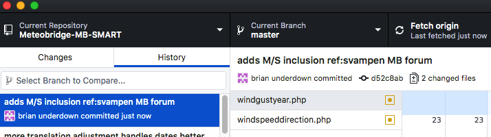

Posts: 1826
hello thanks for the heads up however translations are incredibly difficult to design around if i was stubborn enough i would not include translations at all , having said that i have done my best to accommodate languages where i had help over the last few months . looking at your swedish already i see design alignment issues , can only suggest look shorter phrases if they exist in your language if they dont guess you can hard code for your personal preferences . wind run ill take a look at what i can find shouldnt be too difficult
Posts: 1826
svampen wrote: Tue Oct 01, 2019 8:37 pm Dear Brian
I would like to thank you for all work creating this template! Hat's off for you!
I have installed it some day ago and made a translation file for Swedish. Running it now to see eventual hickups or errors regarding that.
https://vader.krumelur.nu/
I now just have to find out what the unit "mi" for windrun is, when using scandinavian units (m/s for wind). Does not seem to be miles, nor km. Have to dig into the code a bit deeper, I guess. :wink:
2 files updated to the GITHUB master but you might be wise to get all updated files as some adjustments were made specific to handling translations better . what exactly are we looking in reference to wind run ?
send translated file via pm if possible I can take a look and see if it is useable to include in download
Screenshot at Oct 01 22-06-51.png (49.23 KiB) Viewed 22350 times
svampen
Posts: 32
Location: Sweden
Post by svampen »
I can send you the translation-file, but I am still tinkering with it. Some words are not suitable etc. Hard to see all places they might go and choose the right nomenclature.
But I fixed the wind run issue as follows:
in Windspeeddirection.php, at the very end:
<div class=weather34windruntoday1>
<?php echo ' &nbsp;<windaveragevalue>',number_format($weather["windrun34"],1)."</windaveragevalue><weather34windrunspan>"?>
<?php if (($weather["wind_units"]=='km/h') || ($weather["wind_units"]=='m/s')){echo 'km';}else echo 'mi';?></weather34windrunspan></div>
<div class=windruntoday1><?php echo $lang['Wind Run']." ".$lang['Today'];?></div>
And in Livedata.php, approx line 105, I added a factor of 3,6 as such:
	//weather34 windrun based on daily average
    $windrunhr=date('G');$windrunmin=(($windrunmin=date('i')/60));$windrunformula=$windrunhr=date('G')+$windrunmin;
	$weather["windrun34"]=$weather['wind_speed_avg30']*number_format($windrunformula,1);
    //Fix for correct m/s format by RM
if ($weather["wind_units"]=="m/s") {
    $weather["windrun34"]=$weather["windrun34"]*3.6;
Posts: 1826
svampen wrote: Wed Oct 02, 2019 1:23 pm I can send you the translation-file, but I am still tinkering with it. Some words are not suitable etc. Hard to see all places they might go and choose the right nomenclature.
ok just send it along when your ready no rush . ha i see about windrun . ill add it in sometime next week or wait till your language file is ready.. thanks for the feedback..brian
