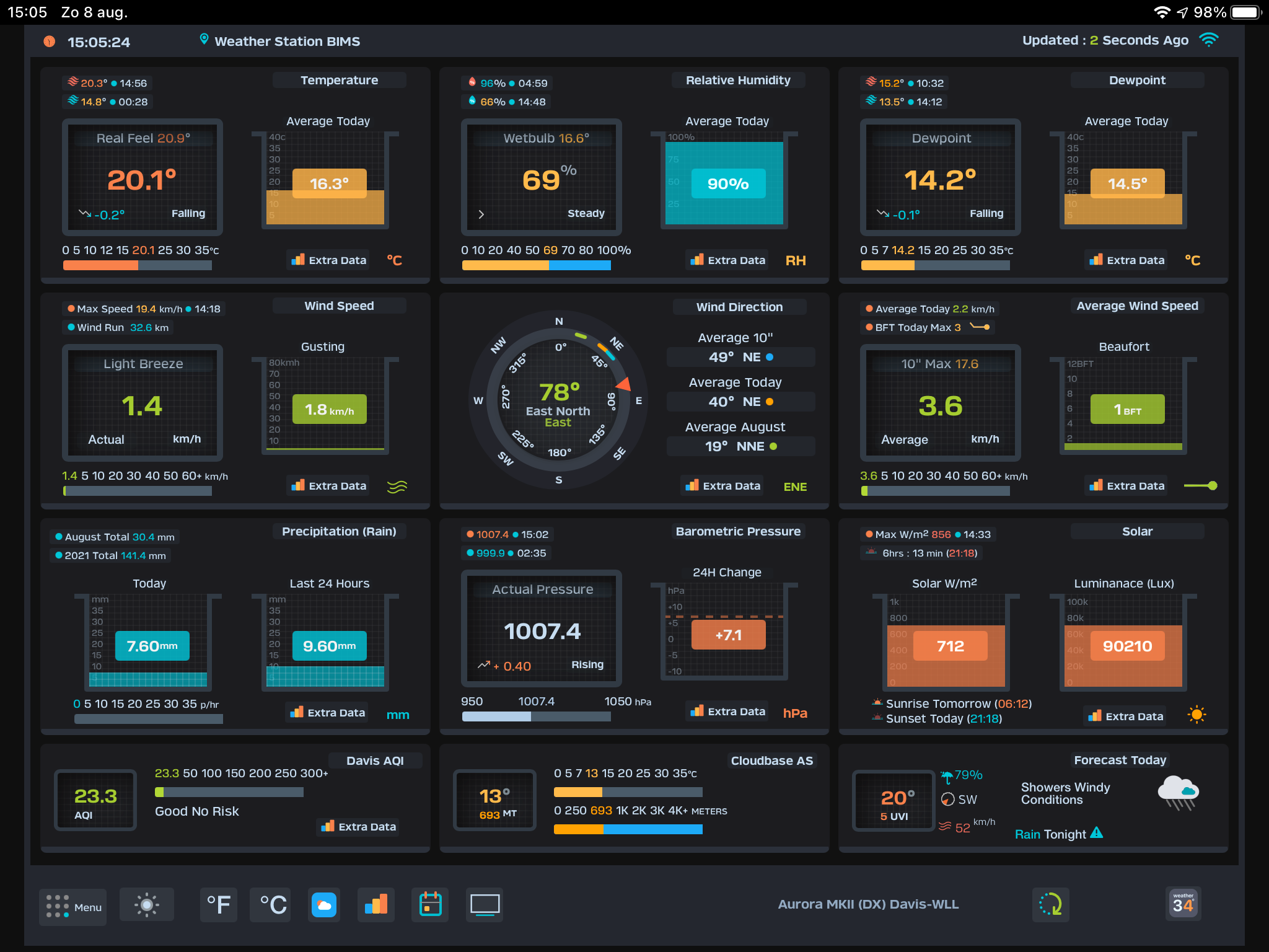

question for anyone does this keep it simple and informative or too busy ?
im listening but every time I produce something simple I get lots of can we do this , can we have this etc so instead of being a grumpy ol git :-) ill try ideas and see what the responses are ..
screenshot
Screenshot at Aug 08 15-37-19.png (184.34 KiB) Viewed 5970 times
Bart
Posts: 128
Post by Bart »
weatherist34 wrote: Sun Aug 08, 2021 2:40 pm ….. or too busy ?
Not at all. And it it does not differ from the main menu. It is fine this way! Nice!
Bart
Posts: 1826
personally too busy for my liking but im listening :-)
Bart
Posts: 128
Post by Bart »
That's exactly what I thought you thought of it yourself. And why I posted a second screenshot to compare. But do not be sad. Surely someone will agree with you. But don't change. please.… :lol: :lol:
