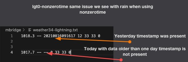

, ref Ecowitt lightning im not getting sucked into this brand , there is an issue with using nonzerotime for last strike in Meteobridge , the nonzerotime [lgt0total-nonzerotime:--] string does NOT produce a valid timestamp of any sort after a day or more , exactly how long I don't know ,so provide I provide this info and hopefully users can liase with Boris with their findings .Im not the person who can resolve this as Ive seen this for a few years with rain when using nonzerotime ."resolving nonzeotime is a tedious task because the outcome is not immediate you may have to wait a day or more to see if it is resolved ".. food for thought does it only reproduce an anomaly after a meteobridge reboot/firmware upgrade ? and requires a strike to resolve ..have a good day
screenshots below .

* (07:50) ** Ecowitt last strike does not function this is a meteobridge or hardware brand problem has the nonzerotime does not produce a timestamp it seems after 1 day or more. fallback for no timestamp data has been added.

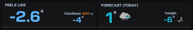

Good morning Brian, if the forecast description is too long, it collides with tomorrow.
- Sin título.png (18.11 KiB) Viewed 5951 times
- Posts: 1824
thanks see GITHUB file ...but I really think every new idea/suggestion just brings more problems , many go unseen or impossible to plan for when compiling ideas . weather template development truly sucks at times its a chore todo the most simplest of ideas !!! there is no happy medium it just gets tedious . so please I kindly ask @all no more ideas, just take the template for what it is and if doesn't meet your requirements there are plenty of others to use ..

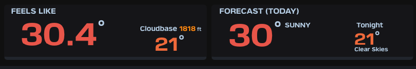

The idea of forecast in ALT mode is good, I'll adapt "str_replace (" to my needs.
- Posts: 1824
try the file just pushed to GITHUB might be easier to manage for you

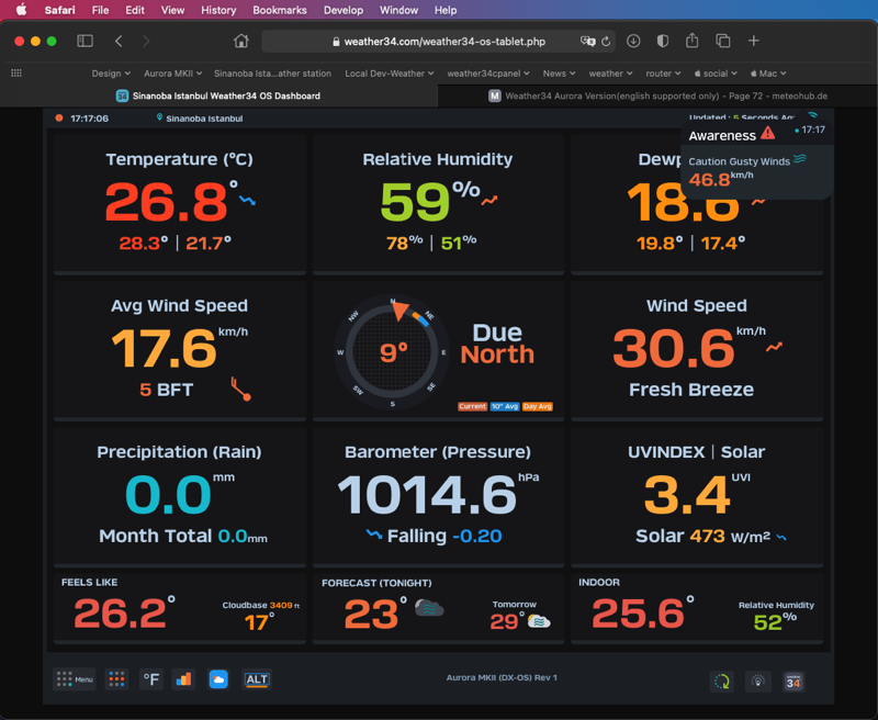

Download Update 19th August 2021
* (07:31) ** Update for Alt/OS theme update
* (07:31) ** Replaces forecast phrase with Icon Ref Josep
* (07:31) ** Reworks clock sunrise/set layout
* (07:31) ** Adds fallback for GW1000(alike) lightning sensor with blank nonzerotime
for Ecowitt Lightning Sensor use see end of setup guide
here Setup Info Guide
forecast icons replaces phrases
with valid lightning distance
fallback for blank nonzerotime in lightning (N/A)
with valid nonzerotime in lightning

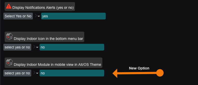

Download Update 20th August 2021
* (10:11) ** Update for Alt/OS theme update
* (10:11) ** Adds option to show indoor module or not in mobile view Ref Daniel
* (10:11) ** Adds forecast module to mobile view
for those with no use for indoor temperature or concerns and for those wanting forecast in mobile view .
have a great weekend..Brian

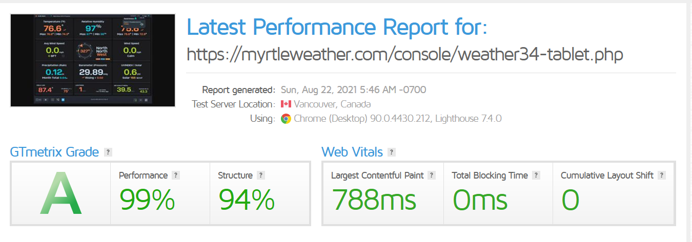

As always once the newer idea becomes stable its good to remove all the accumulated Dev code which always happens , with that comes a nice load performance result and a happy server .screenshot below of load time with ICDSOFT hosted server a result of less than 1 second == 0.8 seconds !! !!! results also depend how your server is configured .
Download Update 22nd August 2021
* (10:11) ** Fixes KTS format in average wind module
* (10:11) ** Removes all Dev code reduces load time
*Please note as of September 1st update file will only contains files updated from September 1st not March 1st..
