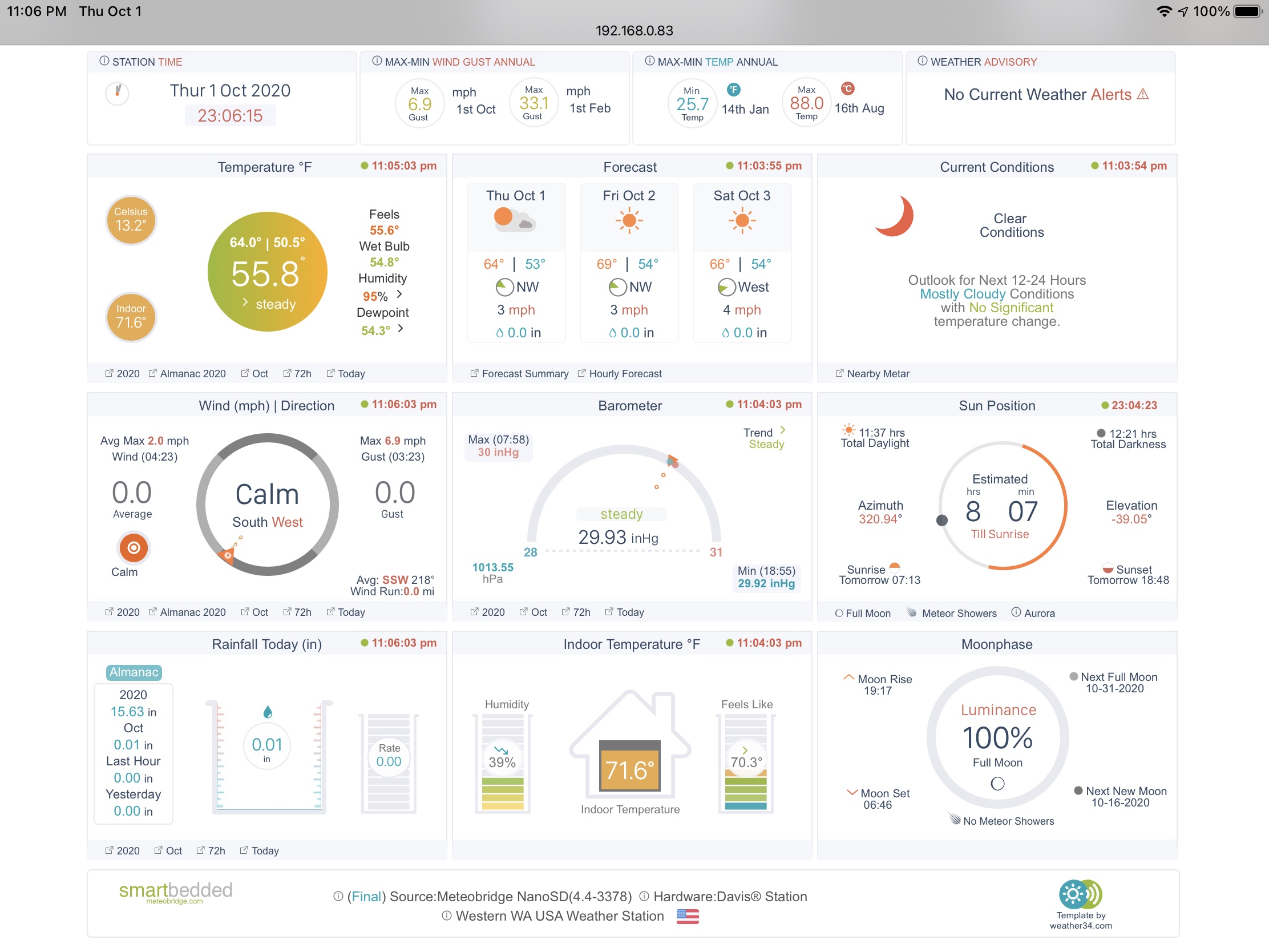

hello if this the internal nanosd screen version you may want too raise the issue here viewtopic.php?f=61&t=15131
thats a very old dated version your displaying in the screenshot ..brian

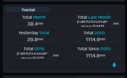

Hello Brian, I am having the following problems with the 2 excel files each day I have to correct the duplicate dates on each file, also the year rain in the almanac has changed from when you last fixed
Thanks Richard

Re: Weather34 TEMPLATE
Hello look its not me or anything changing in template its in the firmware updates . I cant keep up and slowly watching it all fall apart :-( .
ill brake this down for you but in simple terms nothing changed in the template on how any almanac data is handled .
the two strings in the API have always been
[rain0total-max@M1] [rain0total-max@Y1]
because of the way sensors have started change the way they are handled for reasons beyond me or control they now appear in your API as below
this is why your are seeing the string output like that in the almanac because the template has no idea it exists..this just one of many Ive had reported this week ..
as per I guess a recent change in firmware update and your API output now outputs like this notice the !0 in the string..
[rain0!0total-max@M1] [rain0!0total-max@Y1]
I can vision template becoming completely messed up I can not follow the changes or have the enthusiasm todo so its a lot of work and your not the first to report this week anomalies with these new strings appearing for which I have no idea its all in the firmware so expect things to go terribly wrong randomly. I don't control the API output strings !!!
No idea why you are seeing duplicates is this a recent issue or long term because once again nothing changed in template apart from additional UV-Solar being added but that wouldn't cause duplicate lines .
So Im sticking to version 4.2 firmware ..
here is your API output which I do not change or have any control over you can clearly see its using [rain0!0total-max@M1] [rain0!0total-max@Y1]
03/10/2020 09:31:26 12.6 89.0 10.8 6.3 2.2 344.0 0.0 1.6 991.7 355.0 2 m/s C hPa mm 5.9 991.6 38.4 1114.6 29.8 18.9 68.0 12.1 12.7 12.7 20201003074342 11.6 20201003045243 7.6 20201003082958 14.3 20201003082756 993.8 20201003004257 991.3 20201003084458 4.4 13813 14.3 TL-MR3020 -- -- 20.6 -- 4.0 0.0 11.3 20201003080506 5.5 20201001225634 11.2 20201002234942 21.7 20200812193157 -4.1 20200321201319 -- 94.0 20201003000002 87.0 20201003013029 11.3 20201003080506 10.3 20201003013037 12.6 89.0 10.8 18.8 68 6.3 6.4 -- -- -- -- -- -- -- 394340 12.1 20201002234826 6.2 20201002000010 14.8 20201001134235 6.1 20201001231553 28.4 20200624145252 -0.3 20200326055726 16.1 20201002094012 16.1 20201002094012 30.0 20200209081904 29.8 38.4 20200129071315 1114.6 20200129071315 -- -- -- -- -- -- -- -- -- -- -- -- -- -- -- 5.8 20201002000010 0 12.6 20201003054058 28.4 20200624145252 -1.5 20200129071249 21.7 20200812193157 -4.1 20200321201319 30.0 20200209081904 993.7 20201002211800 983.4 20201002054258 1001.2 20201001000557 983.4 20201002054258 1041.0 20200329213408 982.3 20200229050705 1049.3 20200329213408 982.3 20200229050705 1114.6 12.2 4 98.1 11:28 19:47 08:41 6.2 100.0 20201002035716 67.0 20201001135506 100.0 20200302054801 30.0 20200529165801 100.0 20201002035716 87.0 20201002104208 0.0 0.0 [rain0!0total-max@M1] [rain0!0total-max@Y1] -- 12.6 991.8 -- 6.3 -- -- -- 89.4 12.4 3.7 20200129071249 20200129071233 138.6 7 4 152.7 29.8 20200625145130 -5.1 20200226001741 _Mostly cloudy and cooler. Precipitation possible within 12 hours, possibly heavy at times. Windy.

@Atlantic21
I have just updated the simple update file download
I have put a fix in there but how many more will be required I have no idea . The TPLINK types don't have last months DATA for rainfall or Last Years
so I put these lines in there so it will just show N/A
if ($weather['rainlastmonth']=='[rain0total-max@M1]') {echo "N/A";}
if ($weather['rainlastmonth']=='[rain0!0total-max@M1]') {echo "N/A";}
if ($weather['rainlastyear']=='[rain0total-max@Y1]') {echo "N/A";}
if ($weather['rainlastyear']=='[rain0!0total-max@Y1]') {echo "N/A";}
Best I can do ...Brian

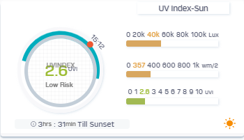

Looks like there is a small alignment issue on your latest uv-sun update. Seems to be with Chrome and Firefox on Windows and Chome on Mac - ok on IOS. Here is a screen shot:
Take care,

@chuck Ill fix that normal firefox/chrome dont like the margin ..
That fixed the alignment. :D
