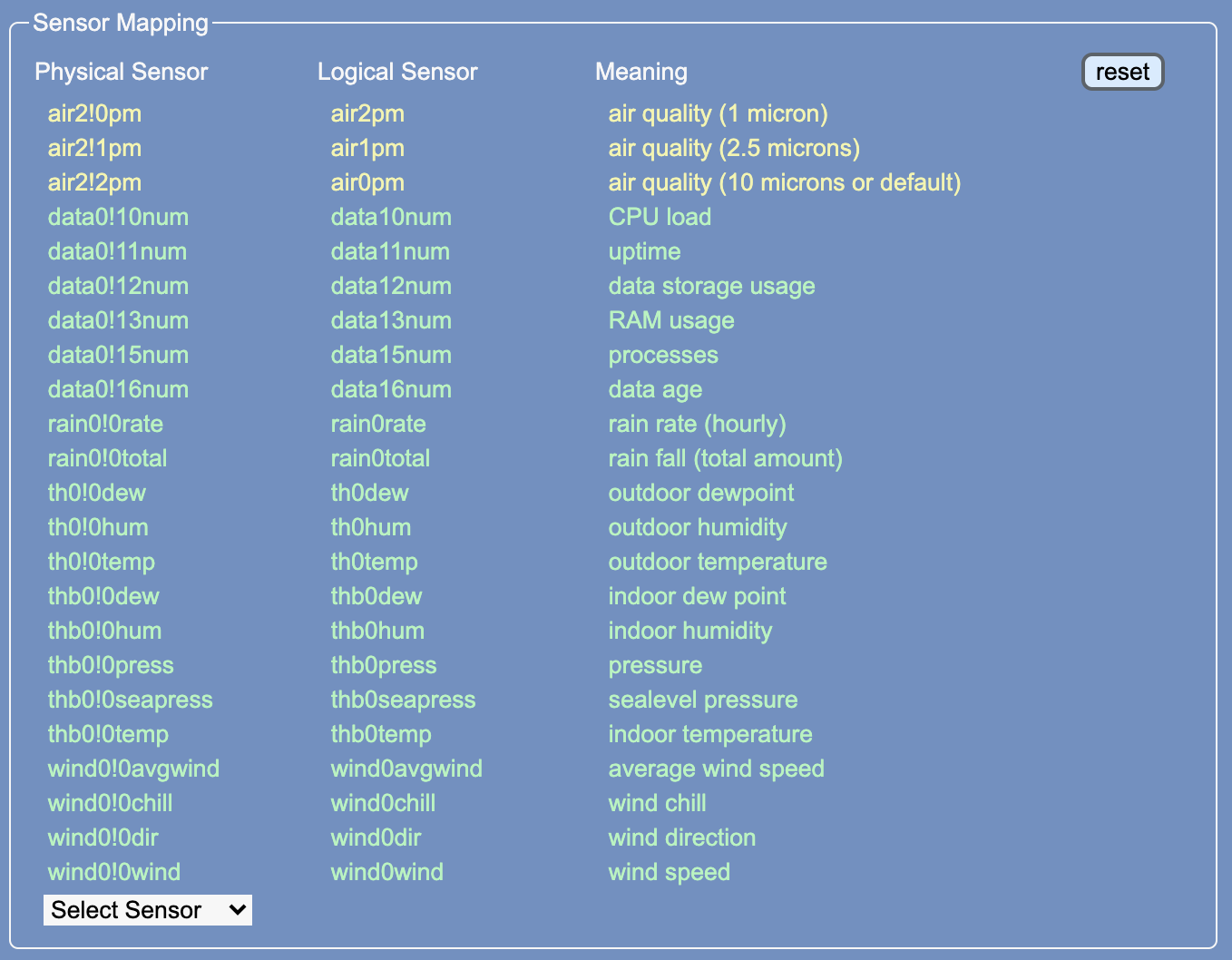

I don't fully understand the mapping function, but I think that the logical sensors are supposed to be mapped to the corresponding sensors of station #0 by default. So, th0temp should be the default mapping, unless a user changes it.
So, my guess is there are some bugs in the latest firmware causing some of the mappings to not use the default. Or, users are changing the mappings.

My understanding of the mapping is that there can be many physical sensors (the input data) collected from multiple HW sources.
There are also a number of standard logical sensors (the output) that are then used to export data to the various weather services.
Screenshot 2020-10-03 at 3 October 2020 20.12.38 pm.png (215.89 KiB) Viewed 4586 times
The "Primary Sensor" (the 0th, zero-th) will be the default sensor hardware to map inputs to outputs as above. So in the API you should still see values for th0temp, th0dew etc. as normal.
If someone wanted to use the temperature or humidity reading from the one of the other HW sensorts instead of sensor 0 values for thb0temp or thb0hum then they could do that mapping and thb0temp would output the secondary HW sensor data to your API sensor value. E.g. th2!0temp mapped to thb0temp.
I have two AQI sensors: my own Nova SDS011 aka - sensor #1, and the Davis Airlink aka sensor #2). I have mapped the Airlink input sensors to the new air0pm/air1pm/air2pm which are not defaulted (afaics). These are then outputted as items 180/181/182 in the w34 template API.
As Chuck said, if something else is ending up in the w34 template API, not sensor data but a physical sensor name, then I believe this is a bug of some sort for Boris to work on as I believe it's not expected behaviour. What particular combination of HW/Sensor/SW causes this would be the first problem determination step.
Deliberately changing the output sensor names would clearly break the API templates in the meteobridge config file and I cannot think that would have been done intentionally by Boris without further documentation and a heads up.

The mapping tab shown in the posting above is the way to control which of the physical sensors (the ones with the exclamation mark syntax) are meant when the logical sensor mentioned in the upload template is evaluated by Meteobridge. physical sensors should never show up in any upload API as when doing so you get a complete mess on the template side.
The weather34 upload string just makes use of logical sensors, so I can't see any problem here. When data is missing, please check on the Meteobridge mapping tab to have your physical sensors mapped correctly. A bunch of this mapping is done automatically as a default. But when you have multiple stations, you will most probably do some manual mapping.
I have not found time to update the wiki, but in the release notes you find most of the needed details.

@Brian: one thing I might have done wrong with the defaults is the mapping of the three airXpm sensors. air0pm is now 10 micron, air1pm is 2.5, air2pm is 1 micron. I fear I have told you the opposite order. did I? If so I would like to adapt the upload string to weather34 by swapping air0pm and air2pm to avoid that users need to twist it. I don't see any need to change anything else in the API.

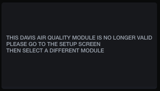

update Sunday removes Davis Air Quality module (large) due to unable to establish a standard format string from 4 different users at present is it basically user controlled and until an established correct way on how to use I have removed that option(with a message) and will return turn it at a later date..rain rate got its gradient back ..+40mm per hour or inch equivalent the gradient kicks in.
(*2nd Update for 4th October 13:12)
* Removes Davis Air Quality large module option too much uncertaintity on how it works with in meteobridge

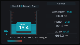

* Adds gradient to rain rate indicator blue to red pending on rain rate intensity
