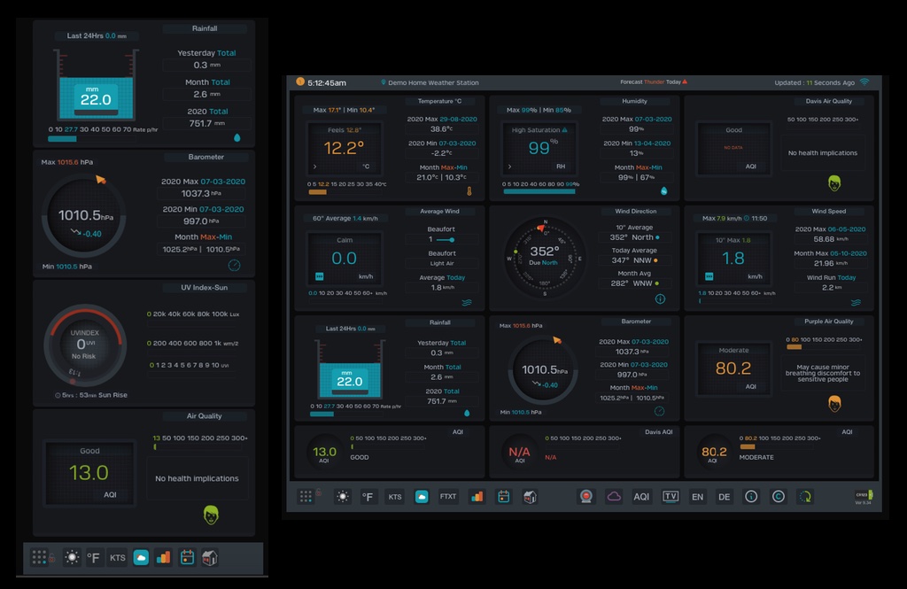

screenshots of Air Quality options...have a cool and a relaxing weekend ...

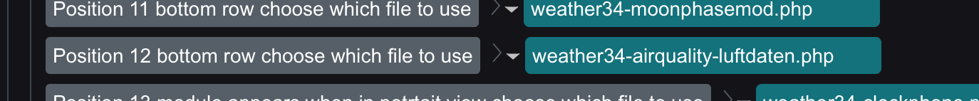

Luftdaten-Sensor don't work..
Post by xray77 »

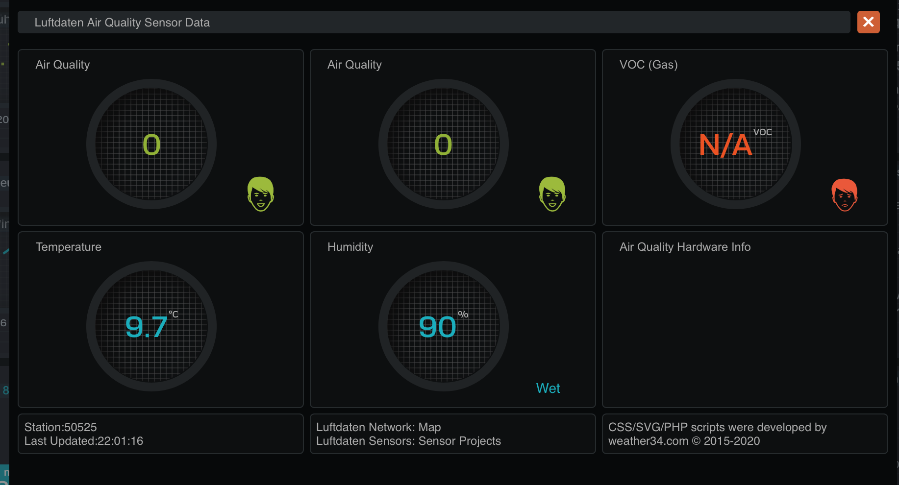

Hello, Brian,
Today I started using the Air-Quality Sensor from "Luftdaten.info" i.
particulate matter sensor SDS011
Sensor ID: 50525 (show on card)
Last update: 09.10.2020, 19:55:43
Fine dust 10 µm: 4.43 µg/m³
Fine dust 2.5 µm: 2.10 µg/m³
So it works and also sends data to the sensor network of "Luftdaten.info..
Only on your template it will not work.
Bildschirmfoto 2020-10-09 um 20.33.24.png (76.46 KiB) Viewed 4350 times
Bildschirmfoto 2020-10-09 um 20.33.13.png (48.02 KiB) Viewed 4350 times
Bildschirmfoto 2020-10-09 um 20.01.40.png (42.32 KiB) Viewed 4350 times
Bildschirmfoto 2020-10-09 um 20.01.28.png (289.41 KiB) Viewed 4350 times
What i have do wrong? Latest Update is installed (Oct 9, 2020)
In some other Templates (Leuuven, older W34 NANO SD-Template) it works fine with similar setup.
Have succesfully integrated the sensor to my MeteoBridge (additional Station #1), but with the airquality-mb-module it also don't work.. :-(
Thanks for your advice,
best regards

Good morning

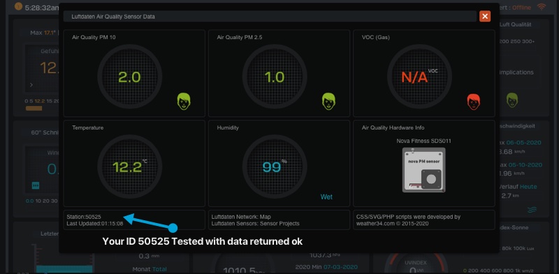

I just tested the luftdaten stuff with your ID 50525 in my demo and everything is fine. NO changes have been made to LUFTDATEN scripts for months however that said I don't use luftdaten but numerous users do but I have not seen any reports or issues raised for months last I recall was a API url change.
could be something as simple as a hidden space on the end of the ID in the setup , commonly happens when copy and paste is used .seen it numerous times with things like API keys etc ..
your data returned in the API call made this morning for demo stored in the file jsondata/luftdaten.txt
[{"sensordatavalues":[{"value":"2.10","value_type":"P1","id":4715340293},{"value":"0.57","value_type":"P2","id":4715340317}],"location":{"longitude":"9.66316223145","altitude":"13.2","country":"DE","latitude":"54.32018412738","exact_location":1,"id":36474,"indoor":0},"timestamp":"2020-10-10 05:17:33","sensor":{"sensor_type":{"manufacturer":"Nova Fitness","name":"SDS011","id":14},"pin":"1","id":[b]50525[/b]},"sampling_rate":null,"id":2183545621},{"sensordatavalues":[{"value":"1.63","value_type":"P1","id":4715292269},{"value":"0.90","value_type":"P2","id":4715292270}],"location":{"longitude":"9.66316223145","altitude":"13.2","country":"DE","latitude":"54.32018412738","exact_location":1,"id":36474,"indoor":0},"timestamp":"2020-10-10 05:15:08","sensor":{"sensor_type":{"manufacturer":"Nova Fitness","name":"SDS011","id":14},"pin":"1","id":50525},"sampling_rate":null,"id":2183523534}]
see also and live example https://www.ilfracombeweather.net/console/index.php that is using luftdaten for Air Quality
screenshot of data your data

I do not have the file "luftdaten.txt" in my json directory in the template on my server. I have also looked 10x in the setup, no spaces in the ID... What can I do now? Should I maybe download the last update again and have it installed, maybe something went wrong?
I'm a bit helpless :( , it seems as if a file in the template-folder is missing for execution?
i can retrieve the json-data from the sensor itself in my local network:
{"software_version": "NRZ-2020-129", "age":"73", "sensordatavalues":[{"value_type":"SDS_P1","value":"5.90"},{"value_type":"SDS_P2","value":"1.15"},{"value_type":"BME280_temperature","value":"7.89"},{"value_type":"BME280_pressure","value":"101340.47"},{"value_type":"BME280_humidity","value":"84.90"},{"value_type":"samples","value":"4330474"},{"value_type":"min_micro","value":"33"},{"value_type":"max_micro","value":"20073"},{"value_type":"signal","value":"-83"}]}
unfortunately also after the Update from 10.10.2020 it don't works for me :-(

think your answered your own question ..file doesnt exists .. either create an empty file called luftdaten.txt or check server config for creating a file that doesnt exist. stationcron.php is the primary file for calling external api data. todays update does nothing for luftdaten data it just fixes an alignment in german sunrise,set .. you need to create the file luftdaten.txt and wait for the stationcron.php to run then you will be ok.

Now I copied an empty "luftdaten.txt" into the jsondata directory on my server. I'm curious if it will work after the next call of stationcron. 8)
