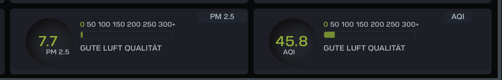

weatherist34 wrote: Mon Oct 12, 2020 1:57 pm sorry but i dont know anymore fed up with all this aqi stuff its very confusing..{..}
Hello Brian,
I hope you didn't take this as criticism, I am absolutely satisfied with the W34 template. I simply noticed that the Davis module only displays the pure sensor values and not the AQI calculation. Therefore, the easiest way would be to not use "AQI" as a headline and description, but the sensor value. For example "PM 25" or maybe just "sensor value". That way you would clarify that that number is indeed just the sensor value, which would solve the problem on an international level. Because why give yourself the headache, receiving emails from all over the world about a value your Davis module is not even displaying. The AQI is a calculated index after all.
The Leuven-template is running with the AQ-sensor as well. It actually gives me a different AQI-index than the value calculated here with the MeteoBridge module... It's confusing, but the value in the MeteoBridge module is at least close to the value which is shown at Luftdaten.info as "American AQI index". So the calculation in your template seems to be similar to the one there.
My statement is not to be understood as criticism, but only as a hint!
Best regards
Mike

Re: Weather34 TEMPLATE
Post by xray77 »
Okay, I'll take note of that. Changed it for me now (are only two tiny changes in the php file), I'm satisfied with that.

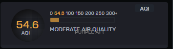

Regarding the Purple Air VOC, I did some research on the BME680 Bosch sensor that is used. Keeping it simple (3 colors) :D - it looks like their scale would match up like this:
if($aqiweather["voc"] >=201){ echo "<red>".$aqiweather["voc"]."</red>";}
else if($aqiweather["voc"] >=101){ echo "<yellow>".$aqiweather["voc"]."</yellow>";}
else if($aqiweather["voc"] >0){ echo "<green>".$aqiweather["voc"]."</green>";}
I made an adjustment in my hardware - the sensor chip placement was restricting airflow and inflating the values.

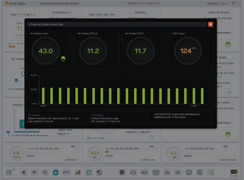

a work in progress for Davis Airlink or Purple Air popups please note work in progress a release including Lufdaten/MB assigned to position 175 support will come when this is found to be stable/manageable enough across all user configuration possibilities .
as it as always been since day one in 2018 for purple air AQI US !!! charts are dummy data as ive only just started collecting 10 min data for charts . as above work in progress with a few beta testers to get the right balance.

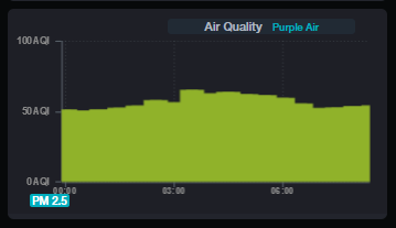

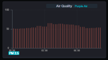

I see you are working on ID's and charts. Those will be great additions. :D . As usual, Chrome and Firefox want to create a slight alignment issue. I also have a few screen shots to show the scaling on the charts, before and after, for your info.
Before
After
Take care,
ok chuck just pushed ff alignment and column bar width for chart .
graham its logical to use phrases but to me its one less thing to worry about in terms of translations at present , first thing establish an happy medium make it universal then add on the extras but chuck highlights different practices , use of actual figure , average period figure and so on ive seen all these and yet to fathom out how to determine what one is actually using..
