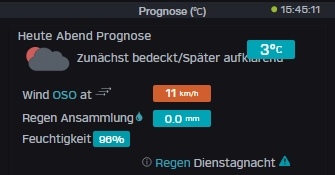

Small glitches in german:
ToTo wrote: Fri Nov 22, 2019 4:26 pm Everything is much better to read for me, thanks for the new font! :D
Many thanks for that!
ok toto i wouldnt have seen that has that is generated from the wu german forecast periodically not sure i can do anything as a quick fix but perhaps tomorrow my new SSD drive arrived yesterday so i will try and replicate on a decent desktop environment. glad you found the font change somewhat better not perfect but a step in the right direction.

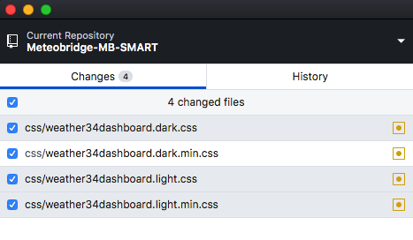

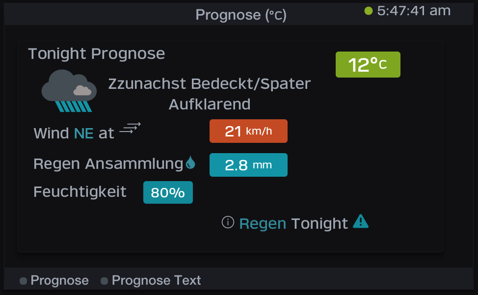

somewhat easier than I thought see screenshot replicated some German from your screenshot
just take the four css files from the GitHub repo https://github.com/weather34/Meteobridge-MB-SMART shown in screenshot

weatherist34 wrote: Fri Nov 22, 2019 7:01 pm somewhat easier than I thought see screenshot replicated some German from your screenshot
the change of css files fixes the problem with the text overlay
Thanks :mrgreen:

I uploaded 4 new css files this morning just to polish off the alignments in languages other than English . see screenshot in German.
why 4 css files? 2 are minified as now approaching target of January for a full release where the MB-SMART update will be frequently used .minified files reduce server load however those that like modifying the template in some way can always use the two non minified css files . changing the code in the index.php screenshot highlights and code
