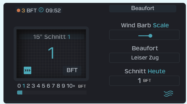

I still have a little question ???
what does this mean in line 15'' <realfeel><?php echo '15" '. $lang['Average']." "; [/color]??? from the PHP file beaufortmod.php
The meaning of 15'' is not clear to me...
Okay, I was thinking?
Could it be that we're talking about a 15-minute average?
Re: Weather34 TEMPLATE
in the module it actually is minutes " but I wasn't too happy with that but sometimes messing around with design multiple languages is a nightmare so sometimes I look for a simple way out ..so it will become this ..too tired to update page and download tonight so will do it in the morning ..

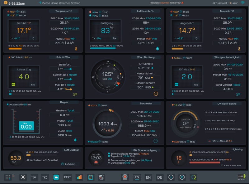

a small question is the current update 27-10-2020-Final-34z- the final status ? :D :D
Or will you get a last one today which reflects the state of your screenshot Mon Oct 26, 2020 9:02 pm ?? :D :D

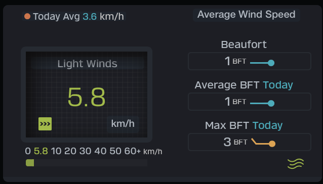

i have a final question about the date my wind scale looks like this ....
but your display looks completely different if I do something wrong while updating the template ???
