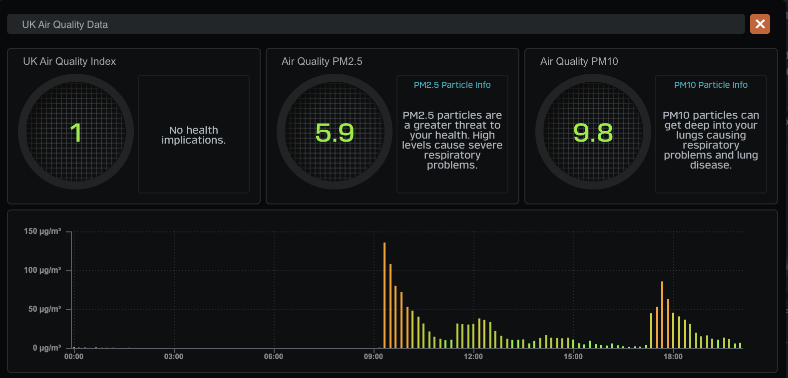

Brian, thought I'd provide this to see if you wanted it for a future update.
I've updated the AQI chart display to colour each data point in the chart according to the AQI
Screenshot 2020-10-27 at 27 October 2020 20.06.41 pm.png (177.96 KiB) Viewed 7700 times
I added a chunk of function code to todayairqualitychart.php to assign (my UK) AQI colours to each datapoint based on the AQI value.

Call it an atonement for bugging you about AQI.
Ps. Ignore the fact that I convert the data to use PM2.5 values rather than AQI for my table. The code will work with the original AQI plotting.
Regards
Jason

weatherist34
Platinum Boarder
Platinum Boarder
Posts: 1824
Joined: Tue Mar 28, 2017 6:57 am
Re: Weather34 TEMPLATE
Post by weatherist34 »
really good Jason im using this

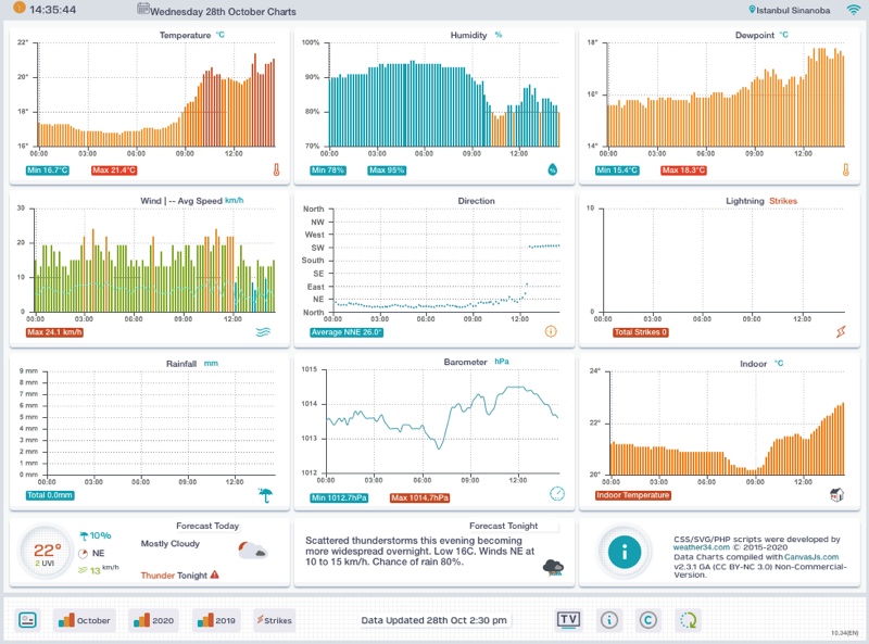

something similar and slowly implementing that into other charts based on temperature and wind speed but got so bogged down with other stuff it never made it . so if it works for you then go for it...
Im not doing any more for a while and next release version 10 made the tough call it will be English only I no longer have the will or enthusiasm for creating a multiple language supported template it just really restricts or add so much time to implement an idea and your solution is a prime example of a great idea amongst others I got via email in recent weeks but too much time bogged sown with other issues etc...
good job..Brian
Screenshot at Oct 28 00-02-24.png (78.88 KiB) Viewed 7696 times
