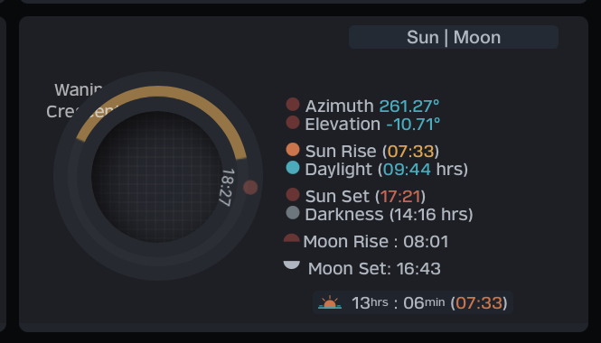

but if your brave find this line in the related moon modules just remove the decimal .1
//jday = J0 + 28 * phase + Math.floor(F);
jday = J0 + 28.1 * phase + Math.floor(F);
change to
The problem with the Sun/Moon module is unfortunately still present, even in Aurora MkII, as I just tested.

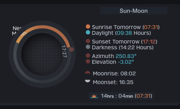

Re: Weather34 TEMPLATE
find the lines in moon related files ..
return ((this / 86400000) - (this.getTimezoneOffset() / 1440) + 2440586.7999)};
change to
return ((this / 86400000) - (this.getTimezoneOffset() / 1440) + 2440587.5)};
applied to update just now..Brian
Posts: 259
Fixed, thank you very much!

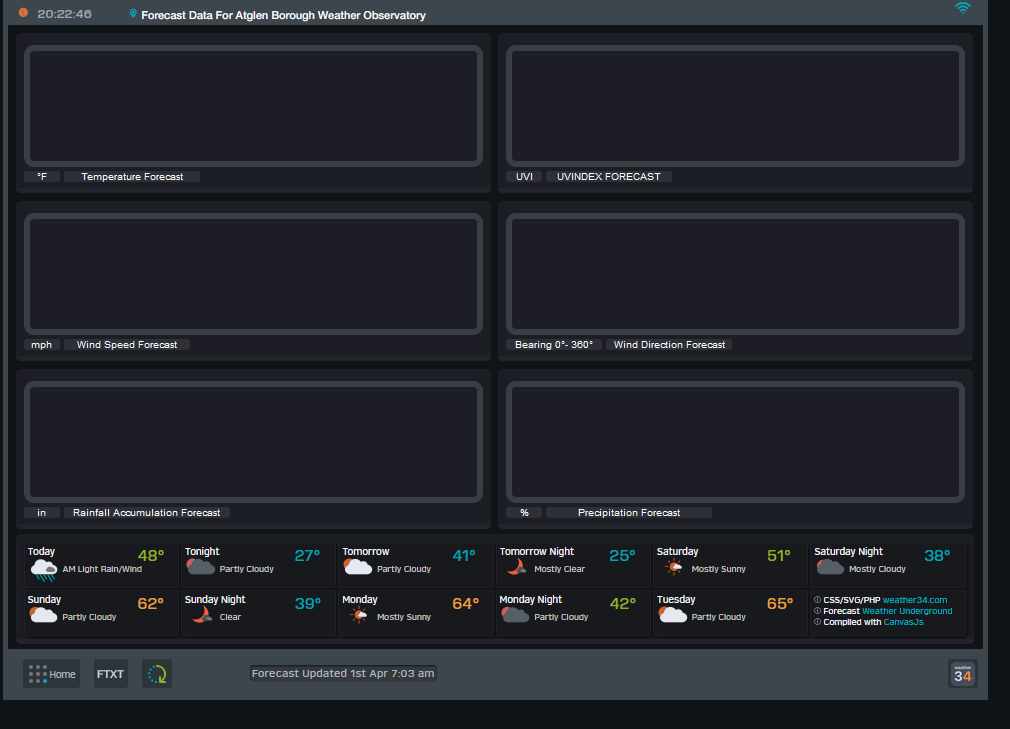

What would cause the top portion of my 5 day forecast to be blank? https://www.atglenweather.com/console/index.php
Screenshot 2021-04-01 082302.png (60.59 KiB) Viewed 9510 times
Posts: 259
You are using the new Aurora version, this topic is about the older template. This is about the new version:
viewtopic.php?t=15243&start=615
I had the same problem, you still need to apply the latest update from 25.03.2021:
