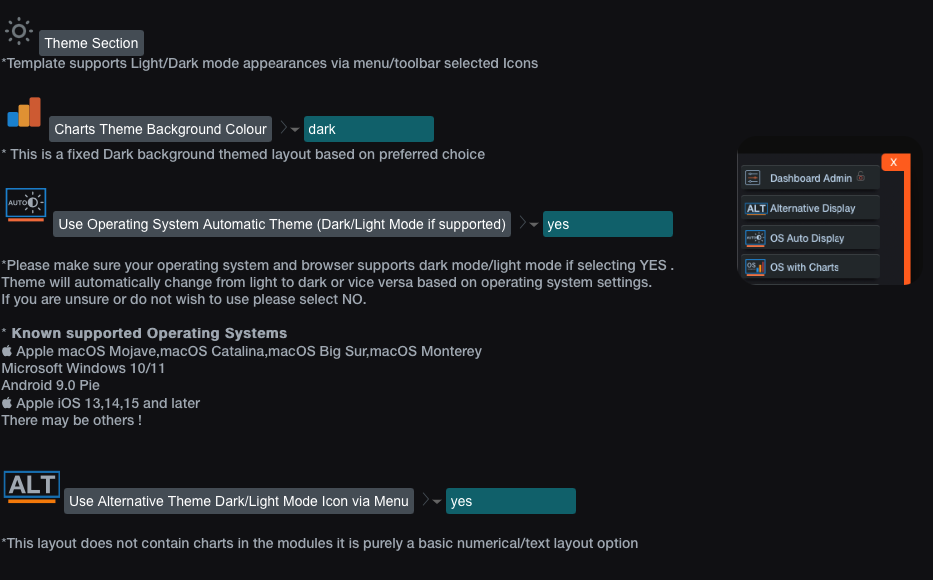

in the update there are new options to set in the setup screen to choose what layouts you would like to use .so please set those options according to your preference .screenshot below .
Change Log 23rd October 2021
* (09:56) * Contains all features/fixes from Oct 1st to Oct 23rd
* (09:56) * Requires Meteobridge firmware (6th Oct or later)
* (09:56) * Requires to ** setup new setup screen options
* (09:56) * Adds new theme layout options to setup screen
* (09:56) * Cleans up forecast page code
* (09:56) * Removes unused SVG images from AQI folder
* (09:56) * Adjust humidity color code in charts
* (09:56) ** mmHG *** modules require the setup screen option !!
* (09:56) * NAG screen is removed supports standard configuration !!

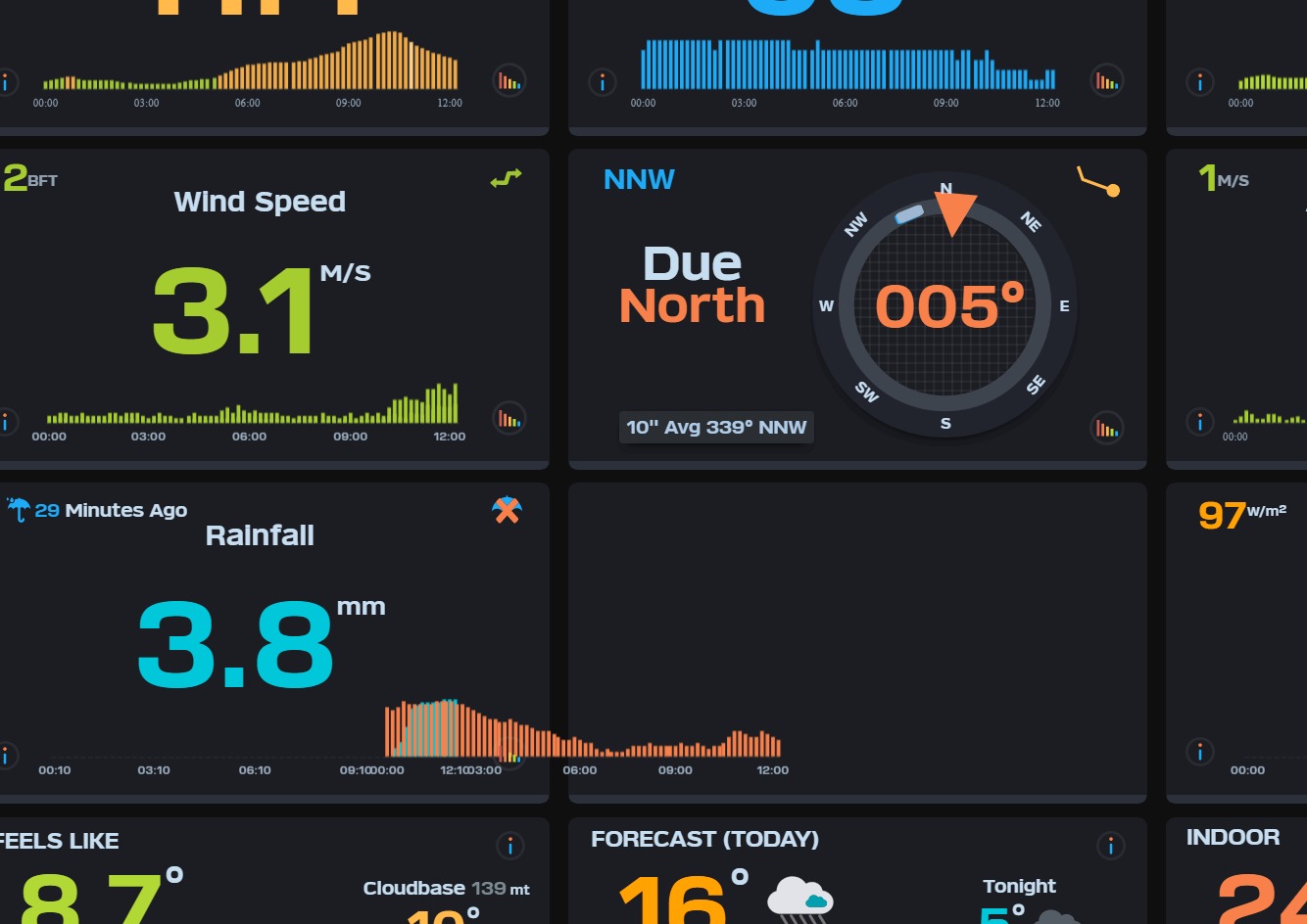

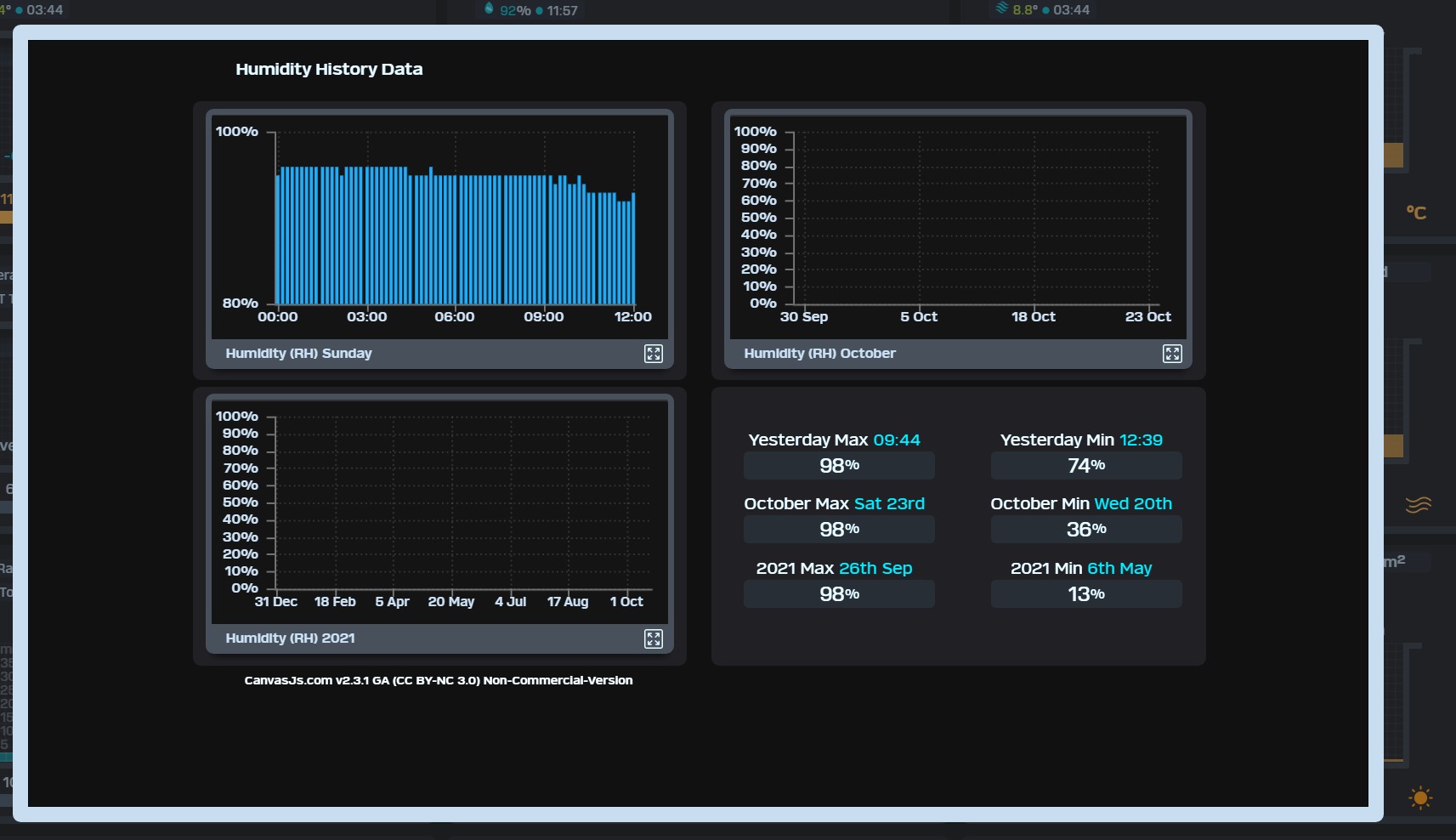

Here I noticed a couple of "oddities": in the attached screenshot, the humidity history for the month and year disappeared; if you select the rain history for 2021 with an increase (use zoom), as in the second attached pic, you can see that it repeats twice.

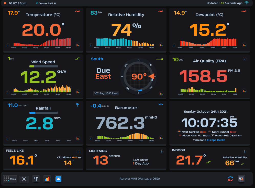

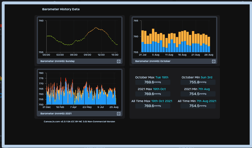

Well, as a "sore point" for me personally: for the page https://xn--10-6kcwaznenhomt1p.xn--p1ai ... tablet.php when the "Use fixed mmHg Barometer module" option is enabled in the settings, this is the story as in the third screenshot.

hi Alex I can not reproduce error you see for mmHG ..this has always been problematic for as long as it has been there so its time to remove the mmHG feature .im so sorry but Im at a loss because as you can see it works for me .
I have fixed the rain/humidity in charts my error oversight on position of humidity ..

Thank you, Brian, for responding so quickly. It's really strange that it works like this for me,
although I've tried it on different devices (iPad, Iphone 12, PC with win 10...). So maybe
you won't completely remove mmHg after all? At least leaving everything as it is? A lot of
work has been done on the implementation of this unit of measurement. In addition, everything
works fine in the Aurora MKII (Vantage-ALT) and in the observation history.

hi alex i dont know the answer or have a solution.. it works for me using that option . so i simply have run out of ideas to find a smooth solution without hardcoding which i dont want todo in anyway because updates will simply break it. so last idea send me your setup screen password via pm you can change at anytime. thats all i can do to perhaps compare with what i have set ..brian

I took a look at your settings I see nothing wrong , but I can see it now in the browser resource error log and I think Josep may have mentioned this about mmHG case sensitive . when I checked your site it returned a 404 for the mmHg file .so the file was there but your server is case sensitive so it needs to be exact . so please download the update again and run it I have just applied the fix. say thanks to Josep not me has I misunderstood what he was raising a week or so ago ..alexeysailman wrote: Sun Oct 24, 2021 1:06 pm Thank you, Brian, for responding so quickly. It's really strange that it works like this for me,

Everything is fine, except that the link to the barometer data history page "broke" when you click on the "CHART DATA" button (this applies only to the page weather34-os2-tablet.php ).
I repeat once again: I hope that you, Brian, will change your decision on "...delete the mmHg function.".
- Posts: 1824
alexeysailman wrote: Sun Oct 24, 2021 2:17 pm Everything is fine, except that the link to the barometer data history page "broke" when you click on the "CHART DATA" button (this applies only to the page weather34-os2-tablet.php ).
I repeat once again: I hope that you, Brian, will change your decision on "...delete the mmHg function.".![]()
Alex your server is case sensitive !! you can disable this in htaccess but I'm not going to publish how to do that as that's a recipe for those unfamiliar with htaccess to break servers/configurations. do a google search will probably return numerous ways ..
can you just re download the update AGAIN and run it ..please I hope this resolves mmHg because its hard to fathom out all these various requirements ..
alexeysailman
- Expert Boarder
- Posts: 87
Thank you so much, Brian, for your patience! Everything works fine!

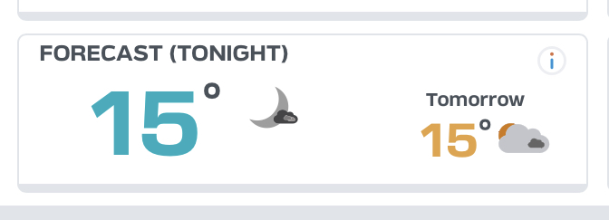

Small mistake.
On the alternative and OS display there is a mistake about forecast.
The actual forecast is the same for the forecast of tomorrow.
- B437F10F-2FF5-408D-A920-4E23C7994910.jpeg (59.02 KiB) Viewed 5763 times
- Posts: 1824
Hi Lorenzo
was fixed late last night so 25th update should be fine now . in short localized problem the master folder became corrupted , however thankfully due to auto hourly time machine backups I was able to restore with ease.

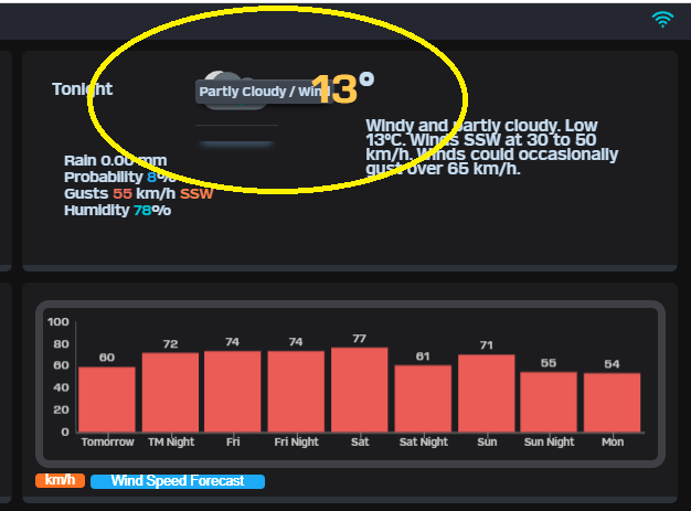

- jmontamat
- Posts: 267
- Location: Barcelona Spain
Hi Brian, it would be possible to correct this transparency.
- Sin título.png (34.05 KiB) Viewed 5665 times
- jmontamat
- Posts: 267
Solved !!!
Tnx.
