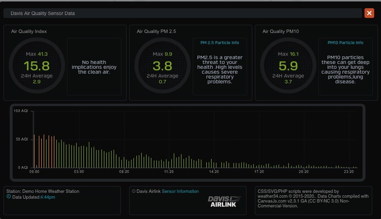

@Graham ok added on 24 hour average for Davis PM10 also added day max values see screenshot below .via simple update(yes double checked for year/month files are not present in the update )
corrected the rounding of PM10 example 10.21 is now 10.2

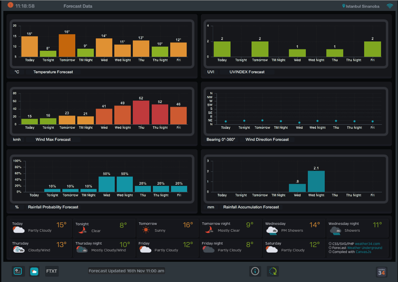

yeah thats what my wife sez :-) also changed the thunderstorm forecast to wind direction scatter plot in the charts . think the thunderstorm and snowfall Im going to have to come up with a seasonal option..no point in snow during summer but thunder is more apparent during the warmer months though we do get snow thunder here .. anyway thats it for today ...

Hi Brian
Before you open that bottle of wine
http://ringwoodweather.ddns.net/Aurora/ ... recast.php
Graham
woolfg
Posts: 165
Post by woolfg »
Brian
Sorted - I had to do a manual update of the forecastcharts folder, for some reason not all the files went over
Anyway you can open that bottle now
Graham

The new forecast charts are looking Excellent ..

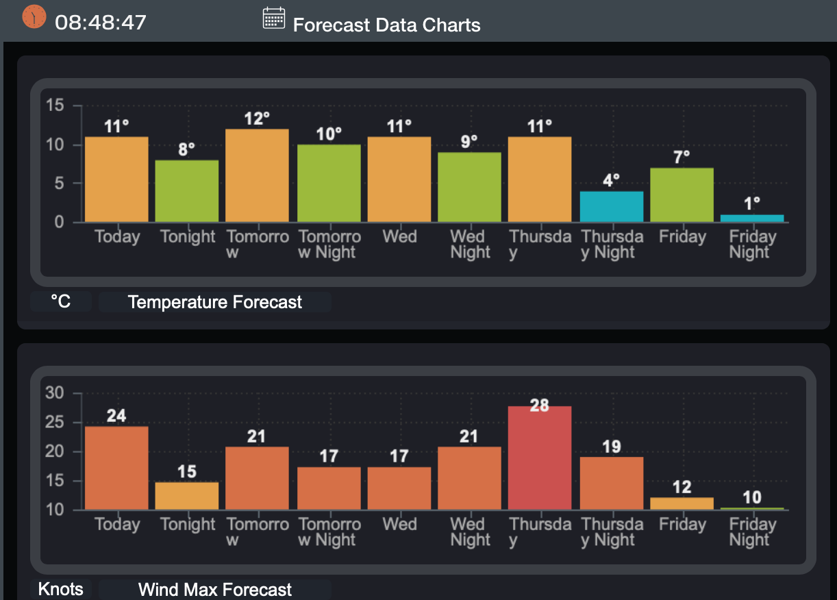

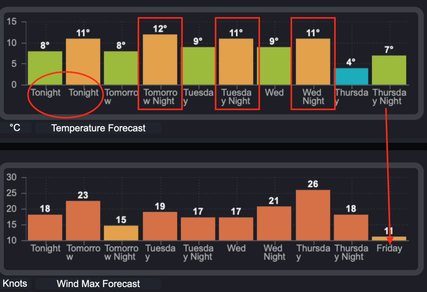

I suspect that the temperature forecast map is not in phase with the other forecast maps, which go from tonight to Friday. You can also see it in the maximum temperatures, which would therefore always occur at night. Also there seems to be a little font-alignment-problem.. (only in Safari, on firefox it's looking ok).

xray77

Good Morning,
I was probably too impatient :-) This morning the data's match... Let's wait and see.
Brian: Great work, it look's very nice! :-) :-)

good morning i have made some changes to alignment for day/night phrase , also addressed the anomaly in forecast temp .i have seen this before a year or so ago ..think i have fixed that..note the word think... :shock:
as always do a backup but once again file update was double checked..

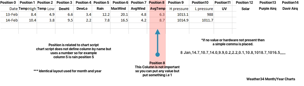

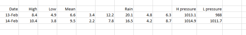

Looking to add missing 2 months from beginning of year not sure what the missing tabs are in screen shot
Excel layout.png (5.52 KiB) Viewed 4601 times
this should hep you ..
position 8 will be used eventually for wind direction when I get the chance to do it ..for now it has day average temp but its not actually used in any charts so don't pay too much attention to that just put 1 or some value
*important the wind values are ms default output from meteobridge. the charts script converts them to user choice when displayed .

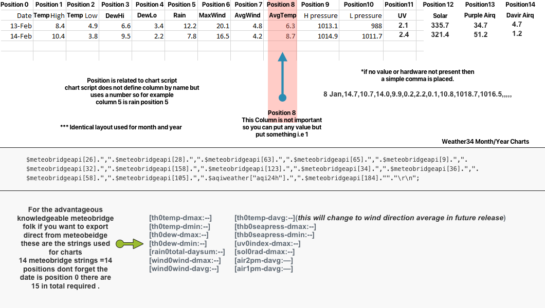

a bit more info might be useful for the advantageous amongst us :-) but if you want to understand the use of exporting direct from meteobridge please open up a new thread or discuss in an existing thread , Im not the expert in explaining things clearly.
to me I just do it but I dont know how to put that into a useable "how todo" so please do digest this forum for answers ...
export direct from meteobridge but consider the date must be in the first column of the csv file
[th0temp-dmax:--] [th0temp-dmin:--] [th0dew-dmax:--] [th0dew-dmin:--] [rain0total-daysum:--] [wind0wind-dmax:--] [wind0wind-davg:--]
[th0temp-davg:--][thb0seapress-dmax:--][thb0seapress-dmin:--] [uv0index-dmax:--] [sol0rad-dmax:--] [air2pm-davg:—][air1pm-davg:—]
