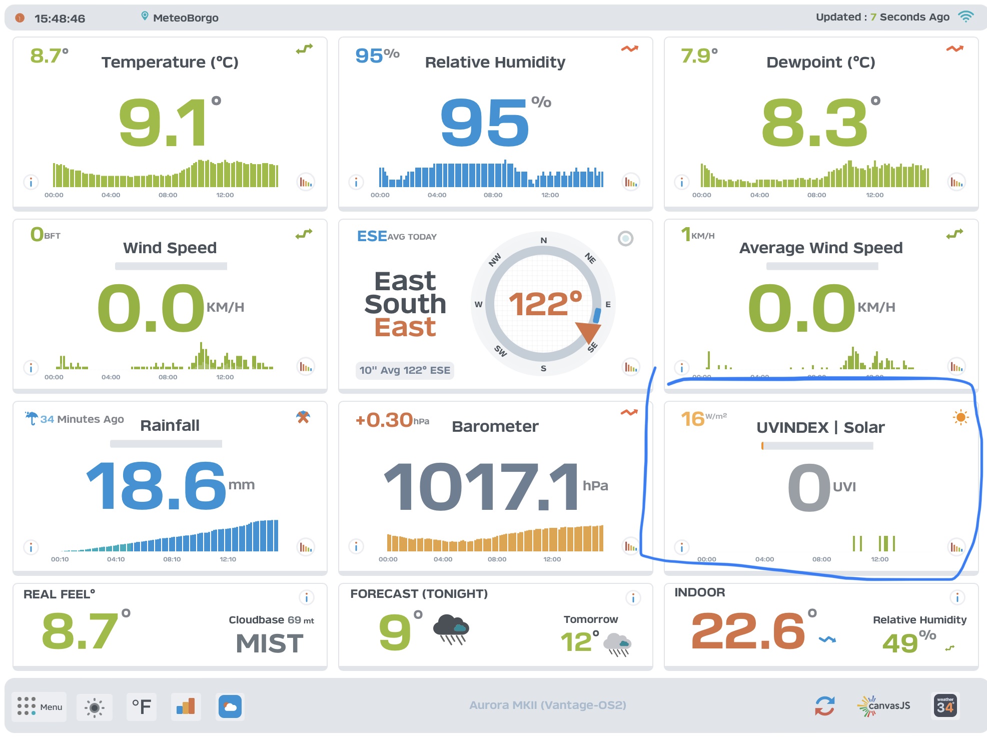

Hello.
Is it possible to have solar radiation here instead of UVINDEX?

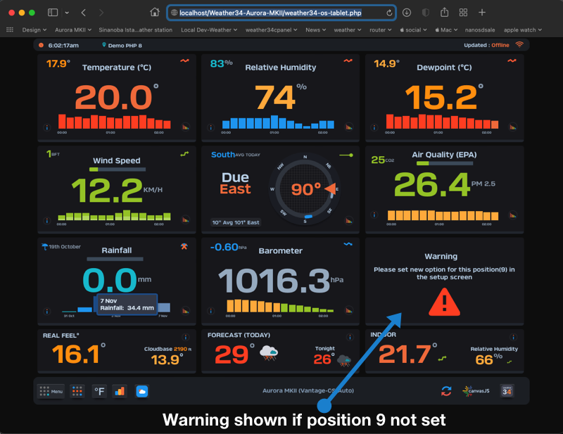

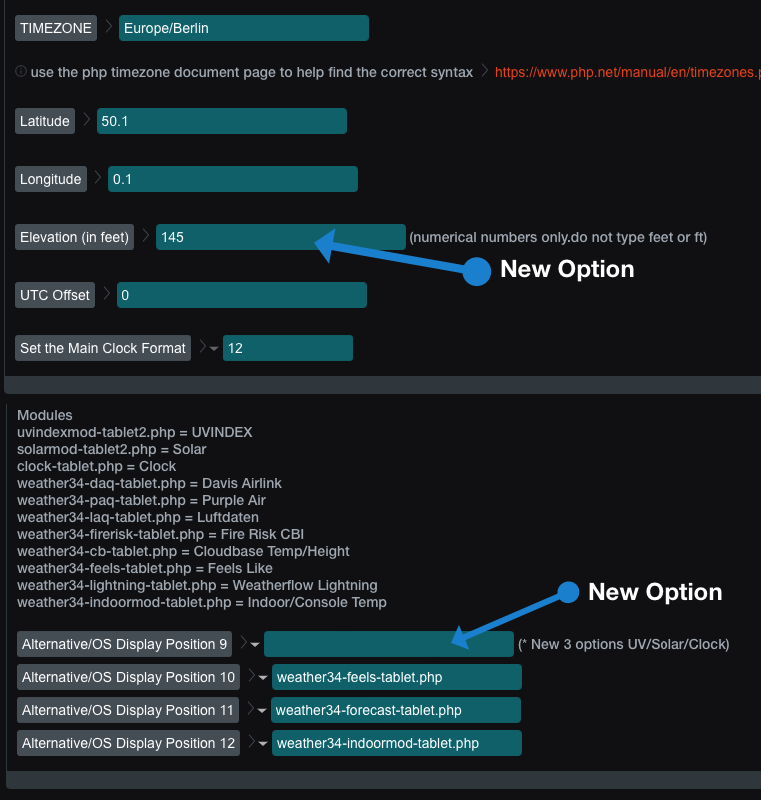

@Josep @Lorenzo
sorry its a short response but both requests added .
Change Log 15th November 2021
* (10:20) * Contains all features/fixes from Oct 1st to Nov 15th
* (10:20) * Adds new setup screen option to set elevation (Ref Josep)
* (10:20) * Adds new setup screen option to set 9th position module (Ref Lorenzo)
* (10:20) * Adds warning module if position 9 not set in setup screen

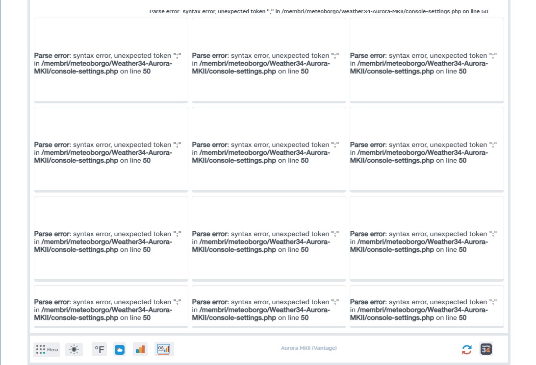

I have updated but there are these errors.
How can I do?
- Immagine 2021-11-15 084049.jpg (150.33 KiB) Viewed 6588 times

I solved.lorenz1982 wrote: Mon Nov 15, 2021 9:43 amThanks.weatherist34 wrote: Mon Nov 15, 2021 9:29 am @Josep @Lorenzo
How can I do?
I have edited "console-settings.php".

- Posts: 1824
as above Lorenzo set the elevation in the setup screen no need to edit files anyway you have it working but future reference if you see *new setup option mentioned in change log’s it means there is a new option to set.lorenz1982 wrote: Mon Nov 15, 2021 9:59 amI solved.lorenz1982 wrote: Mon Nov 15, 2021 9:43 amThanks.weatherist34 wrote: Mon Nov 15, 2021 9:29 am @Josep @Lorenzo
How can I do?
have a good week…brian
