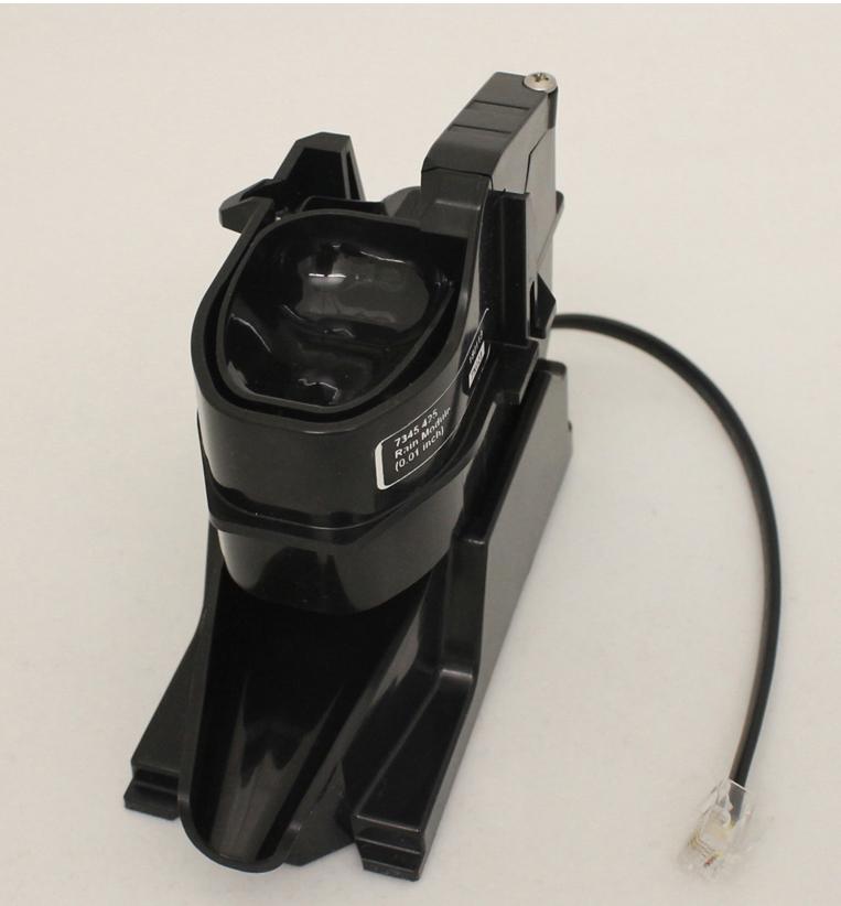

I have another question: maybe you, Brian or someone present made this upgrade: Vantage Pro2™ Complete Tune Up Kit? Here's what I'm talking about: https://www.davisinstruments.com/collec ... une-up-kit
As part of this upgrade, there is this "Rain Collection Spoon Upgrade Kit" (as in the picture in the attachment).
An oddity was noticed: subjectively, the amount of precipitation has become less and after the rain starts, the indication of its beginning appears with a delay of at least 5 minutes.
It is clear that my question can be addressed to another forum thread.
I need to find out the reason. Hence the question to Brian: is the indication of the beginning of rain in the template the same as at the station itself (Davis claims 20 seconds)? Or is it all because of the Rain Collection Spoon Upgrade Kit (The last question is not for Brian) :) ?
hello alex
i use the single spoon you highlight in the photo. all i can say is I find the single spoon better than the original dual spoon , i installed a CoCoRaHS some 4 feet away at same height as the davis ISS aprox 9ft above the ground concrete for comparison .. comparison of the two using the CoCoRaHS alongside is so marginal in difference its nothing worth worrying about some rain events the davis accumulated more by a 0.4mm some events the CoCoRaHS accumulated more by 0.2mm the difference is not worth losing any sleep over.
only advice i can give is insure the ISS is level , the single spoon is correctly installed and level in its position i.e all tabs are clipped in correctly. make sure your model is not calibrated for inches or you purchased a inches version,non metric.
i have installed two of these one in my neighbors recently who purchased a used vp2 from me a few months ago her readings though some aprox 500 meters away from me are again almost identical in every aspect , hers is at 12 feet to get over the hedgerow surrounding her back yard.
tipping events really depends on type of rain event obviously if its a downpour its almost instant if its light rain then tipping event is less frequent, i find the single spoon sensitive enough to even tip during long periods of dense fog , i.e we had a almost week long of fog with humidity at 100% for many hours per day and two 0.2mm events occured during that week .

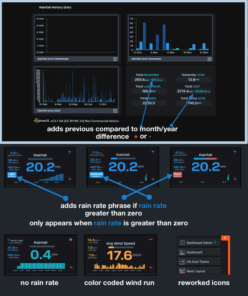

Change Log 24th November 2021 ** New features for OS Themes **
* (07:45) * Contains all features/fixes from Nov 1st to Nov 24th
* (07:45) * Adds difference previous month/year rain in info screen
* (07:45) * Minor css alignment change in pressure module
* (07:45) * Adds color coded wind run
* (07:45) * Adds rain rate phrase if greater than zero
* (07:45) * Reworks theme/layout icons

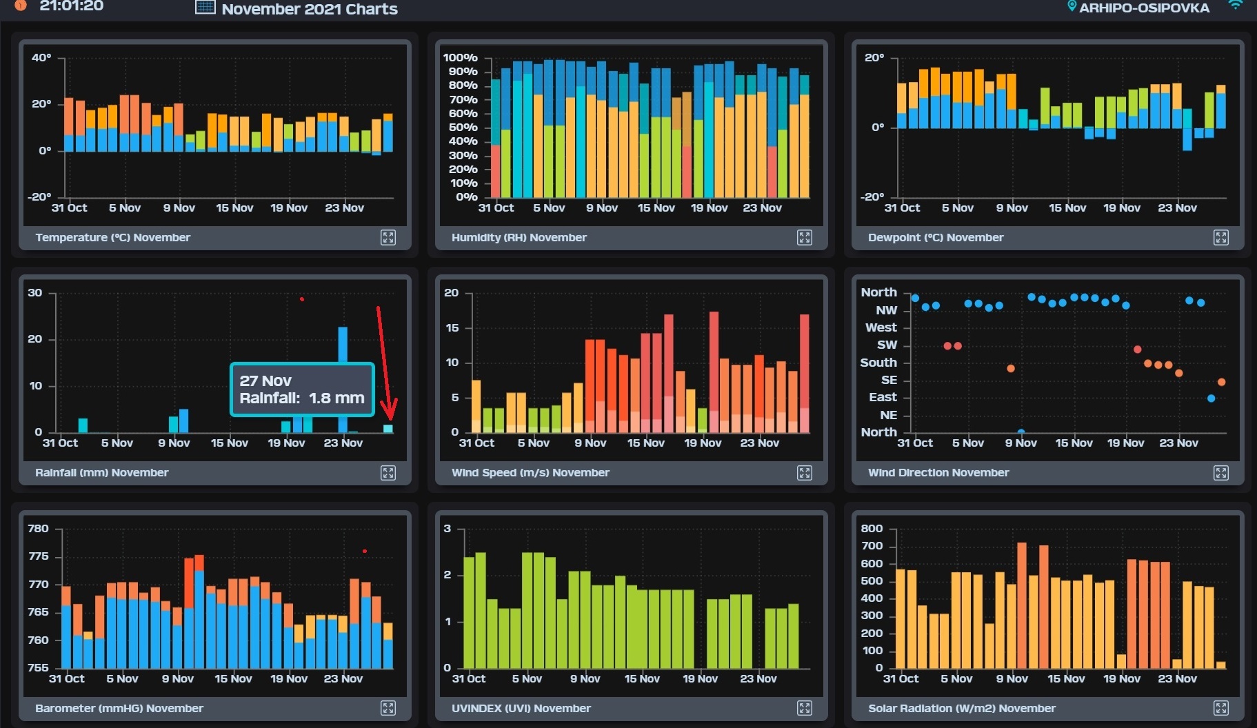

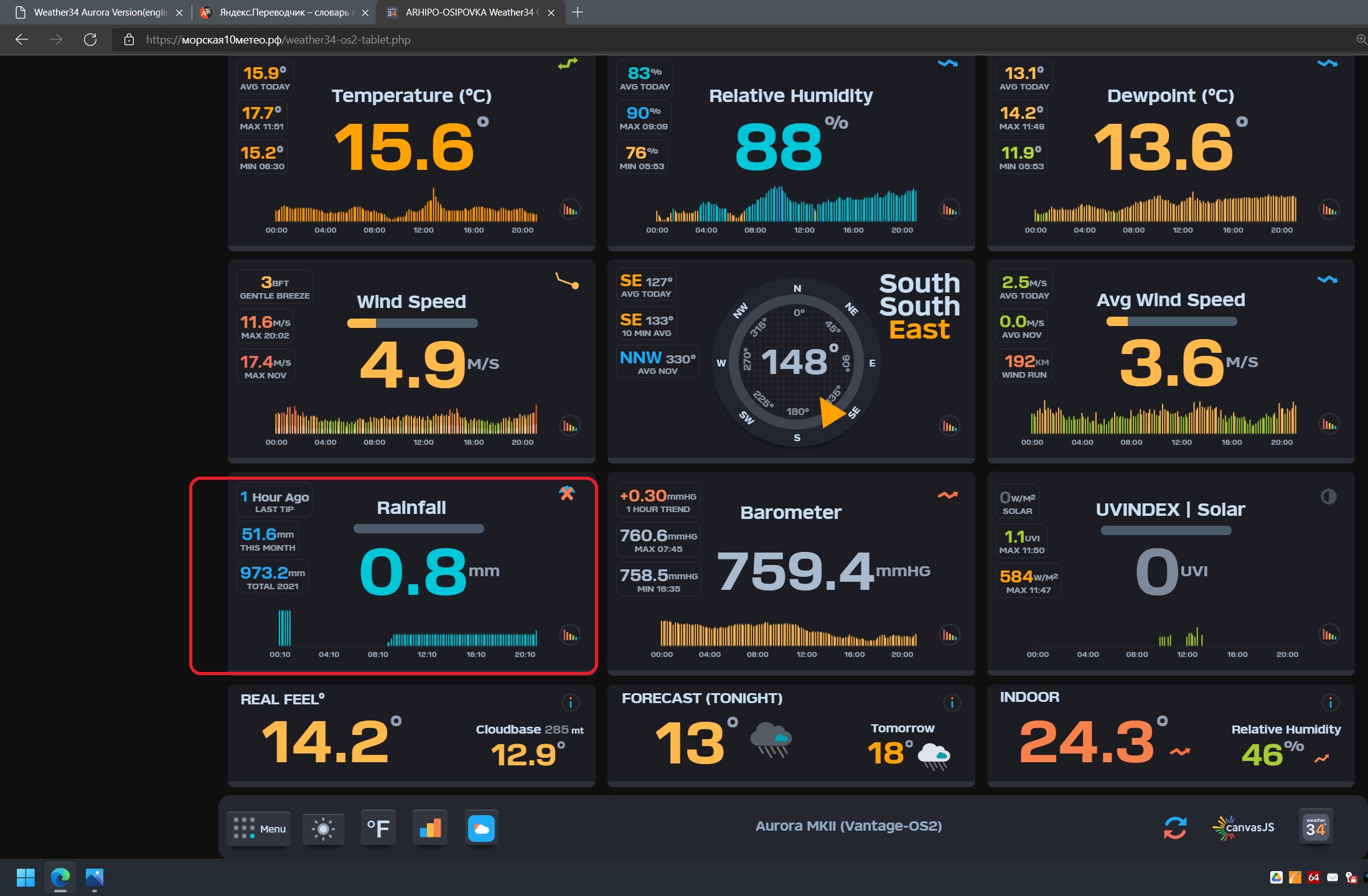

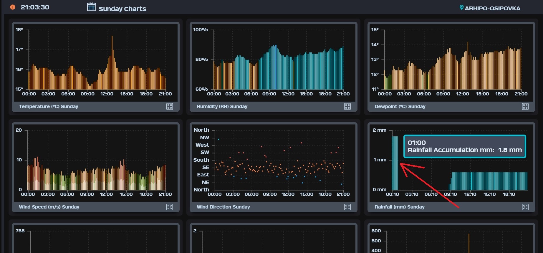

Hi Brian! I noticed this oddity: in the attached screenshot pic1 accumulated precipitation for yesterday in the amount of 1.8 mm, and if you look at the following picture, you can see how this figure "crawled" to today's day, although there was no rain at that time. And interestingly, in the third picture, these 1.8 mm and the actual amount of precipitation for today - 0.8 mm do not add up to each other...
alexeysailman wrote: Sun Nov 28, 2021 8:26 pm Hi Brian! I noticed this oddity: in the attached screenshot pic1 accumulated precipitation for yesterday in the amount of 1.8 mm, and if you look at the following picture, you can see how this figure "crawled" to today's day, although there was no rain at that time. And interestingly, in the third picture, these 1.8 mm and the actual amount of precipitation for today - 0.8 mm do not add up to each other...
good morning alex ..it means meteobridge is sending yesterdays value for short period after midnight. check timezone settings or server times .
looks as if your meteobridge or server is an hour out of sync .. you can see from your csv data there 1.8mm being sent upto 01:00
then from 01:10 it is 0.0 . indicates one hour difference .template only reads what is sent to the files .
https://xn--10-6kcwaznenhomt1p.xn--p1ai ... ov2021.csv
0 00:00 15.9 1014.2 1.8 0.0 8.0 2.7 0.0 12.3 0.0 126.0 24.0 43 28 Nov 14.4 -- 79 0.0
0 00:10 15.9 1014.1 1.8 0.0 8.5 2.7 0.0 11.9 0.0 161.0 24.1 43 28 Nov 14.6 -- 77 0.0
0 00:20 16.0 1014.2 1.8 0.0 8.0 2.3 0.0 11.8 0.0 139.0 24.2 43 28 Nov 15.3 -- 76 0.0
0 00:30 16.2 1014.1 1.8 0.0 8.5 3.1 0.0 11.8 0.0 123.0 24.2 42 28 Nov 14.9 -- 75 0.0
0 00:40 16.3 1014.1 1.8 0.0 8.5 3.4 0.0 11.9 0.0 306.0 24.1 42 28 Nov 14.7 -- 75 0.0
0 00:50 16.2 1014.0 1.8 0.0 7.6 2.8 0.0 12.0 0.0 158.0 24.1 42 28 Nov 14.9 -- 76 0.0
0 01:00 16.2 1013.6 1.8 0.0 10.7 4.5 0.0 12.0 0.0 146.0 24.2 42 28 Nov 14.3 -- 76 0.0
0 01:10 16.1 1013.9 0.0 0.0 10.7 3.2 0.0 12.3 0.0 169.0 24.2 42 28 Nov 14.3 -- 78 0.0
0 01:20 16.0 1013.9 0.0 0.0 8.0 3.5 0.0 12.6 0.0 165.0 24.2 42 28 Nov 14.9 -- 80 0.0
alexeysailman
Posts: 87
Post by alexeysailman »
Hi, Brian! I didn't think at all about time synchronization in the meteobridge settings, the local time really "moved out". Thank you, I will keep in mind for the future.
