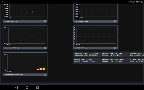

Good morning, any problem with
.grid-containercharts
on Samsung 16:9 tablet in all browsers.
https://meteosantgenis.org/MKII/
- Screenshot_20211105-092001.jpg (32.25 KiB) Viewed 6141 times

Hi Josep I can't reproduce this unless I use the zoom increase to 180% on my laptop ! are using a zoom increase ? I can't help much I don't own anything or have anything android etc apart from a Smart TV . no changes have been made to css in relation to charts I can recall.

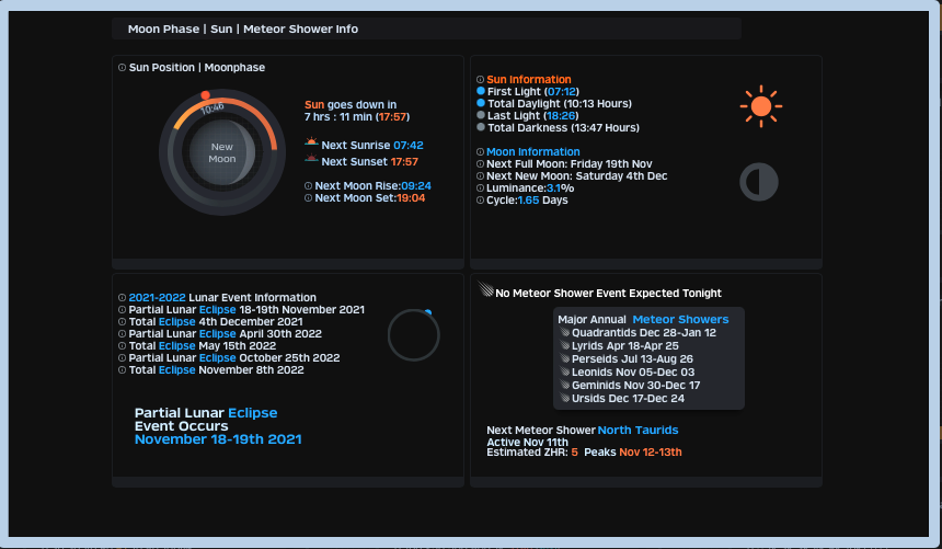

reworked consolidated sun/moon/meteor page which is accessible via single menu link or relevant sun module if in use
- consolidated.png (129.48 KiB) Viewed 6118 times

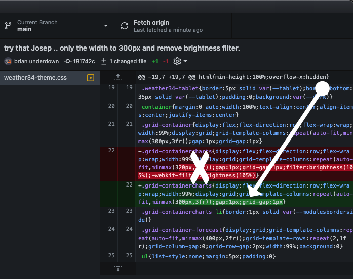

Hi Brian, in August it was working well, I have found some difference ...
.grid-containercharts{display:flex;flex-direction:row;flex-wrap:wrap;width:99%;display:grid;grid-template-columns:repeat(auto-fit,minmax(300px,3fr));gap:1px;grid-gap:1px;filter:brightness(105%);-webkit-filter:brightness(105%)}
- Posts: 1824
Josep try the file just pushed to GITHUB..Changed 320px to 300px

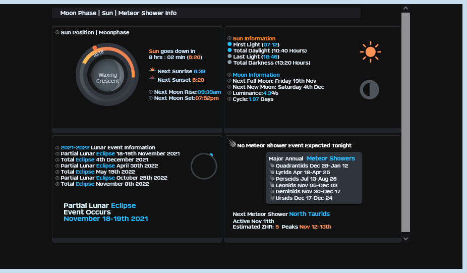

I just noticed that the new Sun|Moon update is showing an overflow in Firefox.
Good luck with the Booster and take care.
Hope all is well.

ok ill take a look shortly time to install firefox on laptopprestwickwx wrote: Sat Nov 06, 2021 4:22 pm Hi Brian,
Hope all is well.

All fixed
Best wishes,
All fixed
Best wishes,

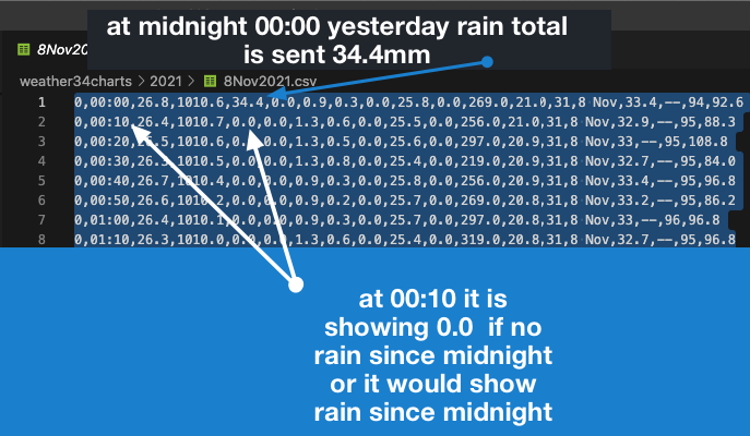

Just a curiosity, why does this happen at the beginning of the day the rain at xx: 10 and not xx: 00 ??
- Sin título.png (25.79 KiB) Viewed 6014 times

Hi Josep a solution was requested many months ago may be a year ago, Meteobridge itself at 00:00 sends previous day total at 00:10 previous day total does NOT get sent .jmontamat wrote: Mon Nov 08, 2021 1:00 pm Just a curiosity, why does this happen at the beginning of the day the rain at xx: 10 and not xx: 00 ??
So the rain day chart is compiled to ignore first line of day data at 00:00 .
if you had rain yesterday check your current day csv you will see a value at 00:00 and if rained yesterday(previous day) it will likely have that total value .it was very apparent on sites like lars in Singapore who can have upto 100-160mm regularly in a day this would throw out intervals for following day if they were zero or a less significant amount. remember csv file is only storing data Meteobridge sent at that specific time template doesn't manipulate the data.
example screenshot..in short the first 00:00 data line is ignored is rain day chart.
