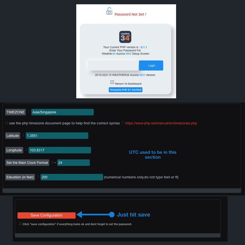

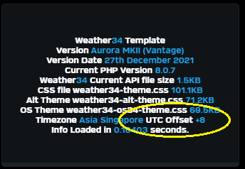

The update released on the 28th requires the setup screen to be run as discussed in recent threads.This is important !!! so please run the setup screen.
Change Log 28th December 2021 ** Requires to run setup screen **
* (10:42) * Contains all features/fixes from Nov 6th to December 28th
* (10:42) * Adds new UTC to automatically recognise DST Ref Josep
* (10:42) * Important run setup screen to clear existing UTC offset
* (10:42) * See screenshot below to clear existing UTC offset
* (10:42) * PHP 8.1.1 verified 22nd December
** 28th December 2021 Important please run the setup to clear existing
UTC setting screenshot shown below.
Clear UTC Screenshot
* Doing backups will preserve your chart data and settings in the event of
any problems.
* When new setup options are added ensure the settings file
(console-settings) is not locked with file permissions on your server.

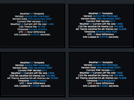

I have added this to control its proper functioning....
Good new year everyone.
- Sin título.png (16.98 KiB) Viewed 8461 times
- Posts: 1824
ok Josep nice touch added to GITHUB just now but not worth updating simple update as day is almost over it will confuse .jmontamat wrote: Tue Dec 28, 2021 4:07 pm I have added this to control its proper functioning....
blue for 0 or negative difference
red for positive or ahead

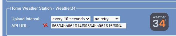

Hello thanks for the reply yea in my meteobridge it asks me for an API and i was not sure were to get that. From what i know my meteobridge is not using any api, it listens to my local network to capture the data coming in via UDP. Sorry for the dumb question Do i need my own website to run this or can i use the API from wunderground?

- Posts: 1824
good evening
yes you need a website and the API url is a domain url not an API key.
if you have a web site follow this guide https://weather34.com/homeweatherstatio ... guide.html
sorry doesnt use anything for weather station data from weather underground, all is used is the forecast but that itself will change in 2022 sometime.
brian..have a good day..

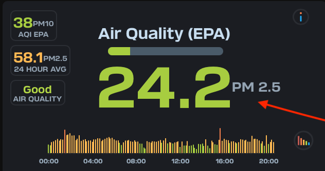

Good evening,
Why is there a difference in PM 2.5 and PM 2.5 in chart data (graphs).I can't find the info on the 2nd screenshot in the Davis Weatherlink data either.

Hi Bart,
That confused me, at first, as well. I think the 24.2 is the AQI (EPA) rating using PM2.5. The 20.6 is the actual PM2.5.

Hello, Chuck,
Yes, must be that, but it is somewhat confusing indeed. Quite apart from the fact that those measurements exist separately, especially in the utterance. not only here but also in other places, f.i. Davis. Cannot find it in the Meteobridge.
