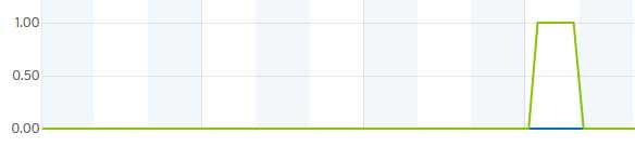

- I get this silly graph on WU, saying I got no rain at 1mm per hour.
- Clipboard02.jpg (3.6 KiB) Viewed 9996 times
- There has been a count, but it is not counted.
- Clipboard01.jpg (2.11 KiB) Viewed 9996 times
Re: Rain accum misses first count
Interesting, so you say it is a WMR200 only bug? That explains why I does not see it with my test rig.
