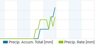

I've often wondered if it was correct, and low rain event recently have shown clearly that my uploads to WU are wrong in the rain accumulation.
Basically the first count does not affect the Accum figure, but does show up in the Rate.
First rain after a long time
Rain Data.jpg (5.94 KiB) Viewed 11281 times
This seems to happen when it has been a long time since any rain (not clear if it is after a re-boot).

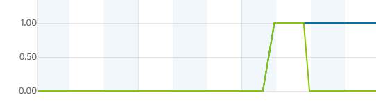

This time, in the next day, the data for another short burst of rain makes much more sense.
Rain burst next day
Rain burst next day
Rain Data2.jpg (4.3 KiB) Viewed 11281 times
Is this a recognised problem?? With MB or WU?

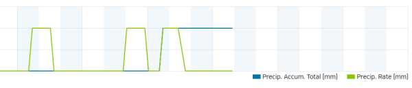

Well, it's been raining over the last week and the same problem occurs. If there is one count in a upload period the first one is counted for Rate purposes, but does not get counted in Accumulated.
Big rainfalls seem to work fine.
Today it was even worse, with slow rain showing a rainfall rate three times before there is any actual rain reported!
Rate but no Rain!
Rate but no Rain!
