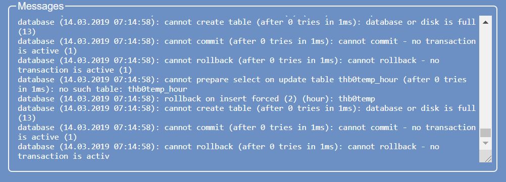

All has been well till Monday, then it started with the same problems as you guys are talking about on here. Disk full and no history etc. See attached.
I have contacted Davis instruments Australia and I am waiting for them to login to my unit and give me a report. The unit is only weeks old. I bought the unit believing that they were very reliable.

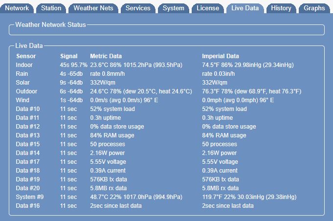

One thing I'm unsure about is the internal temperature of the Meteobridge unit at around +50ºC sometimes?
I have attached a clip of the live data showing the temp today.

As per Internal Box temperature of +50ºC that is fairly normal

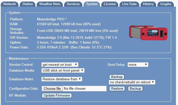

Please see the attached images.
- MB clip with internal usb.JPG (73.35 KiB) Viewed 5857 times
- MB clip with external usb.JPG (61.47 KiB) Viewed 5857 times
Re: Disk Full
Internal USB not even showing so would appear more than dead? External Verbatim will also have a limited life.
I would be replacing the internal, maybe first confirming what make it is but looks like you may have to pull the board out to check. Boris does have a video on how to replace the internal USB, first need to source an SLC USB of the right physical dimensions, really only needs to be 1Gb but you can get 2's I think? certainly 4Gb and 8Gb max, these are around $25-35/Gb.

Yes I would agree and only a few weeks old then one would not expect a USB issue? I would want to know how old that MB stock is and if the USB is Intenso or not?
Obviously as the front USB works and the Internal doesn't not then it is some form a USB issue? Something for Boris.

First inspection did indicate that it is a hardware issue around the internal USB hub. Sorry. You have a PM.
