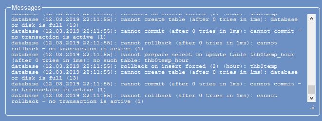

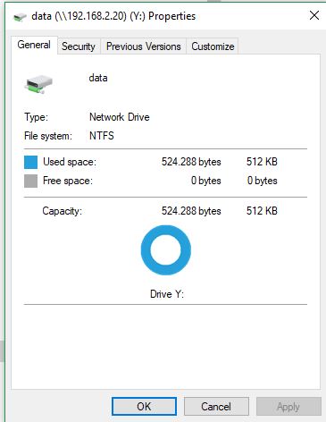

Hello, i got a disk full notification in pro-black today.
If I look at the share and it said only 512 k avalaible.
What are the option for checkking of the internal disk?
greets.
system-log
system-log
share properties
share properties
Posts: 1486
Re: Disk Full
That is the internal drive and it is full, all 512k of it, you need to do some data management and clean it out or replace it with a bigger capacity.
