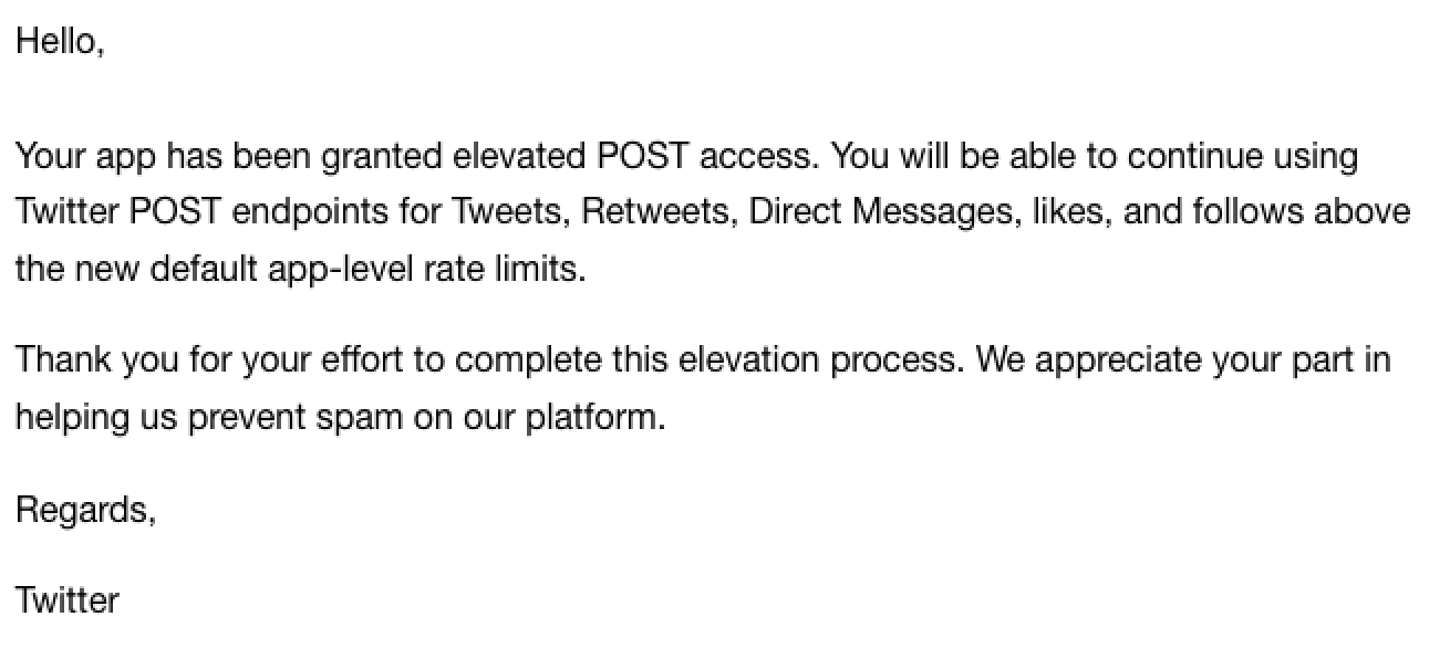

Solved! Twitter lifted the default tweet limits on apps for meteobridge :-)
Screenshot 2018-11-06 at 22.05.29.png (67.35 KiB) Viewed 4647 times

Great news, many thanks for everyone's replies and actions to resolve this issue. Paul @GuisboroughWx

Yes,yes,yes it works again. Thank you guys for all the
“complains” also on behalf of my Twitter followers .
Great work, appreciate it very much!
