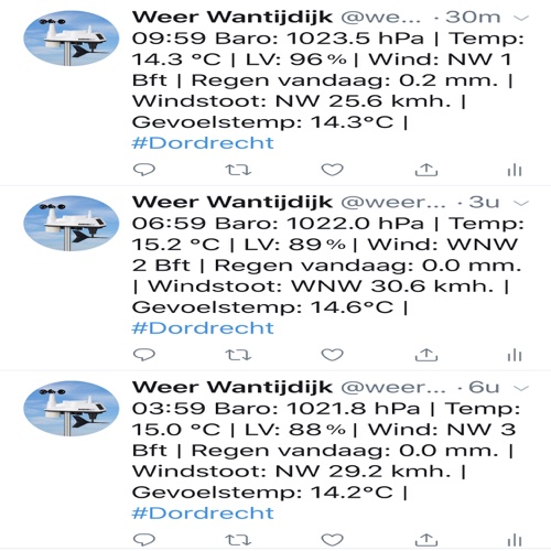

Since yesterday evening my hourly tweets aren’t sending every hour anymore, but every three hours now?? I’ve nothing changed, it just happened between 20.00-21.00 h. I’ve updated my MB pro today and still no fix. The test function is working normally; so I don’t have any options left. Please can someone look into that, thanks in advance.

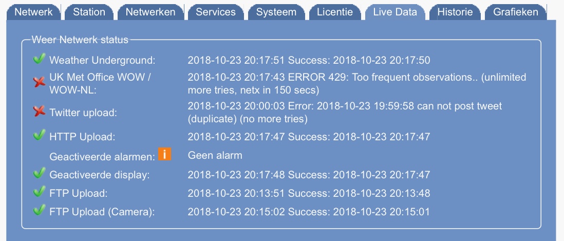

It looks like a problem with the services, see attachment. Maybe Boris can see what is wrong?
- AAD507E0-D3D4-46B8-988F-4F9087BBBE7B.jpeg (150.39 KiB) Viewed 6252 times
Re: Hourly tweet service isn’t working anymore
Those red crosses can mean successive tab changes between the services tab and other tabs (especially with WoW) as each time the unit will try and send the services, it is not necessarily a problem with the service/s.

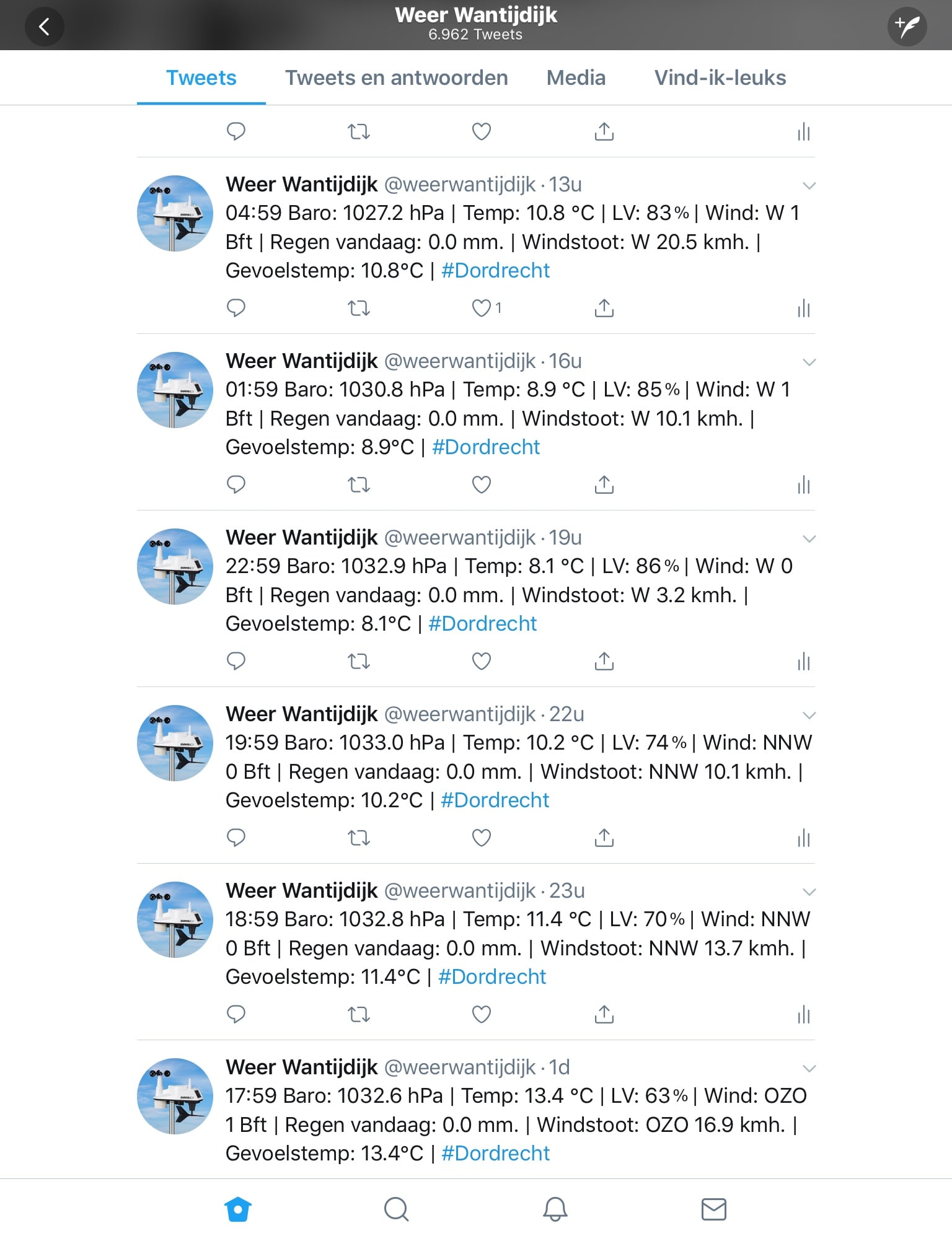

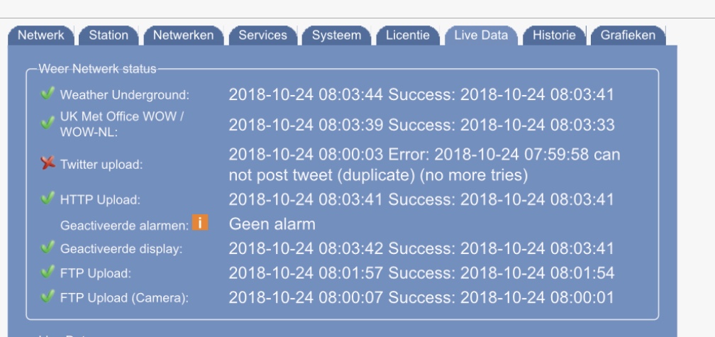

By the way, I tried testing this morning with the Twitter service and that didn’t work also; see the message in the attachment. It has something to do with duplicates
- C93D8223-D98E-466D-9DF9-E695694AAB92.jpeg (132.76 KiB) Viewed 6234 times
In the past to many twitter messages were so similar that it became "spamming your followers' timelines".
Since March 23 the ban on "duplicate" or "identical" tweets is even more strict. Also "very similar tweets" are now considered identical. So if the weather does not change that much in one hour, twitter rejects the tweet. This will happen more often in autumn and spring when the weather is almost identical from hour to hour.
Checking your weather history at https://www.wunderground.com/personal-w ... 76#history reveals that the one-hour tweets could have been considered "very similar".
Explanation here: https://www.boostability.com/twitter-cr ... ate-tweets
Or use Google with twitter refuses duplicate
Conclusion:
The red cross for WOW is already explained by Mattk, it will always be there when you have visited the "services" tab shortly before. There is no "conflict between Twitter service an the Wow updates" .
The duplicate problem is not a Meteobridge problem. And it will not go away as long as the weather does not change enough every hour.

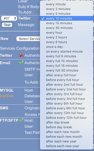

So, by making the posts less frequent should help with that theory? I was going to suggest a 3 hourly post then realised that isn't an option (only 2 or 6 hourly). I used to use WD and that was working up to 7 days ago. That also had the ability to post a second post daily for a forecast as well as hourly weather data.
Two and three hour periods will help, as @weerwantijdijk twitter list example the periods are not always every three hours, some two hour periods occur also. Maybe adding extra fields will help also.G4MHJ wrote: Wed Oct 24, 2018 10:00 am So, by making the posts less frequent should help with that theory? I was going to suggest a 3 hourly post then realised that isn't an option (only 2 or 6 hourly). I used to use WD and that was working up to 7 days ago. That also had the ability to post a second post daily for a forecast as well as hourly weather data.
One can select in the twitter pull down before/after: every full hour, every 2nd full hour, every 3rd full hour.
