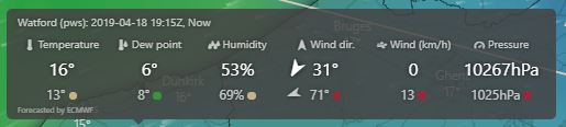

Nearly there, now a decimal point needed before the last digit in the pressure reading, or ditch the last digit.
Windy Readings 2.JPG (18.61 KiB) Viewed 583857 times

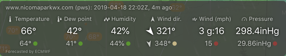

Hi Boris. Someone jus let me know of a misplaced period in the pressure reading in the Windy.com update addition you made today incase your not aware. Please see screenshot.
windy Screen Shot 2019-04-18 at 18.07.15.png (179.56 KiB) Viewed 583847 times

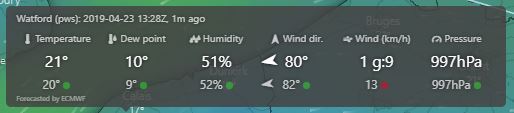

Great all seems to be working now (Windy in Weather Nets). I know this must seem obvious, but just wanted to check, in the image below under wind speed, the g:9 indicates the Gust speed?
Windy Readings 3.JPG (18.74 KiB) Viewed 583773 times

johnbowe wrote: Tue Apr 23, 2019 3:37 pm Great all seems to be working now (Windy in Weather Nets). I know this must seem obvious, but just wanted to check, in the image below under wind speed, the g:9 indicates the Gust speed?
Yes g:9 is your gusts for that moment that you have selected on the time scale. Also the green and blue marks indicated are winds and gusts also. Blue is less intense wind and green is stronger winds.
Windy Winds Data.png (36.96 KiB) Viewed 583771 times
