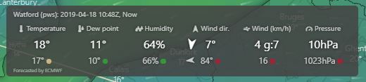

Post by johnbowe »
I just updated Meteobridge and Windy is now available under Weather Nets. Data is uploading, although I have noticed that under Wind there is an extra couple of digits showing up, presently wind speed is 4km/h, then it also shows g:7.
Pressure appears to be missing a couple of digits. Wind arrow appears to be pointing in the opposite direction - but I did notice this when added to Meteobridge manually under services. Maybe this is something I'm doing wrong.

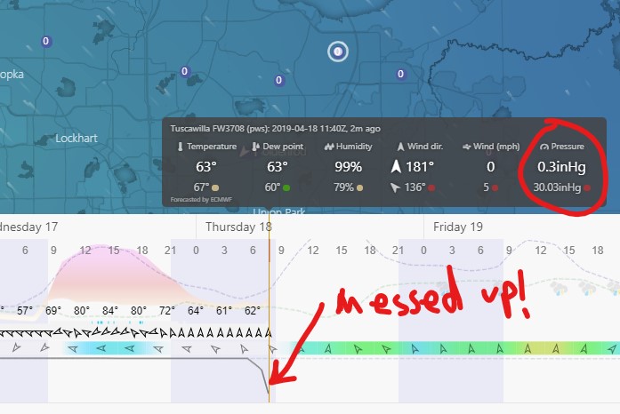

galfert
Posts: 326
Location: Orlando, FL
Re: Windy.com seeking input on developing API - Let's make Meteobridge first
Post by galfert »
Don't use this yet...it doesn't work right
UPDATE: Problem Fixed - see next post
This new update has a bug...well the bug isn't Meteobridge's fault. The problem is that Windy does not accept hPa. It only accepts Pa and that is why the pressure reading if off by a few decimal places. I would recommend for now that the Meteobridge send inHg instead to Windy as that is working correctly. To do this now you can use the manual HTTP upload method describe earlier in this thread (using inHg instead) or wait till the Meteobridge is updated to work around this Windy issue.
