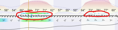

Great all seems to be working now (Windy in Weather Nets). I know this must seem obvious, but just wanted to check, in the image below under wind speed, the g:9 indicates the Gust speed?

johnbowe wrote: Tue Apr 23, 2019 3:37 pm Great all seems to be working now (Windy in Weather Nets). I know this must seem obvious, but just wanted to check, in the image below under wind speed, the g:9 indicates the Gust speed?
Yes g:9 is your gusts for that moment that you have selected on the time scale. Also the green and blue marks indicated are winds and gusts also. Blue is less intense wind and green is stronger winds.
