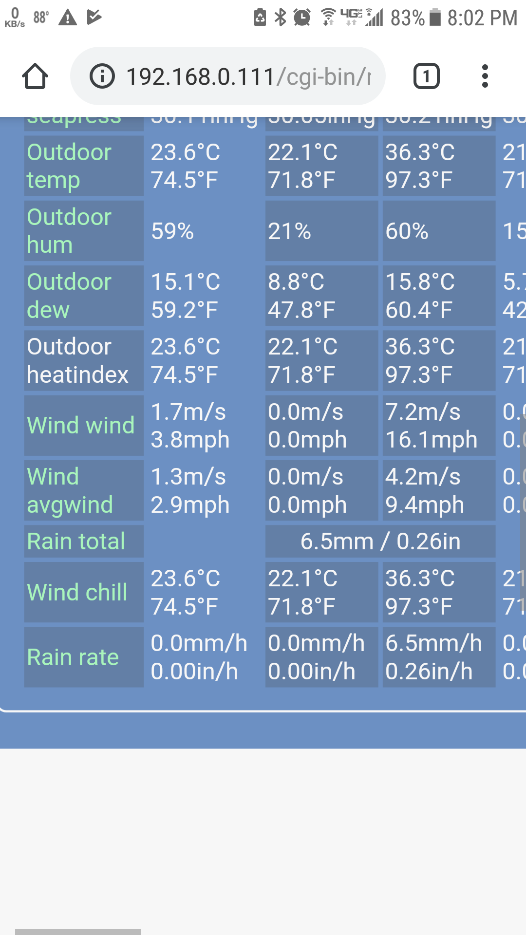

First screeshot what MB shows in live data and sent to WU.. 0.26" of rain (WU rounds to 0.30")

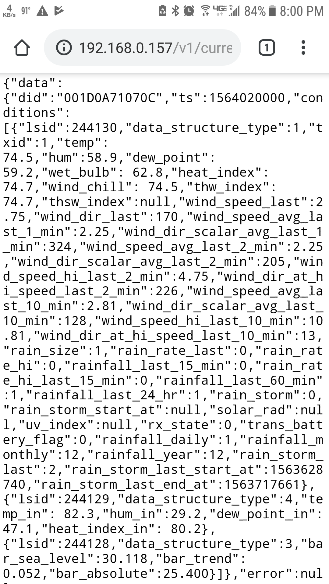

2nd image, what WLL reports to query.. 1 tick or 0.01" of rain

In addition, one or two messages back, I posted http query results from the WLL alongside MB live data. The live data shows about 25 times more rain than the http query.
The http query values are correct and agree with the NOAA station that is a couple of miles away.

The station is setup in MB as a 0.01" per tick, the http query shows "rain_size" as 1 (if a tick was 0.2mm, rain_size is returned as 2)
The shot of live data from MB a few messages back shows MB showing 6.5mm/0.26 inches from 1 tick
