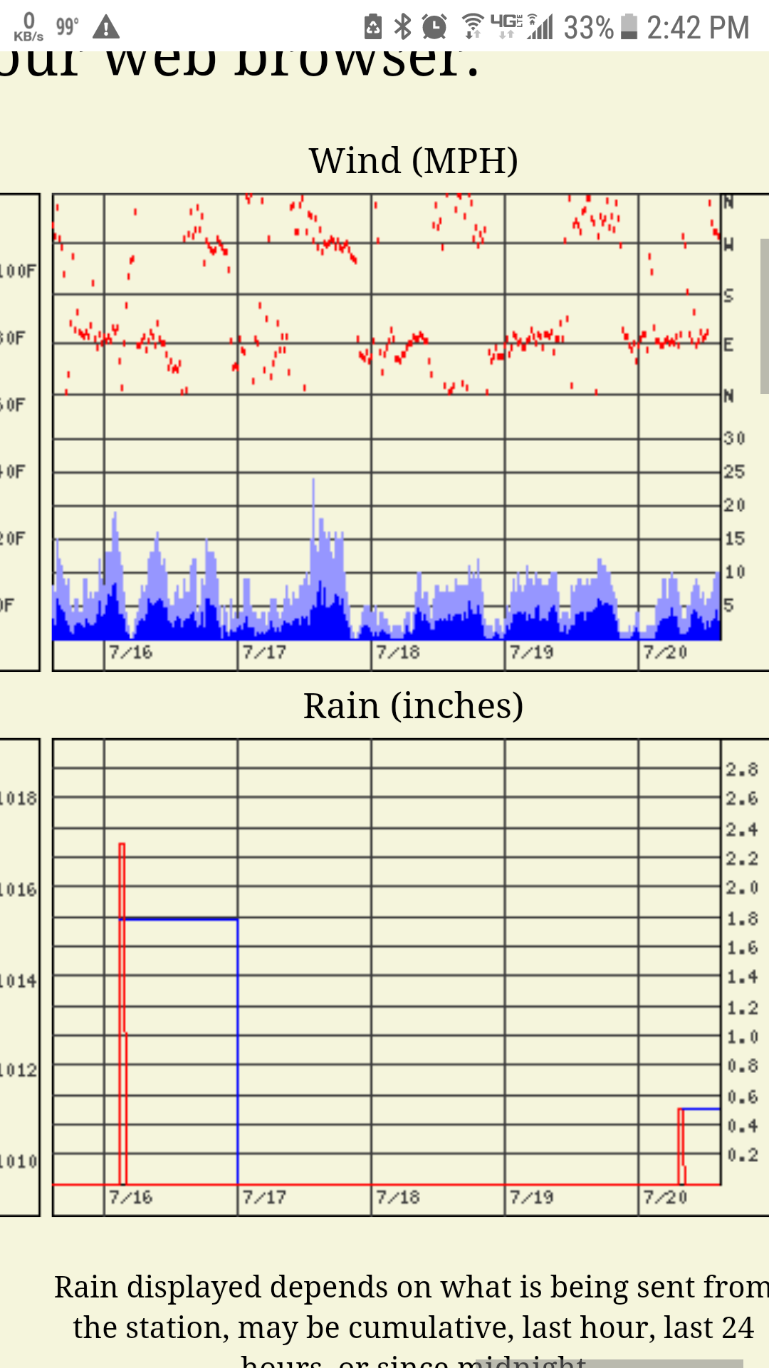

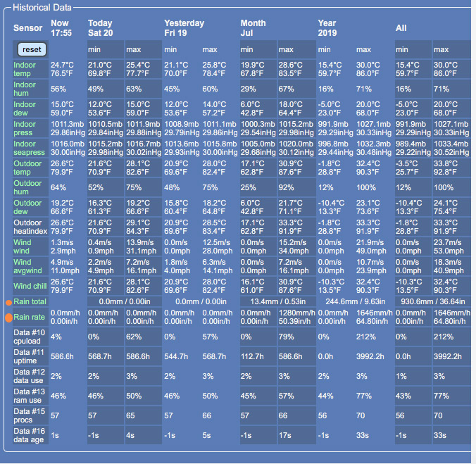

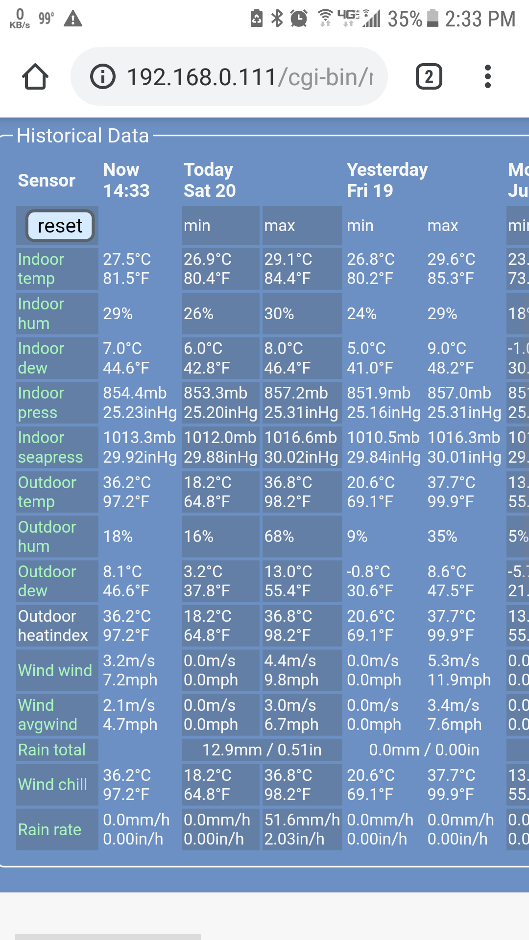

Here is the live data page from today:
- As you can see.. A whole lot more rain today according to MB than really occurred
- Screenshot_20190720-143332.png (466.6 KiB) Viewed 5895 times
Don

Here is another shot showing what MB reported to CWOP
- Screenshot_20190720-144210.png (253.46 KiB) Viewed 5895 times
Don
