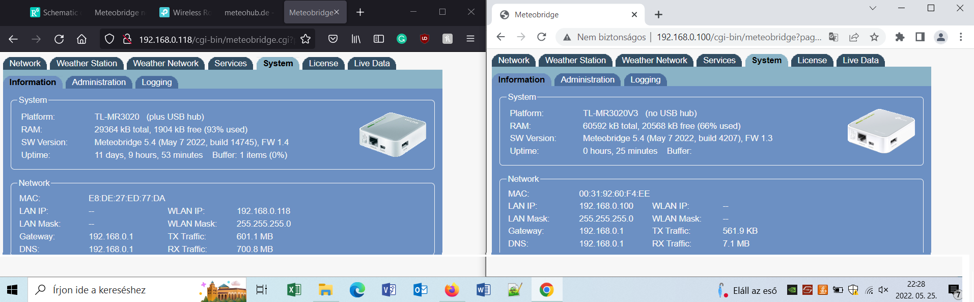

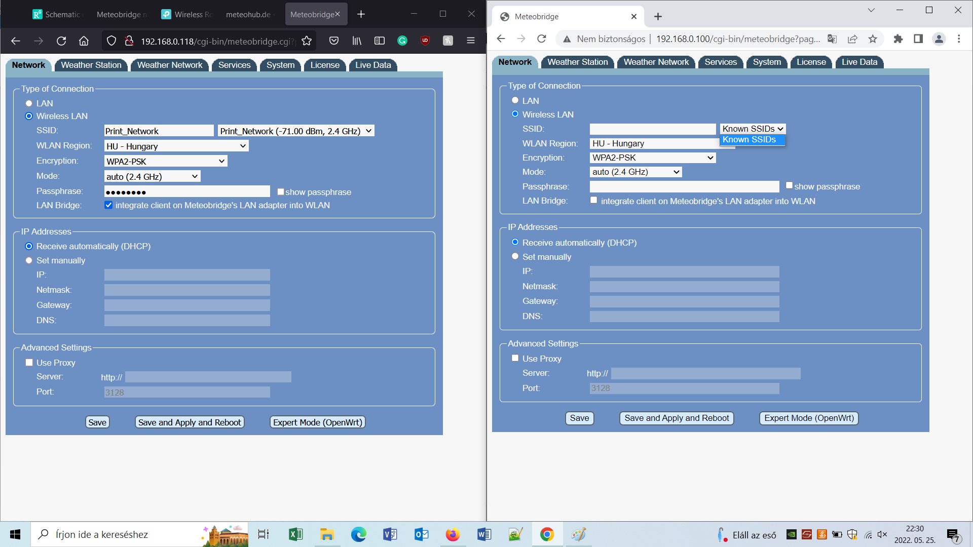

Hello everyone,
I have successfully flashed the Meteobridge firmware to my WR902AC V3.0 but for some reason no matter what I try it does not see my 2.4 GHz WIFI network even after I reloaded the "Network" page.
The same thing had happened back then with my MR 3020 V3.2 too. The only common thing between them is that none of them has a paid license only the trial one. Every setting is correct as I have an MR3020 V1 also and that one can see my WIFI and connect to it.
It would be hard to believe that I was so unlucky that I bought two unusable devices. Do I have to have paid license to get access to the WIFI capability?
Thank you in advance for the help!
Gábor

My main and only router is a TP-Link Archer C1200 with almost every stock setting except for the WIFI's name and password with neither any mesh network nor speed enhancement and access control is disabled. The router gets access to the Internet by the Internet provider's MODEM.
And the most interesting part of it is my older MR3020 is capable of connecting but my newer one can't just like my WR902AC. Sometimes they see it, sometimes they don't but when they do, they still can't make it.
In this example, I use both of my MR3020. The newer one is using my WR902AC, which I flashed back to stock, as a client to have "wireless" access and I didn't touch the "Expert mode".
Thank you for your help.
Gábor

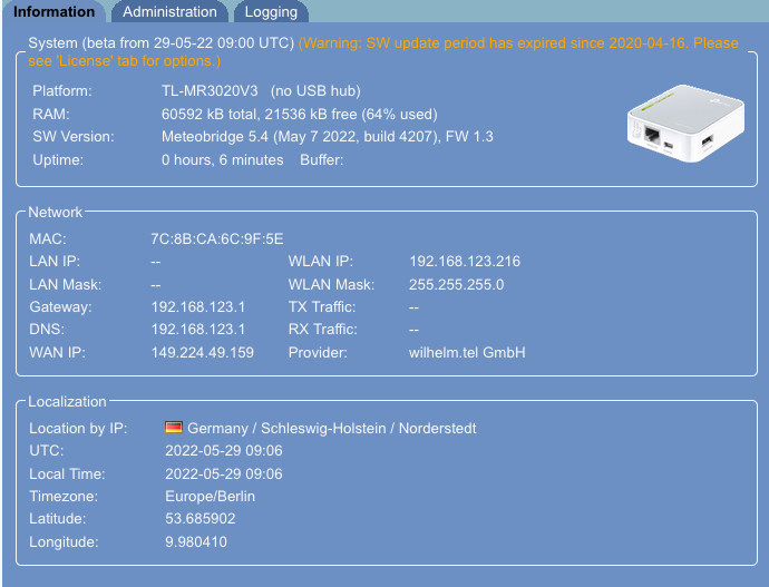

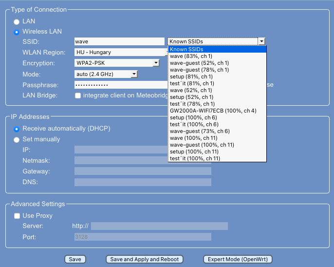

Re: Meteobridge now available for TP-Link WR902AC Version 3.x
When I flash my mr3020v3 with the Meteobridge image made for it, then I can see and connect to my WLAN. No idea why it does not work for you.
Bildschirmfoto 2022-05-29 um 11.06.53.png (102.45 KiB) Viewed 15598 times
Bildschirmfoto 2022-05-29 um 11.08.32.png (81.16 KiB) Viewed 15597 times
