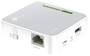

I invested some spare time to port the Meteobridge package to the TP-Link router WR902AC Version 3.x. While version 1.x of this router was already supported, the version 3.x is powered with a different SOC and it needed a complete new firmware build. Like the MR3020 Version 3.x this model does not need a USB hub when being connected to weather stations via USB and it has 64 MB of RAM which gives it the same headroom as the MR3020 Version 3.x. The 5 GHz WLAN mode of the router is not supported, it is running on LAN or 2.4 GHz WLAN only.
To have this router supported is extremely interesting for US customers, as TP-Link is no more selling the other Meteobridge supported models anymore in the US!

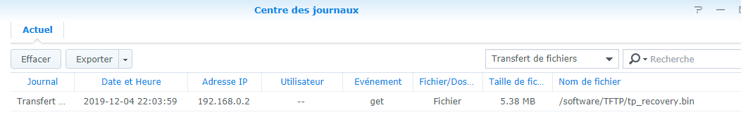

I bought this model : TL-WR902AC(EU) ver 3.0,
and tried to put the meteobrige system on it. I've successfully prepare a TFTP server and I can see in the log that the bin has be downloaded by the TP-Link device (see attachement).
Unfortunatly, after that, I connect the device on my regular router and I suspect that the system is not bootin. In facts, I have all green light (on the cover) flashing together, slowly... And no device connected to my router with the TP-Link Mac Address.
I followed the instruction :https://www.meteobridge.com/wiki/index. ... g_Hardware and used this firmware
http://connect.meteobridge.com/files/me ... 3-v1.3.bin
Any advice and help appreciated. Thanks
