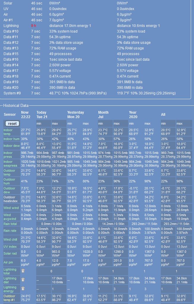

Rebooted the Meteobridge to SW Version: Meteobridge 4.3 (Jun 14 2020, build 13564), FW 1.3
Live data tab shows last measurement + last time in red color
Template file: https://pwsdashboard.com/extra_mb.txt
All lightning lines return -- in the uploaded file https://pwsdashboard.com/extra.txt
But I wonder why last time is in red as it should always be transmitted by the GW1000.
A value of zero is needed to signal that there is no lightning detected.
Just wait for new lightning events to show more data.
Lightning 16 min distance 17.0km energy 0 distance 10.6mls energy 0Code: Select all

|lightningnearest|light|--|!A value of zero is needed to signal that there is no lightning detected.

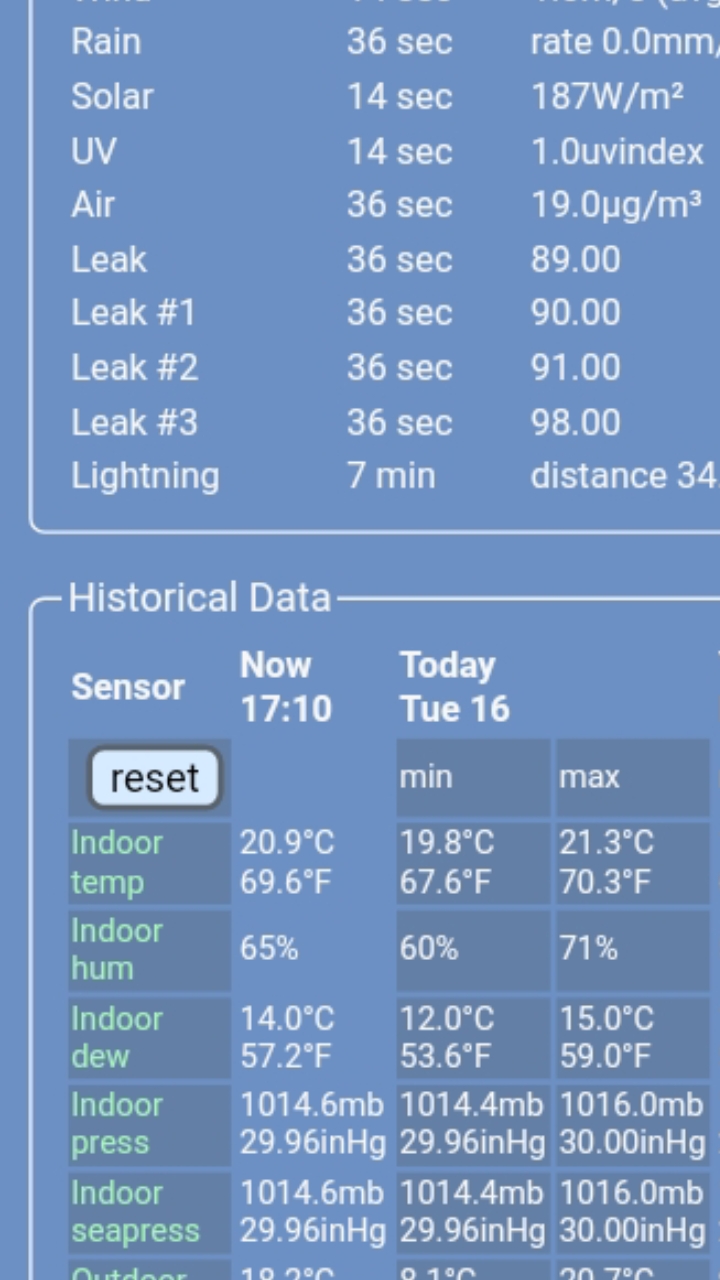

Just had first lightning event since updating but no lightning has appeared on Ambientweather.
The lightning did register on the Meteobridge.
Lightning 7 min distance 34.0km energy 1
distance 21.1mls energy 1
- Screenshot_20200616-171715_Gallery.jpg (282 KiB) Viewed 6861 times

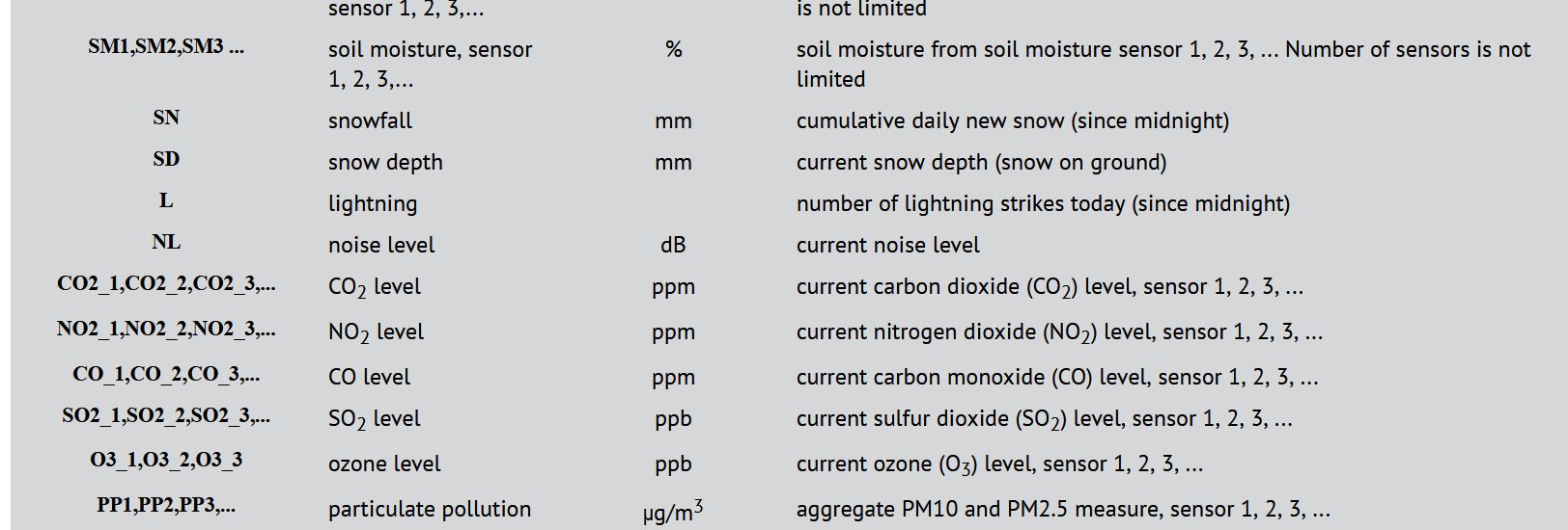

Meteobridge-GW1000 no lightning data sent from MB to Meteotemplate
@michaeljwestii
I'm facing the same (plus another) issue in the meteotemplate fed by MB.
The Meteotemplate-API provides for 4 Soil-Moisture (default), 1 Lightning and 4 particulate matter (PM2.5 or PM10) sensor values.
I have 5 Soil-Moisture, 2 PM2.5 and 1 lightning sensors - all shown in the live data in MB and in the database (Pro) What arrives at the meteotemplate is:
4 Soil-Moisture (as per Meteotemplate API description the number of sensors is not limited here, but MB sent only 4)
1 PM2.5 (should be 2 and 4 could be sent in the standard/default database definition; MB just sends one)
0 Lightning (where meteotemplate expects the strikes per day; MB sends nothing, no value with the header L: to be found).
=> Meteobridge doesn't send the 2nd PM2.5 and the one and only lightning sensor value(s).
The missing sensors should be included at the MB side.
Some more work for Boris to do !

Re: Meteobridge-GW1000 no lightning data recognized by MB
Actually, no.Gyvate wrote: Tue Aug 04, 2020 10:43 am I'm extracting the database on an hourly basis, meanwhile also including the lightning values -
Is this what you were looking for ?
