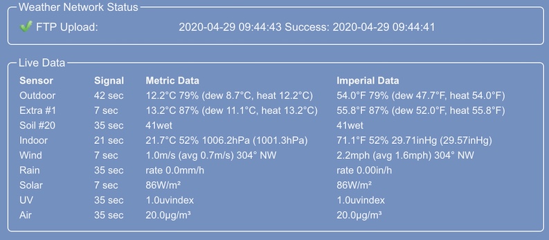

The live data tab does not show the lightning sensor => attached screenshot

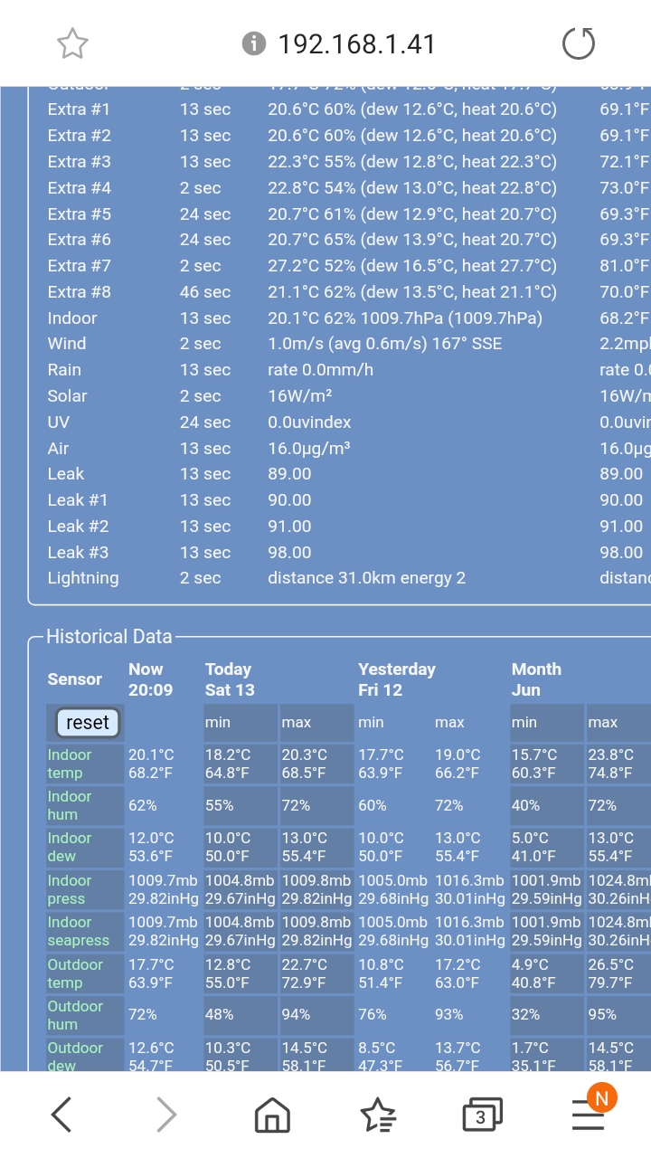

Today was the first day with lightning in the area since I got the lightning detector. The meteobridge registered the lightning but nothing sent to Ambient. At least I know the meteobridge is reading lightning data from the GW1000. The lightning sensor only appeared in the meteobridge live data when there was lightning.

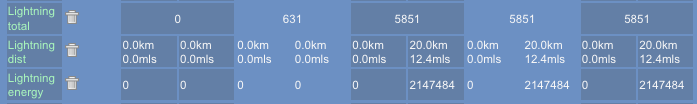

This is how you get the logged lightning data. Assume we have this status on "Live Data" tab. Lightning total and energy are cumul sensors (like rain total), which report sums.
Bildschirmfoto 2020-06-14 um 10.29.50.png (24.73 KiB) Viewed 6407 times
yesterdays total: [lgt0total-ydaysum:--]
this months total: [lgt0total-monthsum:--]
date/time of last strike: [lgt0total-nonzerotime:--]
min distance of today: [lgt0dist-dmin:--]
Distance looks odd to me, as it should do "--" when no strike in the selected time frame. Another thing to look at...
